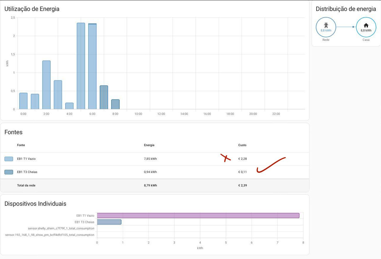

Nice card. Just to share how some HA folks are approaching this
Besides KW consumption there’s also cost calculation.

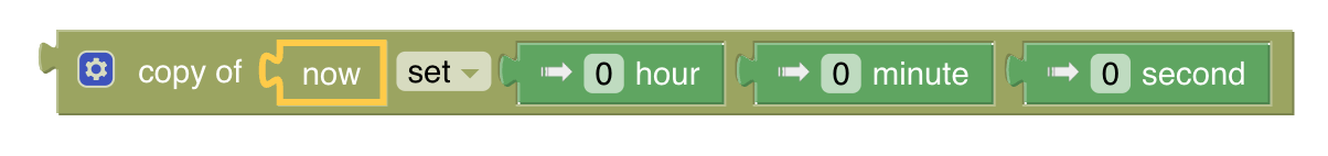

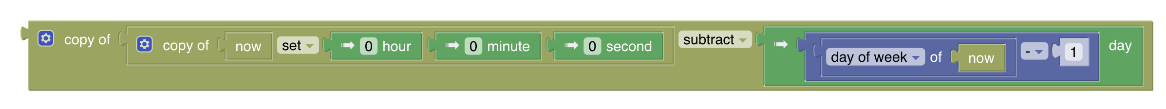

midnight today:
The temporal stuff is a little tricky. See https://www.youtube.com/watch?v=KwhYKy1_qVk&t=375s.
The now.minus days of the week is a little tricky in that you’ll have to make two “copies”.
Day of month and day or year follow the same pattern. Just change the property in that block as appropriate.

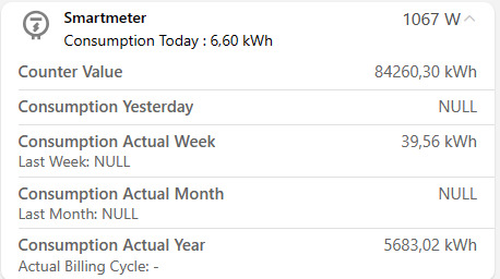

I updated the marketplace templates and both Edit script pages show the Blockly block. I have a small glitch, though. Some of the Items show “NULL” (see the screencopy) and this has been the case since I installed the widget.
I checked that e.g. the Item for Consumption Actual Month is “NULL”.
This is really nice widget and I’m going to adapt it to my other purposes.
Please note that the weekly/monthly/yearly Items get updated only at the first of a week/month/year, so you won’t see any values until then.
Your missing billing cycle value looks like a bug/issue. Anything in the logs? Did you set the DateTime Item correct?
This is a really simple but informative widget, I have modified it for my gas- and watermeter to have them shown with the same look and feel…
OK, thanks. I understand that to get the monthly/yearly values I need to wait until next month/year but Yesterday’s value is also null.
My Item for billing cycle start is 2023-01-01T00:00:00.000+0200. So I wonder whether this is wrong.
Do you have a meter value from that day and time ? If not, no delta can be calculated…
Yes, I have a energy meter reading for that date/time. There are no error/warning messages in the log. I think I need to look at your code and see how the billing cycle is handled.
I just checked, mine is showing 0kWh for the billing cycle since the update, so there indeed is a bug.
I will check later today.
