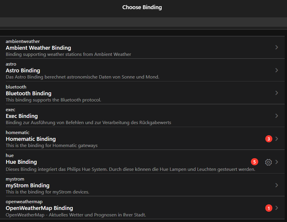

To add the bridge via gui is not possible, because there is no opencean-binding available, it looks like this when I click to add:
screenshot-add-thing
