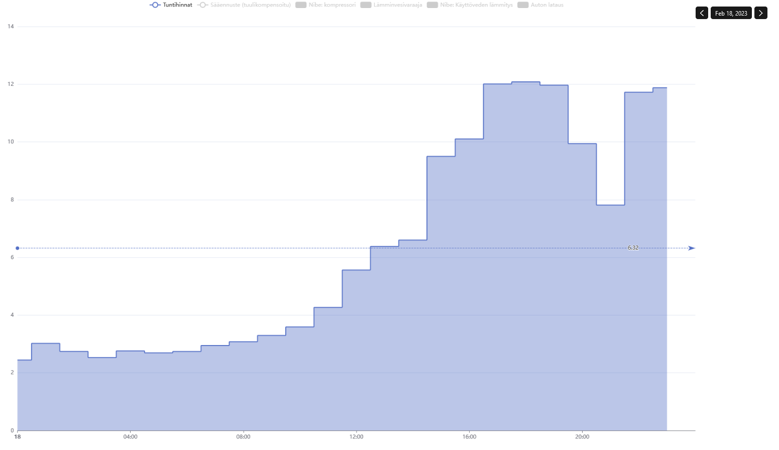

I was originally considering having 24 separate items for storing the day ahead prices, but…
… then I was not able to figure out how I would be able to plot them as a chart.
User story: As an end user I want to do a visual comparison (chart) of today’s spot prices and tomorrow’s spot prices so that I can plan our energy consumption.
So something like this, where the user can navigate between the days with the date navigation:
Is my thinking too stuck in normal time series way of thinking? Do you have any hints to which way to think?

Possibly so. The point is that the very moment when you retrieve the new day ahead prices the data is persisted with current date as the x value, but the meaning of the data is +1 day so it should be (x+24hrs) really but you can’t do that as you cannot force to use a specific x it’s always “now”.
If the intention “only” is to display the price for the day that you select in charts I think you have to apply a trick something like this:
Use a second item and a rule to set it to your original item’s value as that was 24 ago
Pseudo code: DayAheadPriceItem.HistoricItem(now.minusDays(1)).
Run the rule every minute via cron or so.

@mstormi I’m mostly following what you’re saying but my brain still tilts.
The thing is that the result set what I receive from the API is not now + 24h.
  • If I call the API (and get successful response) at Feb 18 at 14.00 CET, I will get a time series response with 24 points with a time range from Feb 19 00:00 CET until Feb 19 at 23:00 CET
  • If I call the API (and get successful response) 1 hour later, I still get a time series response with 24 points with a time range from Feb 19 00:00 CET until Feb 19 at 23:00 CET.
So the offset is not “now + 24h” or “now + 1d”.
