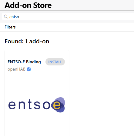

Now that the binding is part of the official distribution in OH 4.3, should the marketplace version be unpublished or made available only untill OH version 4.2.x?
That should already be the case?
You mean the second version in title is excluded?
So “EntsoE Binding [4.0.0.0;4.3.0.0)” will not be available for OH version 4.3?
Exactly, and it seems to work as expected - from my 4.3 installation:
Correct.
