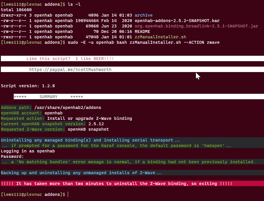

I got a homeseer floodlight, newer model. It was added to the zwave binding a few days ago:
Database update (#1506) · openhab/org.openhab.binding.zwave@b41be79 · GitHub
Am running following script to update openhab zwave binding to latest snapshot:
I followed the instruction to download the script, updated permissions to executable, updated user and group to be same as openhab uses to run. I get error:
!!! It has taken more than two minutes to uninstall the Z-Wave binding, so exiting !!!
Following screenshot showing list of files in addons folder and error from running script:
