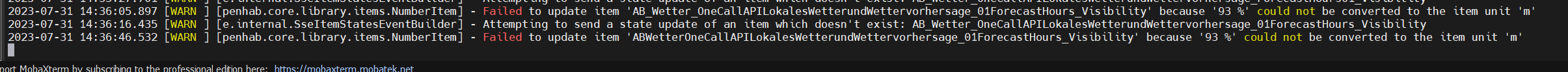

after upgrading to OH4 i have Unit conversion errors in the logfile
2023-07-29 10:17:33.293 [WARN ] [penhab.core.library.items.NumberItem] - Failed to update item 'ABWetterOneCallAPILokalesWetterundWettervorhersage_ForecastHours01_Visibility' because '80 %' could not be converted to the item unit 'm'
2023-07-29 10:17:33.347 [WARN ] [penhab.core.library.items.NumberItem] - Failed to update item 'ABWetterOneCallAPILokalesWetterundWettervorhersage_ForecastHours02_Visibility' because '74 %' could not be converted to the item unit 'm'
2023-07-29 10:17:33.428 [WARN ] [penhab.core.library.items.NumberItem] - Failed to update item 'ABWetterOneCallAPILokalesWetterundWettervorhersage_ForecastHours03_Visibility' because '72 %' could not be converted to the item unit 'm'
2023-07-29 10:17:33.539 [WARN ] [penhab.core.library.items.NumberItem] - Failed to update item 'ABWetterOneCallAPILokalesWetterundWettervorhersage_ForecastHours04_Visibility' because '97 %' could not be converted to the item unit 'm'
2023-07-29 10:17:33.624 [WARN ] [penhab.core.library.items.NumberItem] - Failed to update item 'ABWetterOneCallAPILokalesWetterundWettervorhersage_ForecastHours05_Visibility' because '100 %' could not be converted to the item unit 'm'
2023-07-29 10:17:33.728 [WARN ] [penhab.core.library.items.NumberItem] - Failed to update item 'ABWetterOneCallAPILokalesWetterundWettervorhersage_ForecastHours06_Visibility' because '100 %' could not be converted to the item unit 'm'
2023-07-29 10:17:33.884 [WARN ] [penhab.core.library.items.NumberItem] - Failed to update item 'ABWetterOneCallAPILokalesWetterundWettervorhersage_ForecastHours07_Visibility' because '100 %' could not be converted to the item unit 'm'
2023-07-29 10:17:33.933 [WARN ] [penhab.core.library.items.NumberItem] - Failed to update item 'ABWetterOneCallAPILokalesWetterundWettervorhersage_ForecastHours08_Visibility' because '100 %' could not be converted to the item unit 'm'
2023-07-29 10:17:33.992 [WARN ] [penhab.core.library.items.NumberItem] - Failed to update item 'ABWetterOneCallAPILokalesWetterundWettervorhersage_ForecastHours09_Visibility' because '100 %' could not be converted to the item unit 'm'
2023-07-29 10:17:34.083 [WARN ] [penhab.core.library.items.NumberItem] - Failed to update item 'ABWetterOneCallAPILokalesWetterundWettervorhersage_ForecastHours10_Visibility' because '100 %' could not be converted to the item unit 'm'
2023-07-29 10:17:34.154 [WARN ] [penhab.core.library.items.NumberItem] - Failed to update item 'ABWetterOneCallAPILokalesWetterundWettervorhersage_ForecastHours11_Visibility' because '100 %' could not be converted to the item unit 'm'
2023-07-29 10:17:34.242 [WARN ] [penhab.core.library.items.NumberItem] - Failed to update item 'ABWetterOneCallAPILokalesWetterundWettervorhersage_ForecastHours12_Visibility' because '89 %' could not be converted to the item unit 'm'
2023-07-29 10:17:36.553 [WARN ] [penhab.core.library.items.NumberItem] - Failed to update item 'ABWetterOneCallAPILokalesWetterundWettervorhersage_ForecastHours01_Visibility' because '80 %' could not be converted to the item unit 'm'
2023-07-29 10:17:36.623 [WARN ] [penhab.core.library.items.NumberItem] - Failed to update item 'ABWetterOneCallAPILokalesWetterundWettervorhersage_ForecastHours02_Visibility' because '74 %' could not be converted to the item unit 'm'
2023-07-29 10:17:36.680 [WARN ] [penhab.core.library.items.NumberItem] - Failed to update item 'ABWetterOneCallAPILokalesWetterundWettervorhersage_ForecastHours03_Visibility' because '72 %' could not be converted to the item unit 'm'
2023-07-29 10:17:36.735 [WARN ] [penhab.core.library.items.NumberItem] - Failed to update item 'ABWetterOneCallAPILokalesWetterundWettervorhersage_ForecastHours04_Visibility' because '97 %' could not be converted to the item unit 'm'
2023-07-29 10:17:36.786 [WARN ] [penhab.core.library.items.NumberItem] - Failed to update item 'ABWetterOneCallAPILokalesWetterundWettervorhersage_ForecastHours05_Visibility' because '100 %' could not be converted to the item unit 'm'
2023-07-29 10:17:36.867 [WARN ] [penhab.core.library.items.NumberItem] - Failed to update item 'ABWetterOneCallAPILokalesWetterundWettervorhersage_ForecastHours06_Visibility' because '100 %' could not be converted to the item unit 'm'
2023-07-29 10:17:36.938 [WARN ] [penhab.core.library.items.NumberItem] - Failed to update item 'ABWetterOneCallAPILokalesWetterundWettervorhersage_ForecastHours07_Visibility' because '100 %' could not be converted to the item unit 'm'
2023-07-29 10:17:37.016 [WARN ] [penhab.core.library.items.NumberItem] - Failed to update item 'ABWetterOneCallAPILokalesWetterundWettervorhersage_ForecastHours08_Visibility' because '100 %' could not be converted to the item unit 'm'
2023-07-29 10:17:37.063 [WARN ] [penhab.core.library.items.NumberItem] - Failed to update item 'ABWetterOneCallAPILokalesWetterundWettervorhersage_ForecastHours09_Visibility' because '100 %' could not be converted to the item unit 'm'
2023-07-29 10:17:37.119 [WARN ] [penhab.core.library.items.NumberItem] - Failed to update item 'ABWetterOneCallAPILokalesWetterundWettervorhersage_ForecastHours10_Visibility' because '100 %' could not be converted to the item unit 'm'
2023-07-29 10:17:37.195 [WARN ] [penhab.core.library.items.NumberItem] - Failed to update item 'ABWetterOneCallAPILokalesWetterundWettervorhersage_ForecastHours11_Visibility' because '100 %' could not be converted to the item unit 'm'
2023-07-29 10:17:37.266 [WARN ] [penhab.core.library.items.NumberItem] - Failed to update item 'ABWetterOneCallAPILokalesWetterundWettervorhersage_ForecastHours12_Visibility' because '89 %' could not be converted to the item unit 'm'
I checked the channel and the item. both are set to length. Where does the “%” come from?

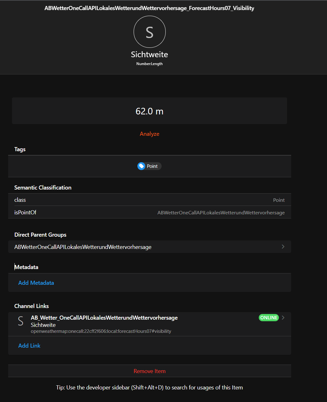

Have you set unit metadata on these Items?
And also, what’s updating this item - a state in some binding, MQTT, REST? If you could add a little more context, I think that could be useful. Please also include item definition.

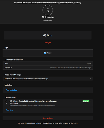

There is no unit in metadata defined:

Well, have you tried defining it? All Number:X type Items must have unit metadata defined or else the system default is assumed. The default for Number:Length in SI units is m.

But this does not explain why “Current Visibility” is working with the same configuration. There is no unit configured also…
This makes no sense that one thing/item works and the others do not :confused:
Youre absolutely right about screenshots and logs. Will do it better!
All I know is that in OH 4, if you don’t supply unit metadata, the system default is used. So the first thing you should do when experiencing problems is define unit metadata.
The fact that is works with one Item and not another means there is something different. Without being able to tell what is different, you may as well start setting up the not-working Item the way it’s supposed to be set up, which means defining unit metadata. If that fixes it, great! If not, at least we’ve eliminated a whole class of potential problems.
But i think in this case “meter” is the right one. So the item type is correct with number.length.
If something is sending “%” to the item and i define the unit “m”, will OH convert the value to “m”?
eg: 14 % → 14 m
No because there is no conversion from % to meters. That’s mathematically nonsensical so OH will generate an error. It would convert 50 cm to 0.5 m or even 3.28 ft to 1 m, but 14 % isn’t a length so there’s no conversion possible.

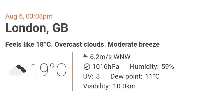

On the website visibility is length unit so I think percent is wrong.
This shows that the current visibility is number:length. At least what I could see in the forecasts, it didn’t provide visibility, so I’m not sure we know what they are providing for the forecast. It is not sensible to use different units, but at this point I can’t tell if it is the API or the binding. I’m not really using the forecast visibility, so I’m going to unlink it until this is resolved to get the warnings out of my log.

Visibility is how far you can see due to haze, so a 10000 m reading is perfectly reasonable.
