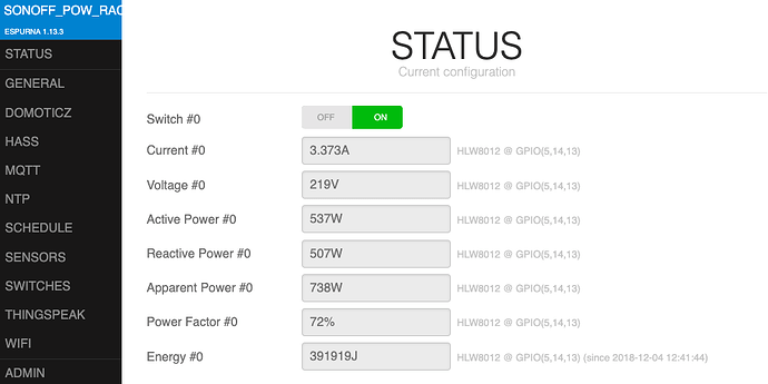

This is a screen of the data given by the SONOFF POW for example.
I would like to read all datas to store and have some graphs of power consumption, and also the ability to send a command to the switch to power ON or OFF the things connected to it.

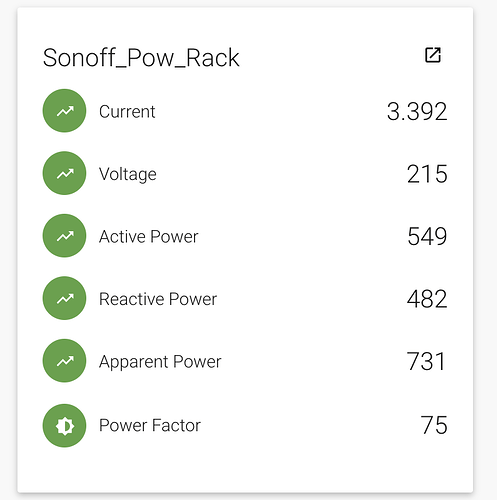

Attached a few sreen shots of pages in ESPRUNA

I am actually receiving data from a SONOFF POW. It tells me VOLTAGE, CURRENT, Power, Reactive Power and Apparent Power of things connected to it, but I cannot find how to add UNIT OF MEASUREMENT to the Items I have linked to the Thing.
They are all GENERIC numbers, but I would like to show for example the symbol “V” near the number expressing voltage, or the symbol “W” near POWER.
Any Idea on how to manage that via the paper UI?
You can’t in PaperUI. PaperUI is for administration so there is no customization possible. To build a UI for your home automation, you need to use sitemaps or HABPanel.

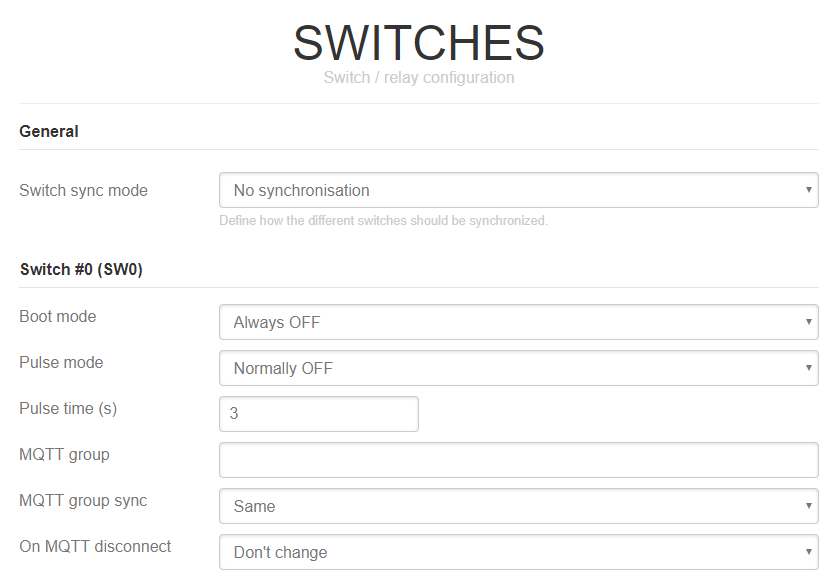

Hi, I’m using the Sonoff RF Bridge with the Sonoff PIR motion sensor and after a few configuration changes, I’ve found out how to use the PIR without a Rule to turn the state to “off”. In the Espurna Siwtches screen, simply change the “Pulse mode” to “Normally OFF” and change the “Pulse time” to whatever time you want the status to be updated. In my case it’s 3 seconds. Now I use Paper UI to capture the mqtt (Thing, Switch) of sonoffbridge01/relay/0 which is 1 for motion detected. Hope that helps.
