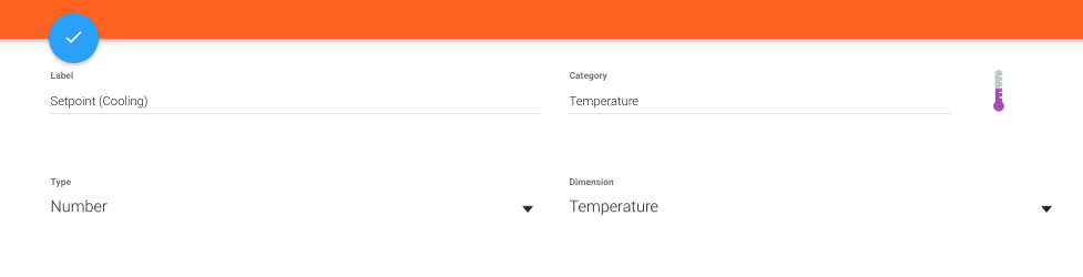

That’s the part that gets me, the thing / item is set as a number. I never changed that during the upgrade… Anything you see here that looks wrong? By the way I am using the development binding updated about a day or two ago.
Ok, then it’s a completely different answer! The development binding should support QuantityType - this isn’t a recent change either and it was added a couple of months back (beginning of May).
I would suggest to delete the thing and add it back again so that it picks up the latest thing definition. It’s possible that your thing definition is the old definition, but with the update to the newer runtime, it’s sending the new type.

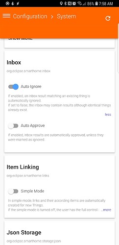

Maybe this explains it?
That was a good idea to check that as I had not but I have those both off. Adding pic to make sure we are talking about the same thing.
I have also tried adding them via PaperUI and Habmin with same results.
Yes - that’s what I was talking about.
I’m not sure then - sorry. If the thing is coming back after it’s deleted, and adding channels etc,then I guess something in the core is not deleting the data. The only other thing I can think of, which is probably not likely, and that is if the json database isn’t being updated. If it was not re-written when the thing is deleted, then they would re-appear when the system is restarted.

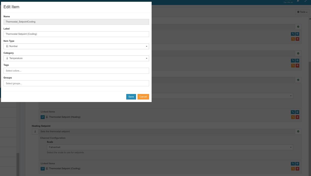

Either way, if anyone thinks of anything, i’m about to try anything. That’s actually the feature I use most in the thermostat :frowning: . Here is how my item is set up…( by default I must add)
Did you create the items in a file or using PaperUI? If in a file, could you please post them?
Please use the latest binding, and check the debug logs during the binding initialisation to see if there are any errors during the thing handler initialisation.
@5iver I created everything with PaperUI.
