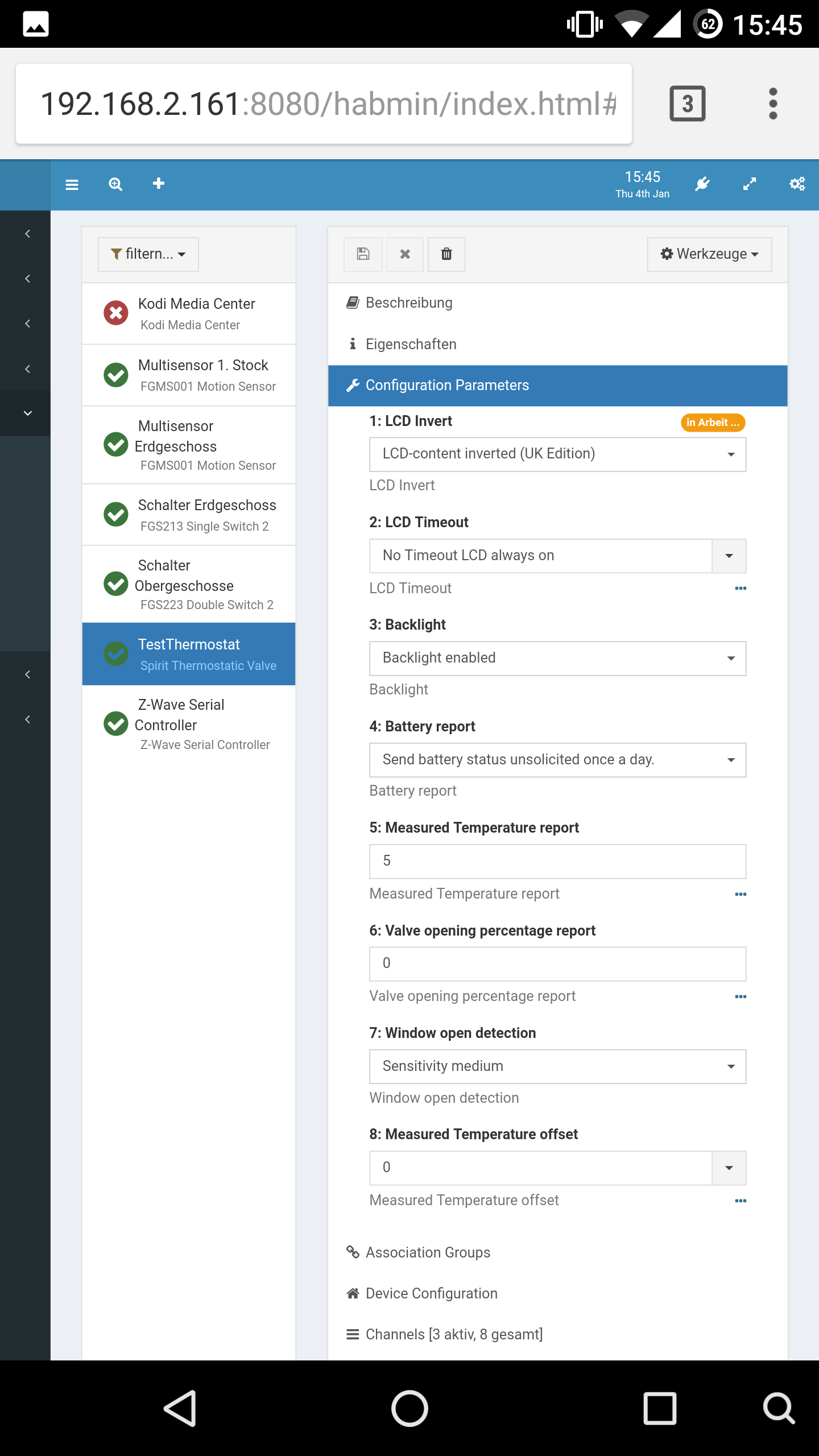

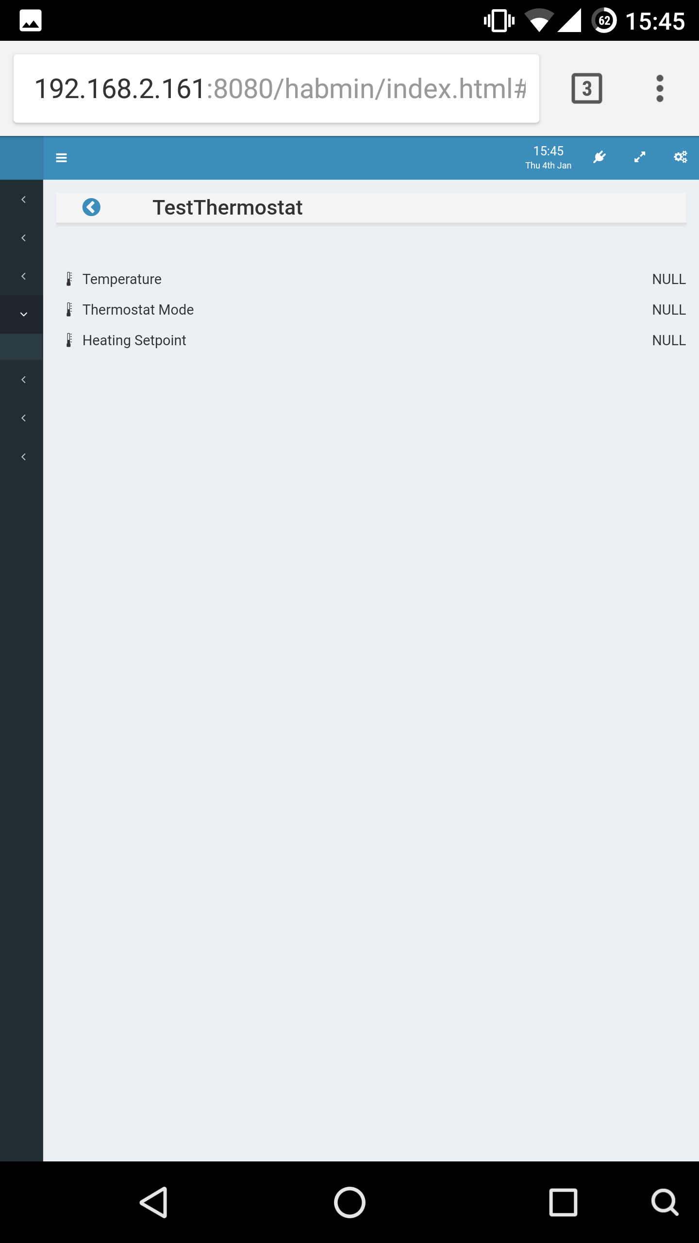

i recently bought a Eurotronic Spirit Z-Wave Plus and am desperately trying to get it to work.
openhab2 and openhab2-addons are from the current snapshot.

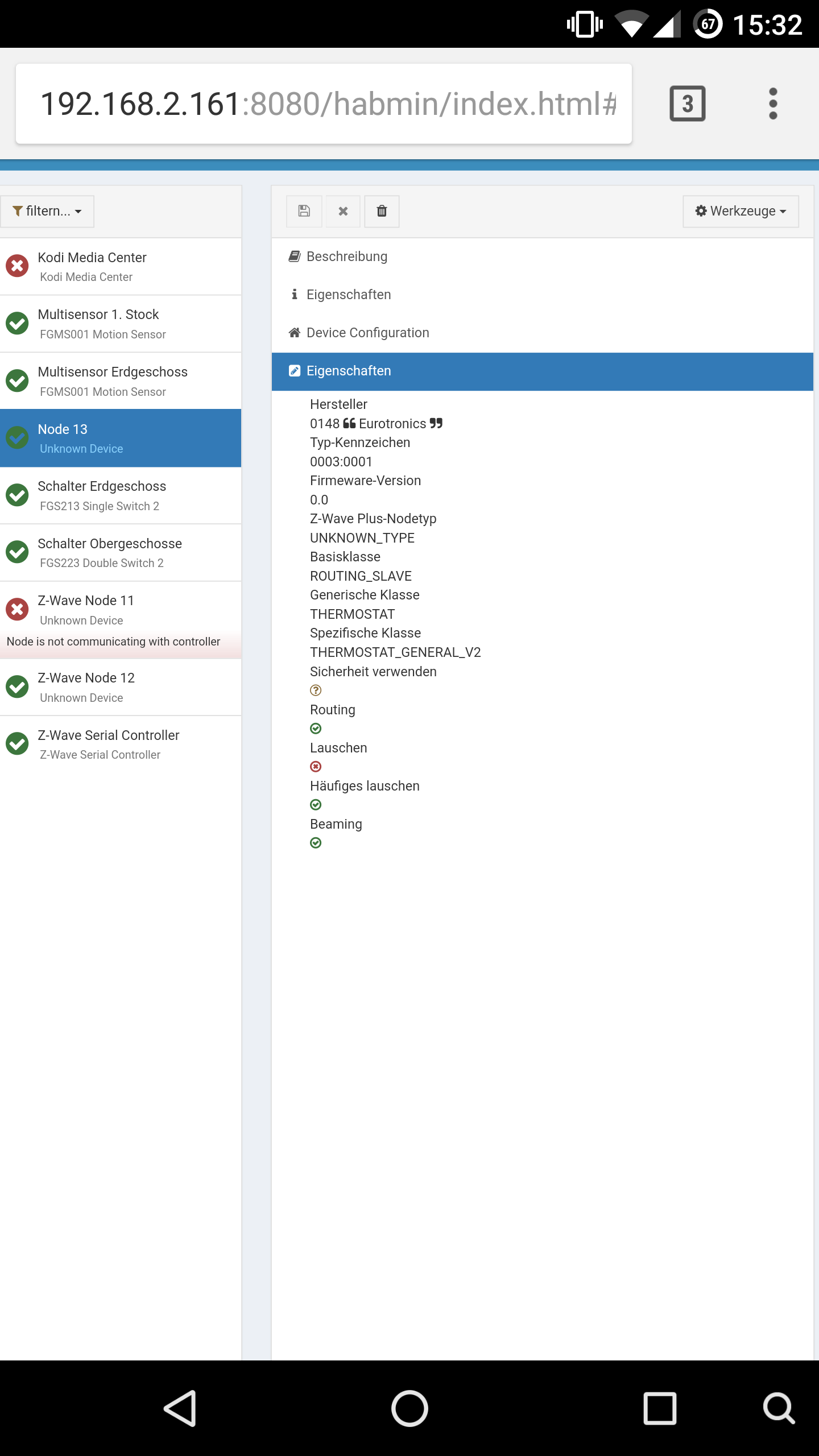

I can include it to the network. The first few minutes, it is displayed as unknown device.
After that, the right template is assigned and i can, theoretically, change the configuration.
Wether the configuration parameters nor setting temperatures is being applied.
The lifeline association is forgotten instantly, so read values from the device dont get to the controller.
What am i doing wrong? Does anyone have a clue or a similar problem?
Since my first Z-Wave products i switched to habmin because it didnât work at all in PaperUI (500 internal server error all the time).
In this case i started with habmin, out of desparation i tried PaperUI afterwards, none of them helped.

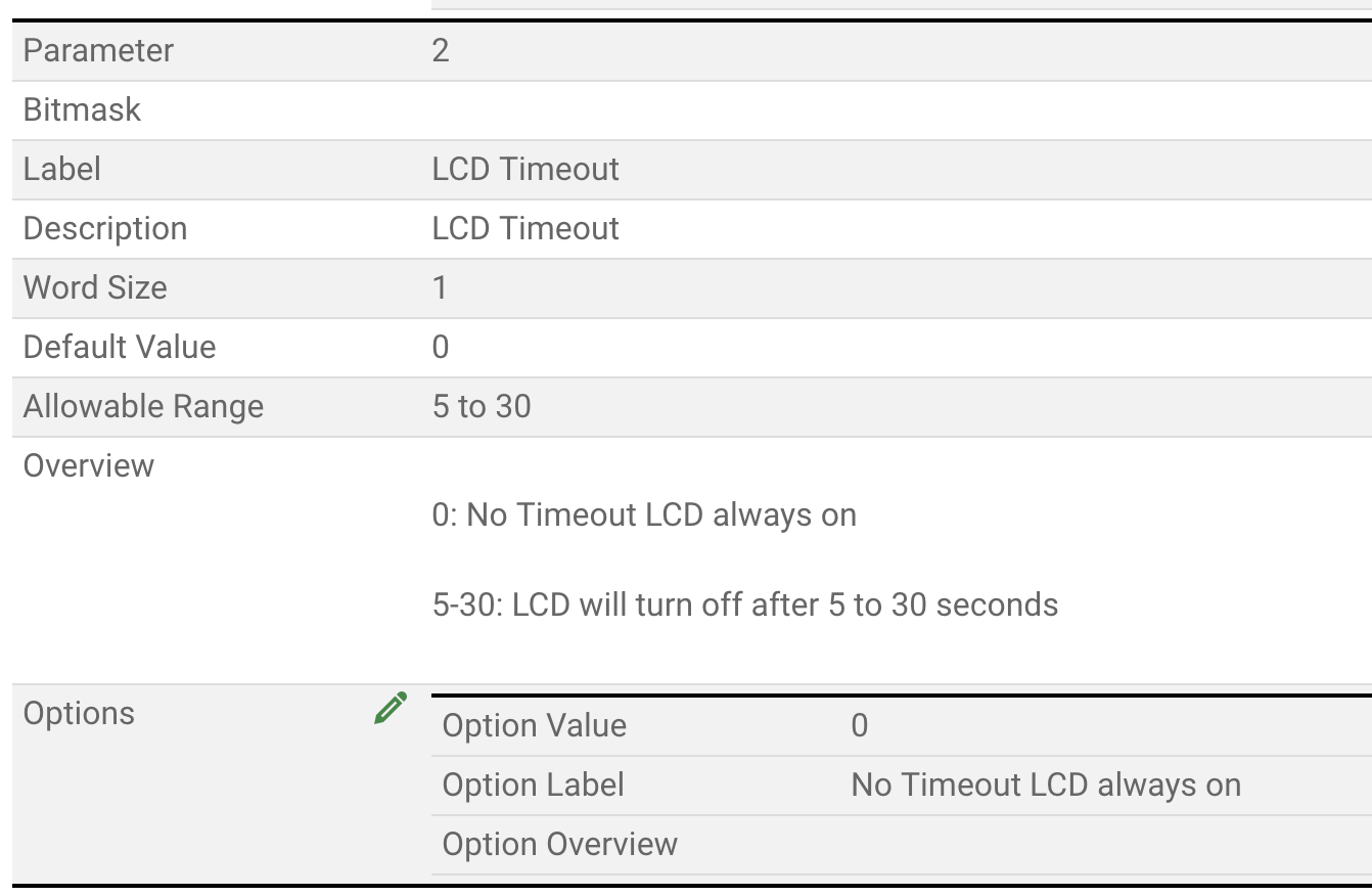

Config parameter #2 for this device in the database looks problematic as the default is outside the allowed range. This might be causing PaperUI to choke.
Can you clarify what youâre trying to do with the temperature. Are you trying to change the scale (i.e. Celsius/Fahrenheit)? If so, thereâs a defect in HABmin that prevents this from working. The only way to change the scale is with PaperUI.
This is a bit of a stretch, but try changing parameter 2 to something in the allowed range (5-30). Maybe this will get you past the error.

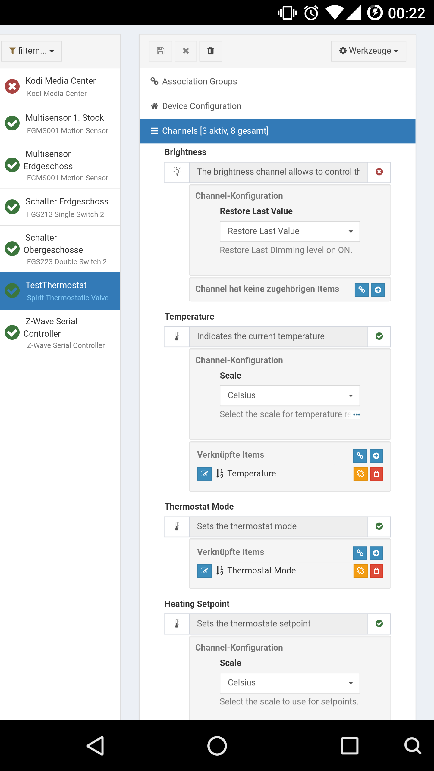

I tried multiple times setting the config parameters, including #2 (to 10 in my case) but the thermostat doesnât accept it.
The UI says, it is the new value, but the LCD on the thermostat is always on.
I didnât try to change the scale, but applying the setpoints or changing the mode, but no reaction of the device.

This is ok - or it should be, but maybe PaperUI doesnât support the âcorrectâ definition. Some time back it was agreed that the options that are defined can be outside the range - so a UI should allow the range (5 to 30 here), plus any options (so also 0).
I would agree with @mhilbush - try a value that is between 5 and 30 - if this works I think we should raise an issue against PaperUI to have it fixed and not make the database wrong to work around this.

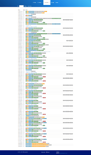

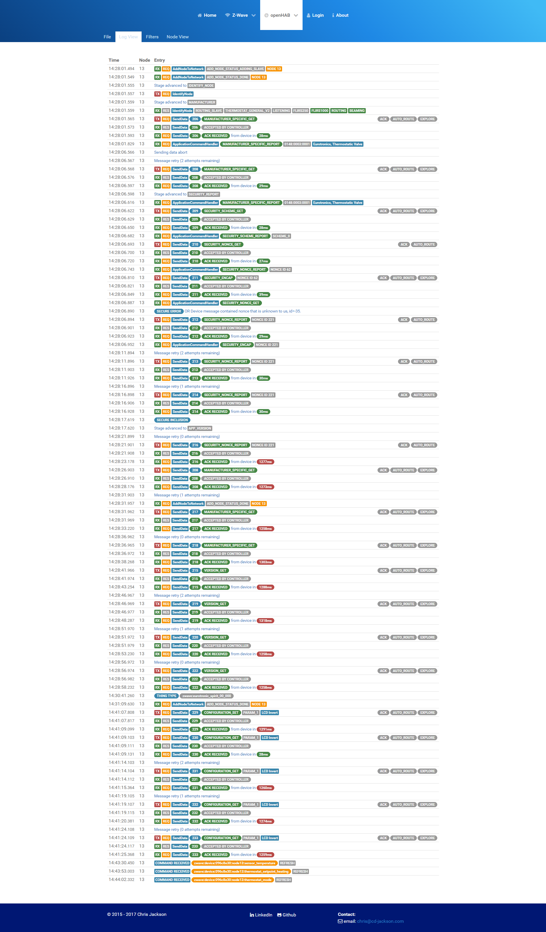

You could put the zwave binding into debug mode, then view the behavior in Chrisâs zwave log viewer. That might provide some insight into whatâs going on.
You might want to exclude the device, then include it again in order to capture the inclusion/initiation process, as well as any config changes youâre trying to make through HABmin.
After including it says Unknown Device. It stays in this state until i rename it. Even after correctly showing SpiritâŠ, values arent read and parameters arent being applied.
