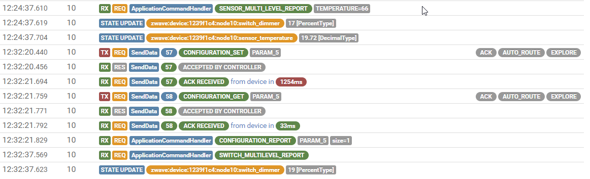

On my device, the default settings for reporting temperature and valve status both were OFF. I both set them to ā€œ1ā€ right from the start, meaning
  • report temperature each time the temperature changes by 0.1°C
  • report valve position each time it changes by 1%
I haven’t tested the effect of reverting these settings to 0.
I would suggest that you try to apply the same settings for parameters 5 and 6 and confirm via debug log that these settings get sent across to the device. I have best experience setting device parameters via the habmin gui. There, you see a ā€œpendingā€¦ā€ indicator as long as the setting has not been applied to the device.
At 12:32:20 I changed the "temperature report " setting from 1 to 2. Below is a screenshot of what I see in the z-wave log viewer. You might want to compare to what you see.

I tried changing the temperature on the Eurotronic Spirit. This seems to wake up the device and the controller will receive the update (most of the time). After this I can change the value via UI for a few minutes an the Device will receive the change. After a few minutes it will not work anymore.
I repeated this several times and always the same behaviour. So I still guess the controller doesn’t know how to contact the device because neigbours are not available. But I can’t prove because the device is a blackbox. Due to the fact that I have no problem with other device I will return them…
