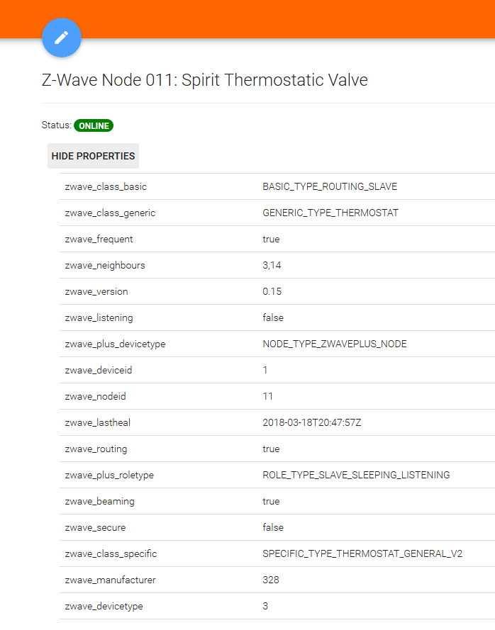

Although I don’t know why, after excluding and including my Spirits, they now route correctly and report neighbours in HABmin. I think I might know where to look in order to understand what was wrong. Namely, the “Show Properties” screen in Paper UI for the Spirit valve has become much more extensive and lists neighbours, routing, beaming and more. I recall that it was much less detailed than it is now:
No idea why this is. Perhaps because I added a new Z-wave mains-powered switch last week? Other than that the only thing I did was re-including the valves. Could a different specification suddenly have become active or something?

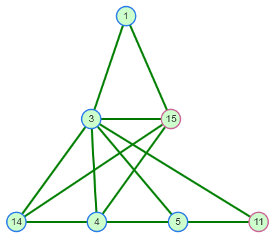

In HABmin’s Z-Wave Network Viewer you see that both my Spirit valves now show neighbours:
(Node 11 and 15 are the Spirit Z-Wave Plus valves.)

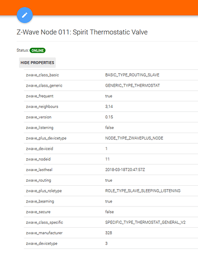

Which is also visible in the Thing configuration under the Attributes section:
Request: Can another Spirit owner perhaps also show their “Properties” page and their “Attributes” section in HABmin if it’s much different from the above? Especially for someone who has the same problems as I had. (chr1s?)
Maybe we can find out what makes these devices not route at first.

So probably the Spirit has a low range. This would not be a problem if it shows proper meshing behaviour and you have an always listening slave close by for routing messages. Can you both check in HABmin if it does that? (That is, check the same sections as in the screenshots I took above. It should show multiple neighbours in the Attributes section and green lines to other nodes in the Z-Wave Network Viewer.)
