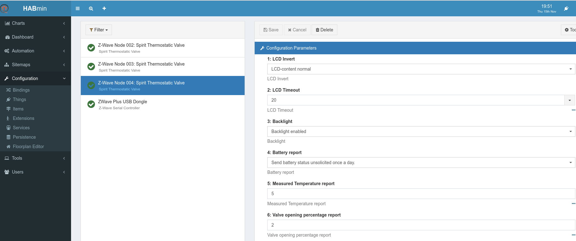

Check your configuration parameter settings: Measured Temperature report and Valve opening percentage report
Habmin
Thanks for tip. I started to get the dimmer readings but the heater is still living on it’s own. It shouldn’t heat while it does. What is more it tend to enable by itself even after OFF is sent.
