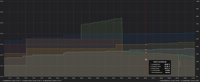

I’ll have to rectify this statement. Yes, by setting target temp to 28°C the valves should open by 100% in most cases. But as the controller is total rubbish, they don’t.
This is the Grafana-Chart from the last hour. If the temperature drops below 20°C (red line), the Spirits are set to 28°C. Actual temperature is around 19°C.

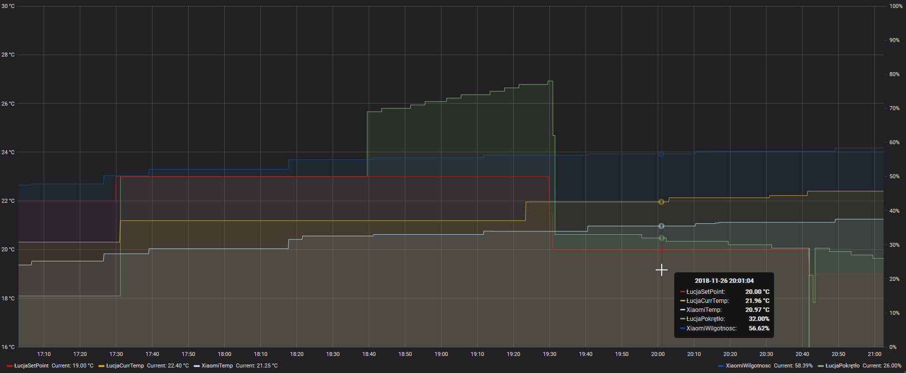

The dimmer stats are green in my case. It seems it’s very slowly dropping down but in the same time temperature in the room is still rising (both Xiaomi Aquara and internal one). Setting the dimmer off doesn’t seem to cause dropping the prediction. What I see also is that the dimmer is turned down like 1% every 3-6 min.
Apart from that look at the difference in the readings. I doubt that those regulators can actually work properly without external temperature.

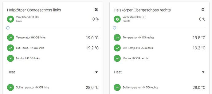

Thanks - that seems like a breakthrough with all the problems we have.
there is a special thread for the problem I have with the devices. But probably people watching this one have some input and the subject is quite generic so it still fits.
What are your experiences about temperature reporting from the device. It just does not work for me when it should be initiated by the device. Only when a command is sent it also reports back new values.
