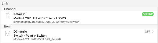

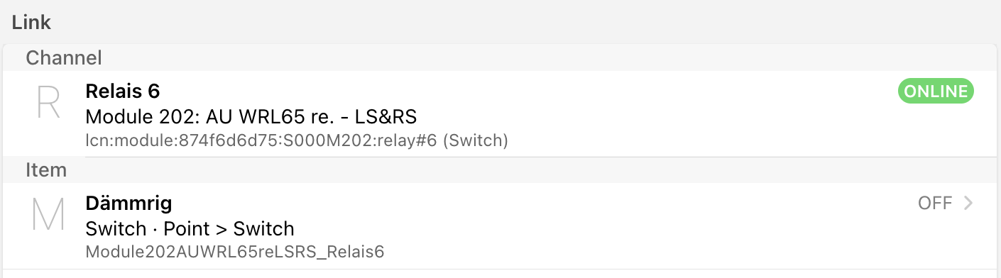

Maybe your item is not a „switch item“
Yep, it is a “proper” switch.
