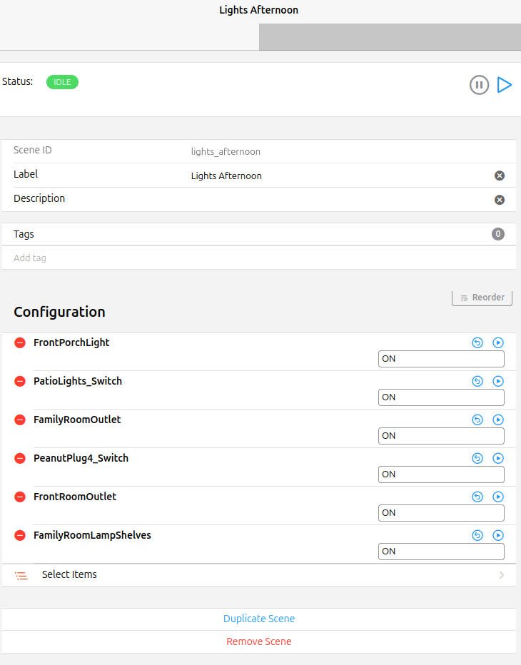

Look at Scenes. You can set the states you want all the switches to be in and call that from a rule or rules. Note that the multithreaded issue does not exist here so it’s possible to have more than one rule call the same scene without risk of collisions.
I’d found that already. The problem was even when it was triggered by an event, the event object didn’t get passed into the secondary script.
I’ll go through that again, but my understanding is scenes are what comes after this particular code- they’d replace what is currently my “toggle” function. This is more for an easy way to manage which scene to call from a scene controller that can do up 35 different scenes. “What scene did the user want?”. Eventually some will be toggles, some will be more complex scenes like “turn off all the lights in the garage, and the dust collector, and the air compressor.”
Rather than having 16 rules, or one nasty complex rule full of if/else, it’s using a lookup table instead of a case statement. By using a dict, I’ll be able to reuse it elsewhere if I want once I turn it into a function- just pass in the dictionary. I just installed the next batch of controllers this weekend so I don’t have them in a group yet, but I believe I’ll be able to put them into a group and then since they all work the same I can handle the entire group with one dict+function.
The Scenes would replace your dict. You’d just call the Scene and all the commands defined in the scene will go out to the Items. The commands can be what ever the Items involved require: ON/OFF, numbers, Strings, etc.
For example:
YAML version:
items:
  FrontPorchLight: ON
  PatioLights_Switch: ON
  FamilyRoomOutlet: ON
  PeanutPlug4_Switch: ON
  FrontRoomOutlet: ON
  FamilyRoomLampShelves: ON
triggers: []
conditions: []
This only shows Switches because that’s all I use in my Scenes right now. But, for example, if I wanted to change the thermostat setpoint as part of the scene I’d add it and use a number.
Thermostat_HeatingSetpoint: 72 °F
A Color Item would take an HSV.
MyColorLight: 200,45,50
Then I just call the scene from another rule.

That’s what Scenes are for. It’s your lookup table. And once they are in the Scenes you don’t need any code to call them beyond calling the rule.
And you can cheat and add triggers and conditions to the Scenes manually on the code tab if you don’t want a separate rule to call them. You just won’t get the nice GUI to build them. The actual YAML code for my Scene above is

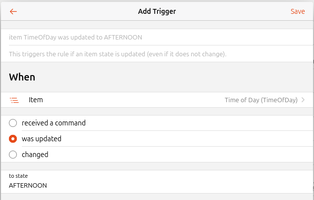

  1. Create one Rule (Settings → Rules) per Scene. Here is where you define the “when button 1 is pressed once” which is the trigger if this rule. Without more details I cannot tell you what that trigger needs to be. The action is a simple “call rule” with the proper scene as the rule to call. This is the most straight forward, but it results in the largest number of rules with at least two per scene.
  2. Instead of creating a separate rule to control when the scene triggers, manually add the triggers to the Scene from the code tab of the scene. To figure out the proper syntax, create a Rule (Settings → Rules), add an example trigger, and then copy the YAML for that trigger from the code tab. Paste/edit it in the code tab for the corresponding Scene. This approach avoids needing 2 rules per Scene, but it requires manually messing with the code of the Scenes. This is the approach I use.
  3. Create one rule (Settings → Rules) which is triggered by all the button press events. Inside the rule, use what triggered it to create the UID of the Scene to call. But for this to work, when you create your Scenes, you need to create them with a UID that can be calculated from what ever triggered the rule. This is very similar to Design Pattern: Associated Items only we are calculating the UID of the Scene instead of the name of an Item.
Creating the scenes is easy and straight forward. But because I don’t know how these button press events come through I can only wave my hands at what the triggers would be. Because these are button presses I would assume they are Channel events and not Items. If that is case I’d need to know what event.event looks like to craft the rule trigger.
Based on your code though it looks like it’s an Item. If that’s the case, option 1 is pretty straight forward. The Rule trigger will be an Item Updated trigger for with Item SceneControllerState and state 1.3 (for example). The action will be a rule action to call the corresponding scene.
It would look like this only this is using my Item names instead of yours. The UI only lets you select existing Items and I don’t want to create a bunch of example Items for these screenshots. You’d select your SceneControllerState Item and put what ever you are using as the key in your dict.

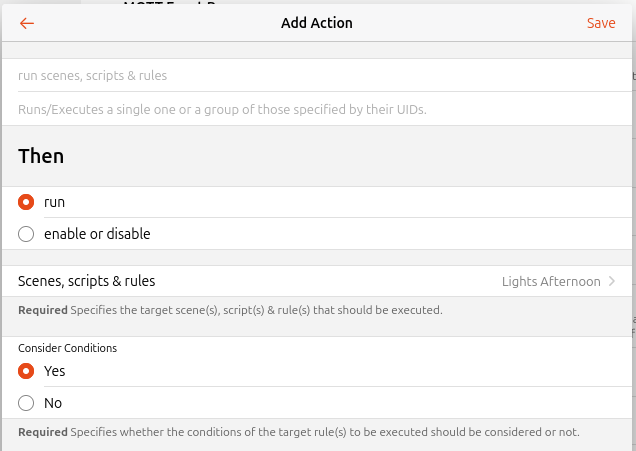

Then add a simple rule action to call the corresponding scene.
The YAML for the final rule looks like this:

actions:
  - id: "2"
    configuration:
      ruleUIDs:
        - lights_afternoon
    type: core.RunRuleAction
Repeat for each scene.
One advantage of this approach is it’s easy to add triggers from other sources (e.g. a presence simulation rule, Astro sunrise/sunset events, motion events, etc.). It’s also easy to add conditions (e.g. don’t allow the rule to run when you are not home or it’s between 22:00 and 06:00).
Option 2 will use the YAML I pasted in above. Copy the triggers section. Then navigate to the Scene. Open the code tab and replace the triggers: [] line with what you’ve copied.
