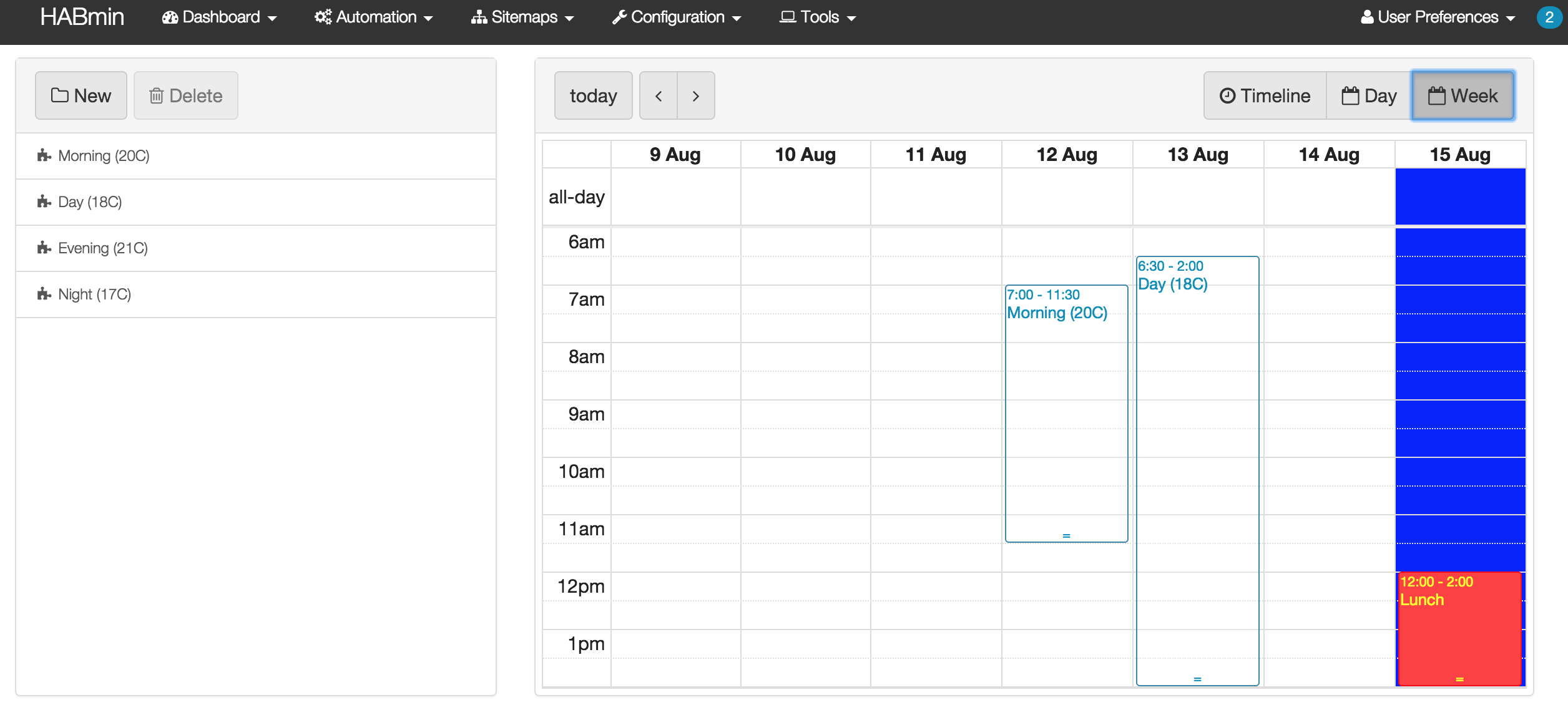

I’m also quite interested in this topic, and it’s something I’ve been thinking about on and off for a while…
I’ve messed around with a couple of interfaces in HABmin - just playing at the moment as I’m not sure how I want the UI to look, and I also don’t know how the backend will ultimately work…
For the backend, I fully agree with Kai - this needs to be linked to the new rule engine. I’m not completely sure where that’s at as there has been some discussion a while ago, although I see some recent PR activity, so hopefully this might become clearer in future…
For the UI, I’ve toyed with two interfaces, and HABmin currently incorporates them both (for playing only). One is a calendar style…
and the other a timeline style…
The idea (not implemented) is to be able to add new events/schedules into the list - they can be dragged around in the interfaces, and linked to either a rule, or just a command (so you don’t have to create a rule when all you want to do is send a single command to turn the coffee machine on at 6am).
Currently this is implemented using a couple of plugins, so it’s really just templating and playing at the moment so that I can get a feel for how it looks etc. I think it would be an interesting discussion to get a few ideas for UIs, and I also like the simplicity of the EcoBee interface that @watou posted…
Any thoughts on event schedulers would be of interest I think :smile:
