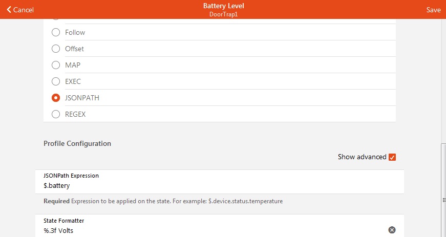

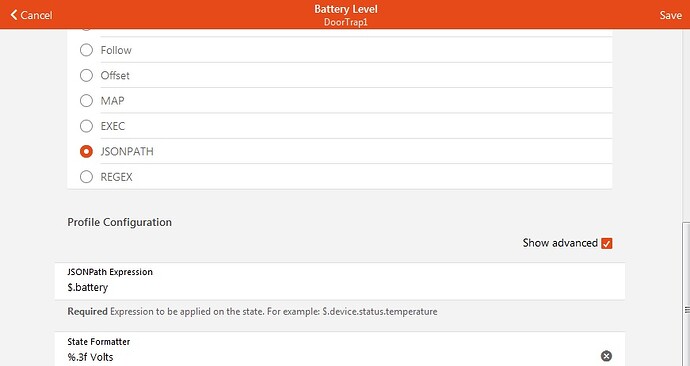

Where are you trying to transform it?
In the UI , where I link item to channel see below image
Well that’s why as it’s r18 that has the fix in above

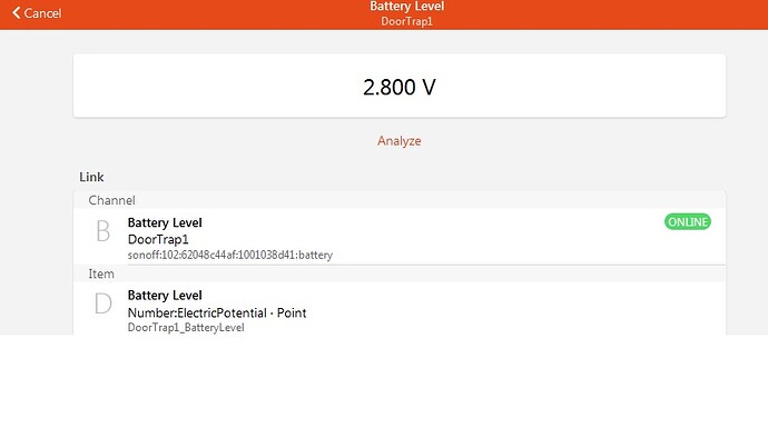

Upgraded to r18 , there is progress. As you see in the picture it shows voltage 2.800 V
Now the problem is shifted in the log , where battery voltage in the past appeared with 3 decimals i.e. 2.813, now appears truncated 2.8 as you can see in the log below and it only adds two zeros in UI formatting. We are getting there , Thanks , Dimitri.
730ee32fc75d","online":false,"params":{"bindInfos":{},"switch":"off","battery":2.8,"fwVersion":"1000.2.924","type":3,"chipID":"d027020717d2","mac":"d027020717d2","rssi":-88,"lastUpdateTime":"2021-03-20T16:57:53.112Z","actionTime":"2021-03-20T16:57:53.112Z"},"denyFeatures":["sceneClick"]},"index":0}],"total":1}}
That’s correct.
The current value is 2.8 in the log (that’s the data straight from the device unchanged) so the .3 decimal places adds 2 zeros
If it were 2.813 then it would show 2.813
