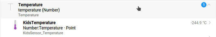

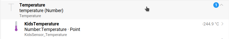

Hi @delid4ve, In “Things” window, Channels tab, when expanding Humidity (item linked already), I see “Err” and the log shows this:
18:40:06.609 [WARN ] [se.internal.SseItemStatesEventBuilder] - Exception while formatting value '37' of item KidsSensor_Humidity with format '%.1f %RH': Conversion = 'R'
And temperature reads -244.9 degrees centigrade.

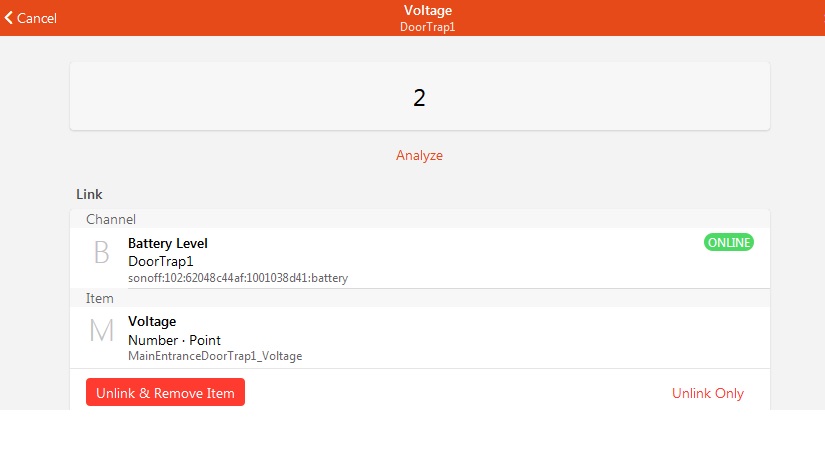

Dave and Emre hi. First for Dave my DW2 works very well.
A last question (I hope) I try to display the battery voltage info which I see in the **log 2.813 but I selelct in the channel link **
JSONPATH:$.DoorTrap1.battery and format %.3f and as you see in the log below it cannot transform. I tried all sorts of device names DoorTrap1 , DeviceID , even the channel-linik name with no success.
I know I am distracting you from the main subject but probably someone or you can advise on how to format . Thank

23:30:51.844 [WARN ] [rofiles.JSonPathTransformationProfile] - Could not transform state '2 V' with function '$.MainEntranceDoorTrap1_Voltage.battery' and format '%.3f Volts'
Where are you trying to transform it?
The battery voltage is as follows:
QuantityType<ElectricPotential>
with unit type as VOLT
See here for conversion help:

Dave hi,
1.I created thing named : DoorTrap1
2. Went to channels of this thing …it shows all channels i.e. switch , Battery Level (which is a number..) …etc etc,…
3.Selected Battery Level channel because I want to display battery voltage
and created the link , but it displays 2 for the Battery Level instead of 2.813 Volts (which I see in the log)
4.In order to see the voltage (number) with 3 decimals , under profile ,I selected JSONPATH instead of no profile
5. I enter in JSONPATH formatter the following : $.DoorTrap1.battery …as it appears on the log above. i.e. device = DoorTrap1, battery and in State formatter = %.3f Volts
6. I save the link , but it seems the format is not working. In the attached jpg
I must be missing something elementary !!!
Dimitri
@DimitriR Can you try deleting the thing and then clearing the cache.
The channel was changed from Number to Number:ElectricPotential
There was an error in that it was fetching the value as an integer but that’s changed now to a double so should work
Try delete all things including the account things. then delete the 2 txt file in userdata/sonoff

Dave hi
I upgraded to r17, deleted cache , thing etc , restarted OH3, recreated DoorTrap1 Thing . I kept the account thing. Still Voltage is truncated.
Question ; Do I have to use No profile to see the voltage with 3 decimals ?
or do I have to use JSONPATH profile which I have tried too but I am not sure if the info I enter in the JSONPATH expression and state formatter to %.3f Volts
As you can see in the log below the battery voltage is now 2.8.instead 2.813
and the warning message shows it cannot transform state.
What function do I need to use ? What am I doing wrong ? Thanks
Dimitri
