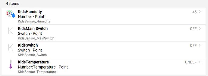

Thanks. I will try now. For the mainswitch, I found this, which seems it’s the hardware one click button on the device that triggers the on/off state of the relay manually.
Which means that the physical button which is on GPIO 0 (device MainSwitch) triggers the rules which activate the GPIO 12 (the relay) and this in turns activate the rule to activate the LED on or off. This enables to have the LED in the correct position even when a command is sent from domoticz instead of using the physical button.
in Rules, syntax in if ... - Let's Control It
Also for next release, maybe for country code selection, could you inherit from main openhab instance? When setting up openhab, we already choose a region, it would be good if Account team region selection could default to that. Also for cosmetics, It still says “phone number code” while we choose country in latest versions.

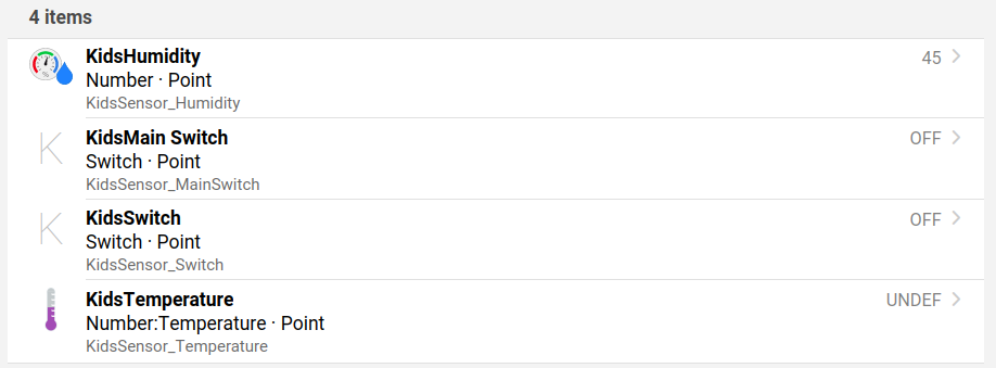

Humidity is now showing as a number, without % at the end.
Temperature sensor is still showing UNDEF
Humidity in item details showing ERR
[WARN ] [e.internal.SseItemStatesEventBuilder] - Exception while formatting value '45' of item KidsSensor_Humidity with format '%.2f %': Conversion = %
