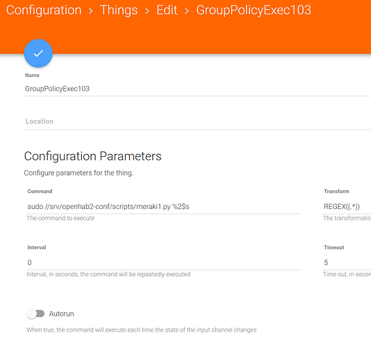

Hi @Gordon_Geist - hope you can help me get going?
I have tried to get a sample of what you have nicely detailed above but the difference being that I dont use thing files so I made one in paperUI (this itself might be the issue but I think that bit is OK.
thing
items
String	Policy_Jackson			"Jackson Meraki"
//Device Policy 103
String     GroupPolicy103_Output          "Output"           {channel="exec:command:GroupPolicyExec103:output"}
String     GroupPolicy103_Input           "Input"            {channel="exec:command:GroupPolicyExec103:input"}
Number     GroupPolicy103_Exit            "Exit Value"       {channel="exec:command:GroupPolicyExec103:exit"}
Switch     GroupPolicy103_Run             "Running"          {channel="exec:command:GroupPolicyExec103:run"}
DateTime   GroupPolicy103_Lastexecution   "Last Execution"   {channel="exec:command:GroupPolicyExec103:lastexecution"}
meraki.py
#!/bin/sh
mac=$1
merakiurl="https://dashboard.meraki.com/api/v0/networks/5XXX77/clients/${mac}/policy?timespan=2592000"
curl -L -H 'X-Cisco-Meraki-API-Key:efcecb50580adxxxxxxxxx6b99e3fe98382f6420' -X PUT -H'Content-Type: application/json'  --data-binary '{"devicePolicy": "group","groupPolicyId": 103}' $merakiurl
exit 0  ```

trying to munge it together on a command line as one curl command it shows “page not found”
any ideas?
So sorry I didn’t see this. My system was in the “not broken so don’t fix”. Just got back on because I borked the system (for exactly that problem - it wasn’t broken but I did a blanket apt-get upgrade and bam wouldn’t boot and couldn’t get it past a certain out of order process starts).
I use UNIFI now and was in the process of adapting/building a way to do similar to the Meraki. My Meraki APs basically got flaky (bad placement by me) so I haven’t been running the scripts
Hmm looked at the API to see if there was a breaking change and didn’t see anything The problem I had when putting this and similar curl commands together was the way the scripting language handles typing if I remember correctly.
