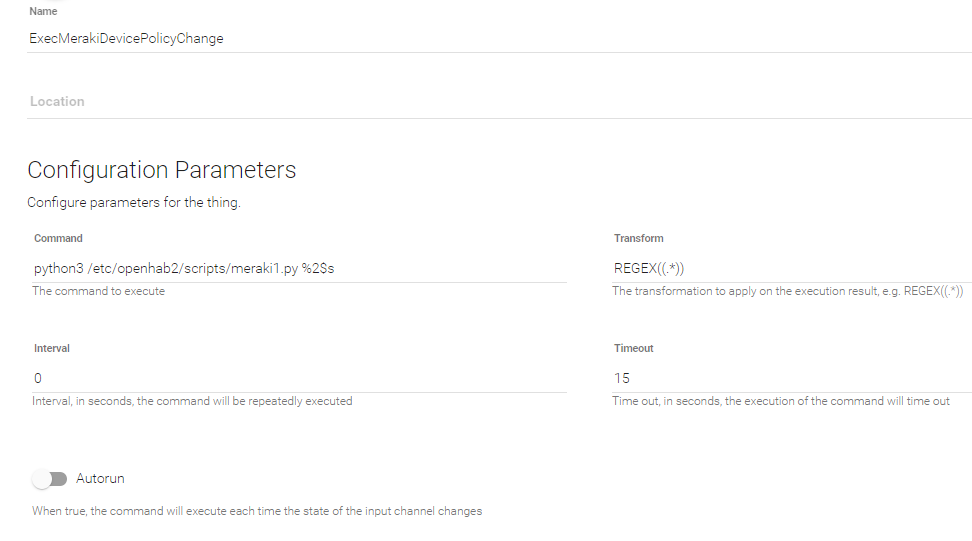

Things
I do all my things in PaperUI, so add a new Command thing from the exec binding

Python script
- The exec item sends the MAC address and policy as the variable
- < NetworkID > is your Network ID that contains the Meraki devices you are managing.Read the Meraki API manual
- <api_key> is the unique api-key for your organization and received after you apply for api access. Consider this as important as securing your root access password i.e. where the script is and the users/groups that can read.
- You just need to change these two variables and the rest is taken care of
