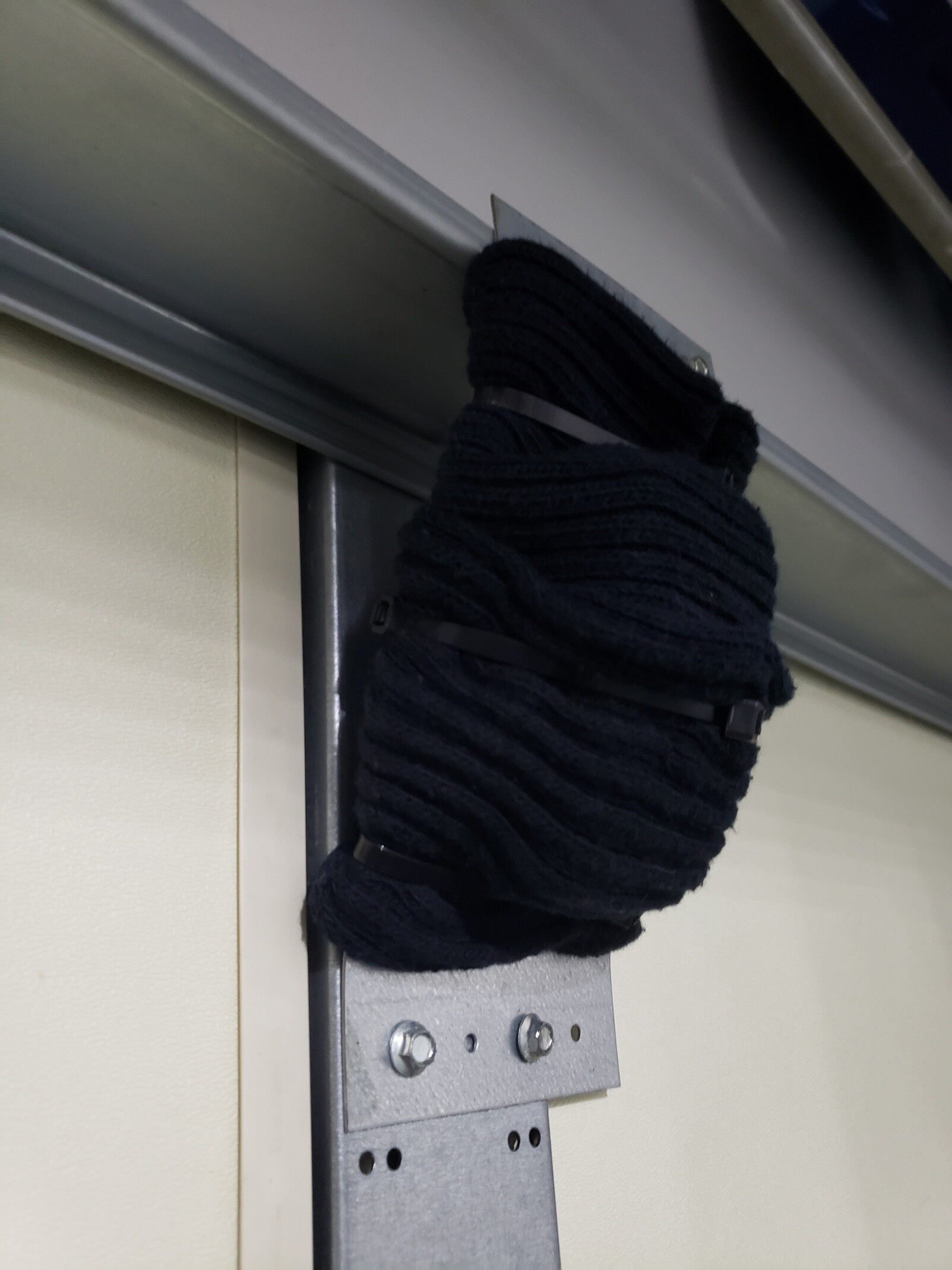

One of the nice features this sensor has is the ability to wire an external reed switch to the sensor…just thinking out loud, I’m wondering if there is a way you could place the sensor in something to keep it warm without hampering the radio signal - allowing you to get use during those cold Chicago winters.

I bought the sensor from Amazon today. Here’s what I did with the garage tilt sensor and it still goes out if the temp is below 20 degrees.

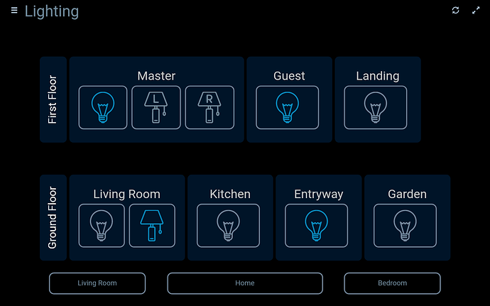

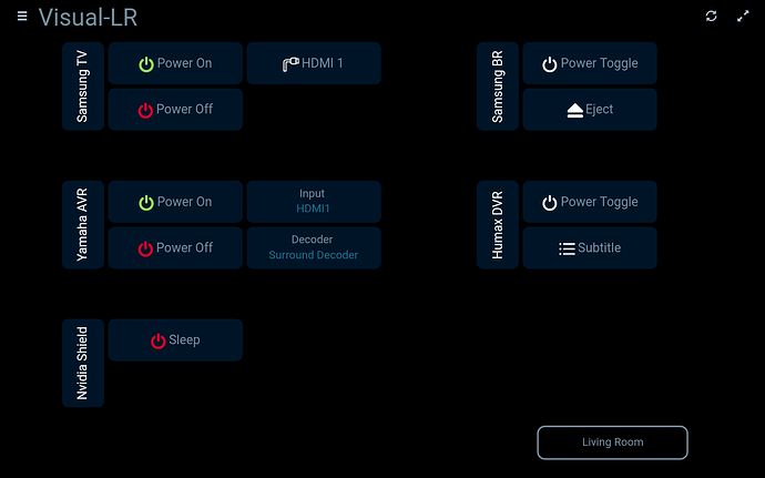

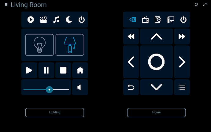

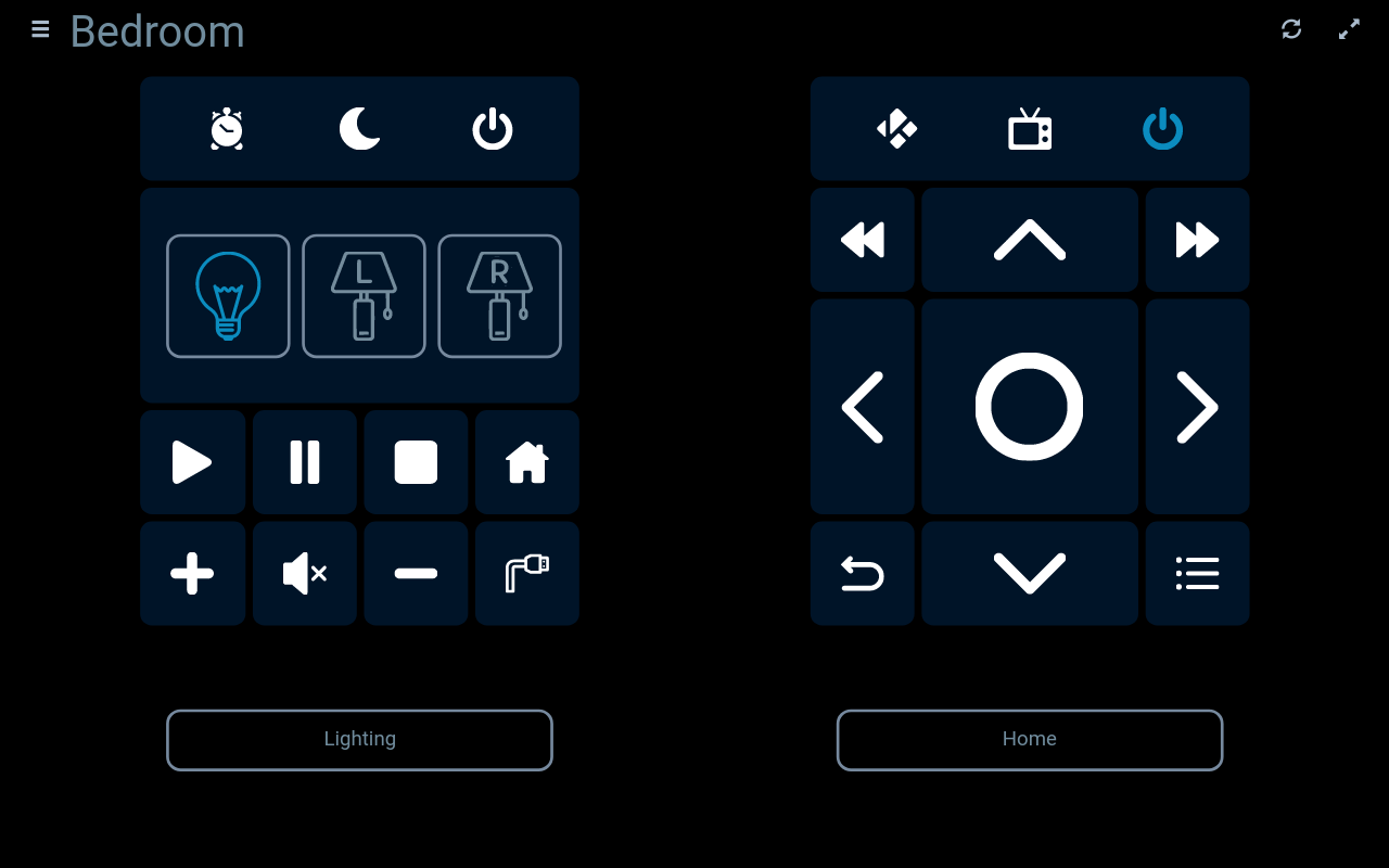

After a long holiday of lurking, here is my progress so far. I’ve found some of your examples ridiculously helpful so thought I would share my efforts. The layout is designed for a Kindle fire HD8 which was just big enough.

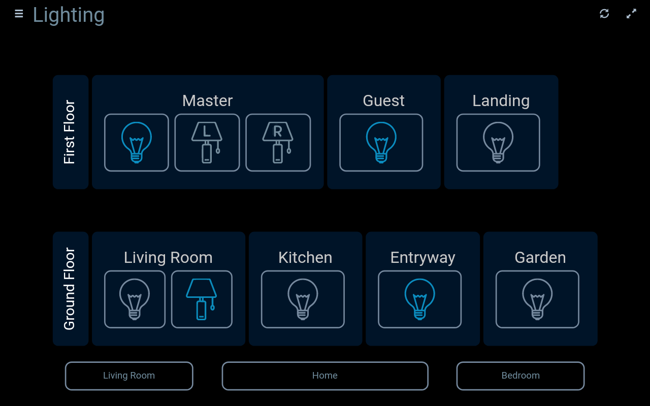

I’ve been playing around with putting a TV remote and lighting control for the living room on a touchscreen. Right now it’s scaled to my laptop, but I need to resize it for a smaller tablet.

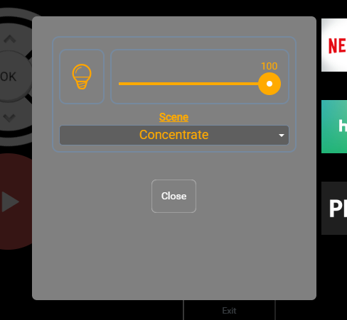

Modal dialog for the lighting control
The code is pulled from various posts I couldn’t of done it without others work, here are the JSONs for the panels.
roku-fav-buttons.widget.json (2.2 KB)
livingroom-lighting.widget.json (6.2 KB)
other-buttons.widget.json (982 Bytes)
volume-buttons.widget.json (1.2 KB)
harmony-entry.widget.json (2.4 KB)
remote-control.widget.json (8.8 KB)

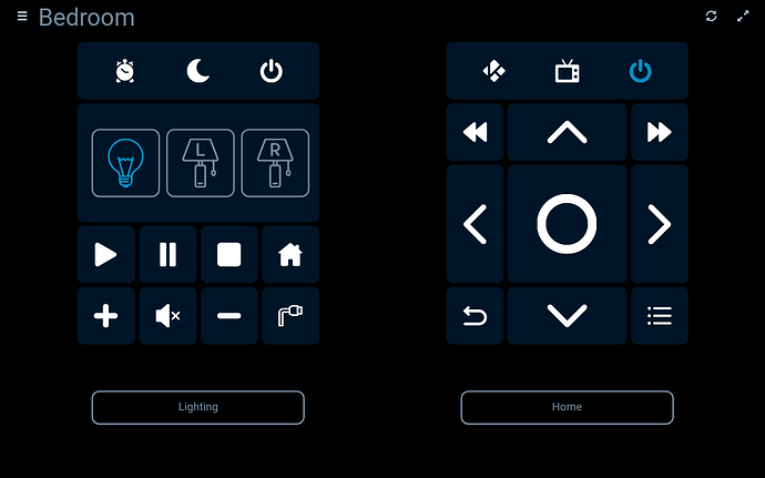

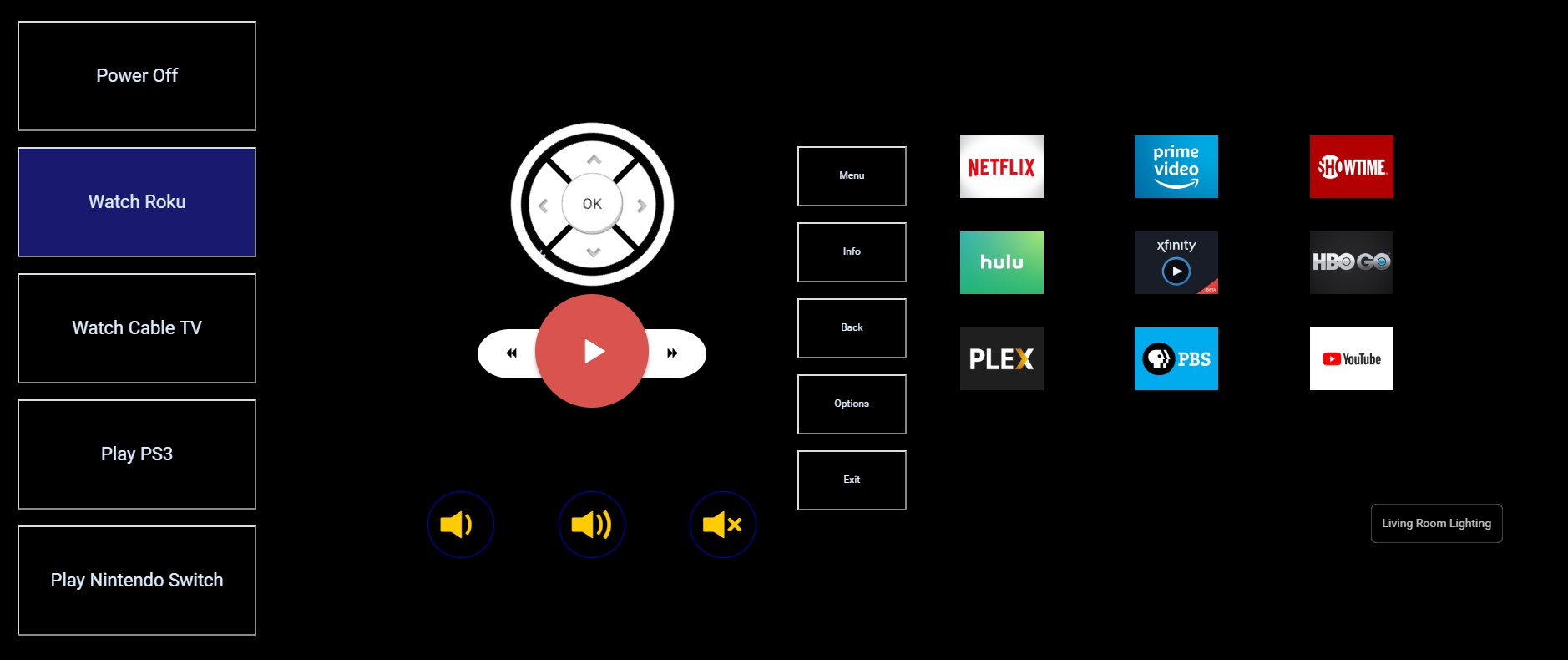

Latest additions, KODI, Netflix remote, and Chromecast remote.
