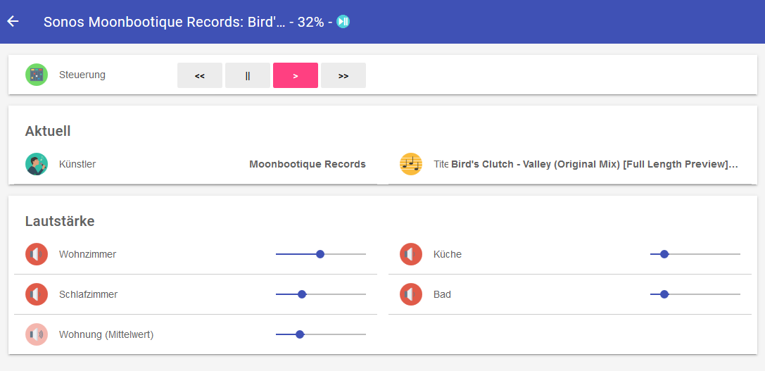

  • Summary Elements Almost all front page text elements are rule-based summaries of a more complex Item structure. The summary element often contains a nested subframe with all the (relevant) details and controls. See for example the Sonos Summary Item

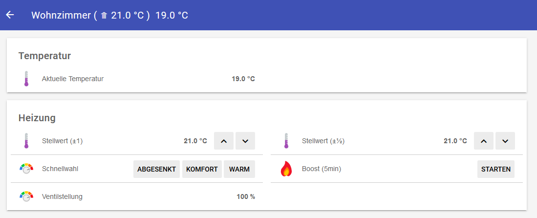

This is my progress so far, but i am still building up this thing :smiley:
NESTED SITES:

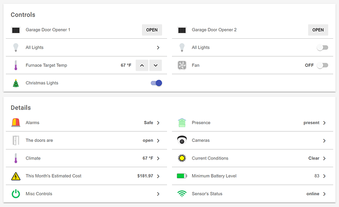

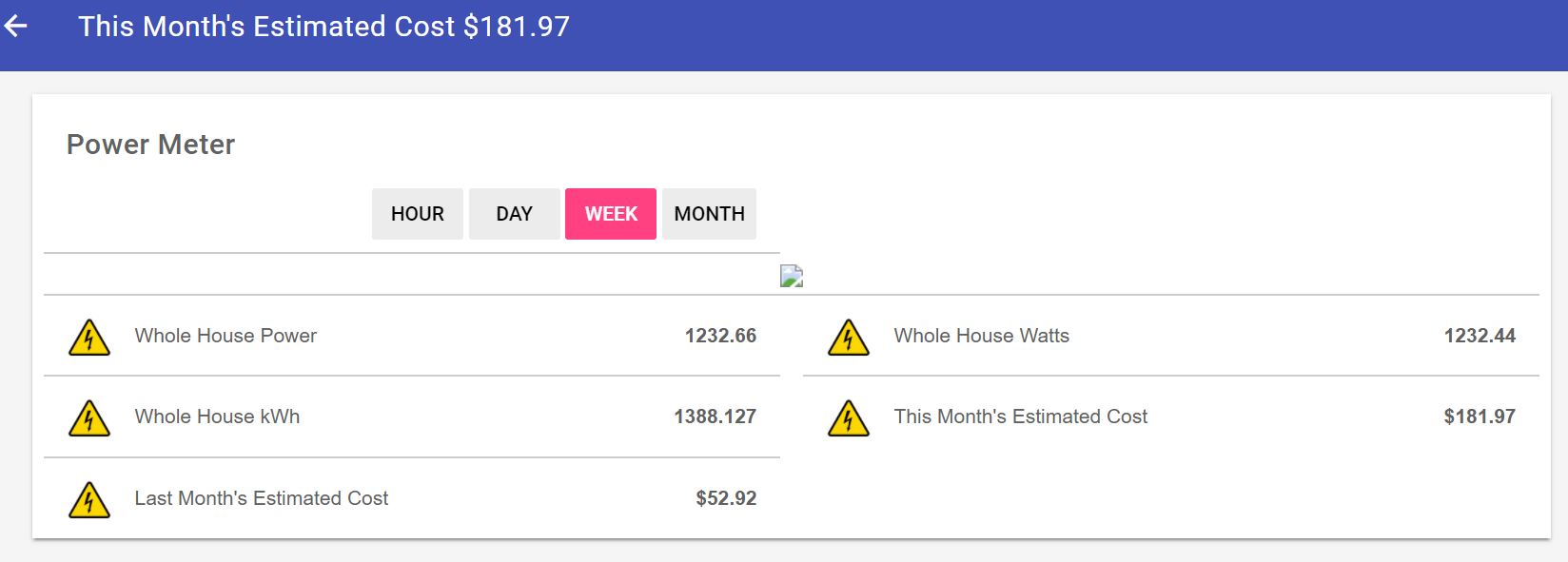

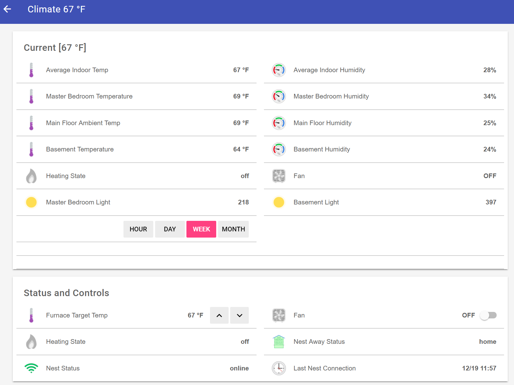

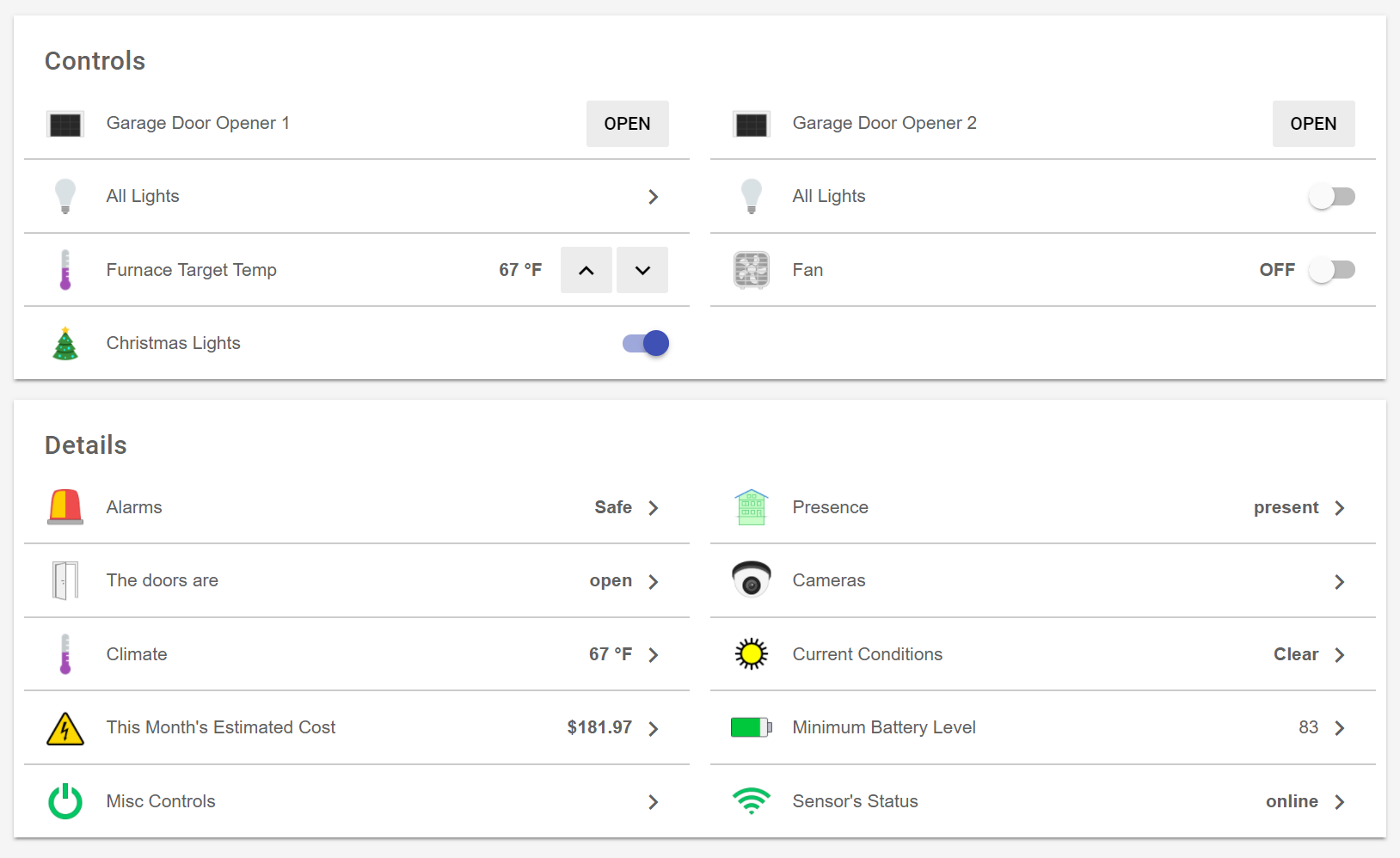

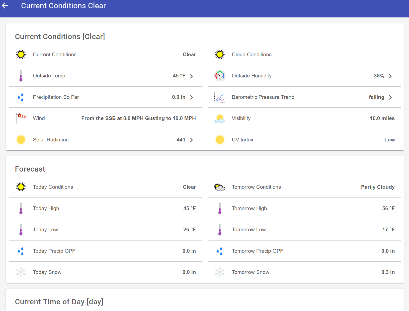

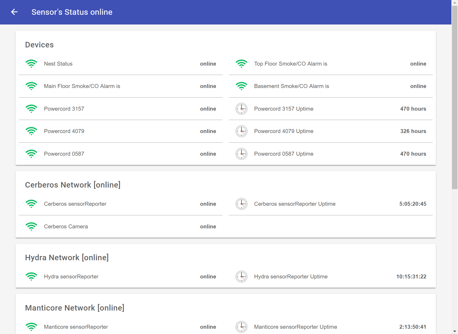

I build my home automation to primarily just do it’s thing without manual intervention so I’ve not spent a lot of time on BasicUI. But I will second all of Thom’s advice.
The only thing I’ll add is commonly used controls should be at the top and readily accessible. This is more useful when you only have a few such manual controls, in my case just the garage door openers, lights, and the furnace.

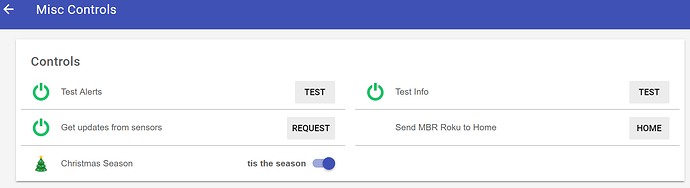

I won’t show every submenu, just some of the more interesting ones. But notice that all the submenus have a summary value where applicable so I can quickly glance on my main page and see most of the info I would care about. If there is something off on one of those menu entries, I can drill down to the submenu and get details. For example, if Sensor Status shows “offline” I can click and see which sensors or services are offline.

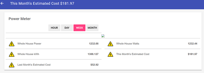

Note, my Grafana is broken right now and not generating prerendered charts so where ever you see the Hour, Day, Week, Month buttons you would normally see some charts.
Note that if I switch off Christmas Season, the Christmas Lights control on the main page gets hidden.
May I ask you about power meter for whole house? Which device do you use?
It’s an Aeon Labs Smart Energy Monitor. I found one for really cheap and got it on a whim. I don’t really have much use for it but I try to keep it up and running.

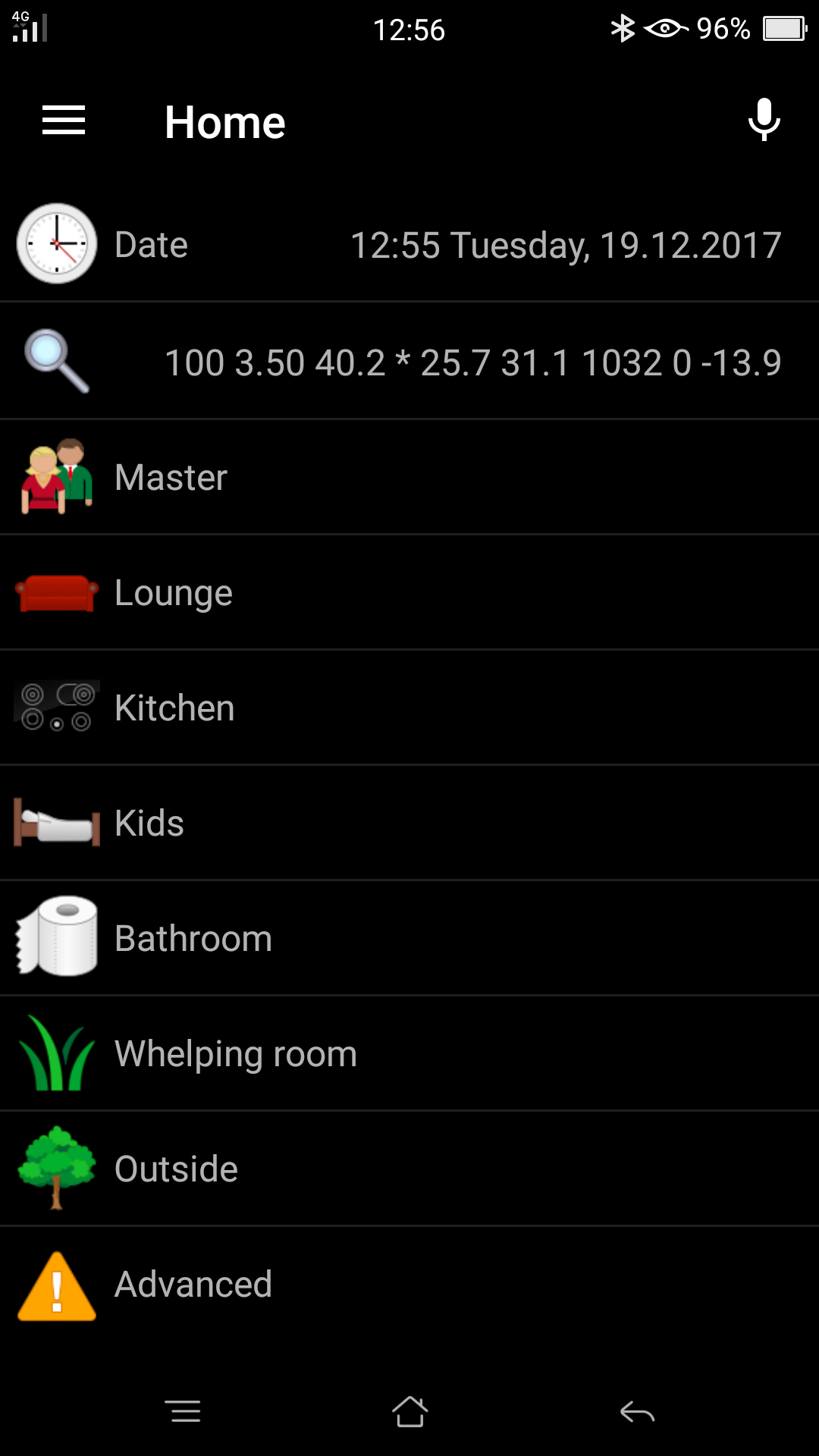

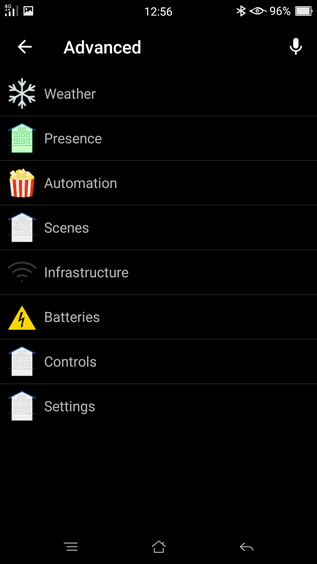

Looks great, how did you set up your sitemap so that is shows the current icon for the today and tomorrow conditions?
Wow, how did you manage to change the color scheme? Or is this not the basic UI?
He has posted screenshots of his Android openHAB App using the Dark or Black/AMOLED Theme.
Thank you - I like the look; but I didn’t find a similar theme in the iOS app. Or did I miss it?
I don’t use Apple products so I don’t know.
