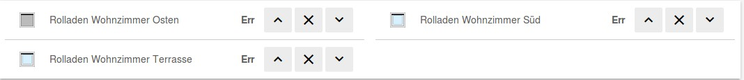

I don’t use Z-Wave but have got another issue according to the HomeMatic rollershutter position in 2.4 RC1:
2018-12-31 10:44:48.403 [WARN ] [ui.internal.items.ItemUIRegistryImpl] - Exception while formatting value ‘0’ of item Roll_gEG_XX_Ost with format ‘%.2f %unit%’: Conversion = ‘u’
2018-12-31 10:44:48.404 [nt.ItemStatePredictedEvent] - Roll_gEG_XX_Ost predicted to become DOWN
2018-12-31 10:44:48.424 [WARN ] [ui.internal.items.ItemUIRegistryImpl] - Exception while formatting value ‘100’ of item Roll_gEG_XX_Ost with format ‘%.2f %unit%’: Conversion = ‘u’
Does anybody have an idea how to fix this issue?
Thanks in advance.
Cornelius

Please show your item configuration, it seems to be a wrong label definition.
Try
Rollershutter   Roll_gEG_XX_Ost "Shutter XX Ost[%d %%]"
Hello Boogieman,
thanks a lot for your fast advice. Your suggestion helped me solve my issue!!
