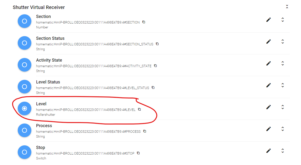

The thing is involved in the Paper UI and has an item on channel 4 level.

@olialb I think so too, but I configured the item via the PaperUI. Can I customize the item configuration there such as well as in the item file.
I don’t think you can do the alexa stuff, but the rest is ok. Screenshot?
