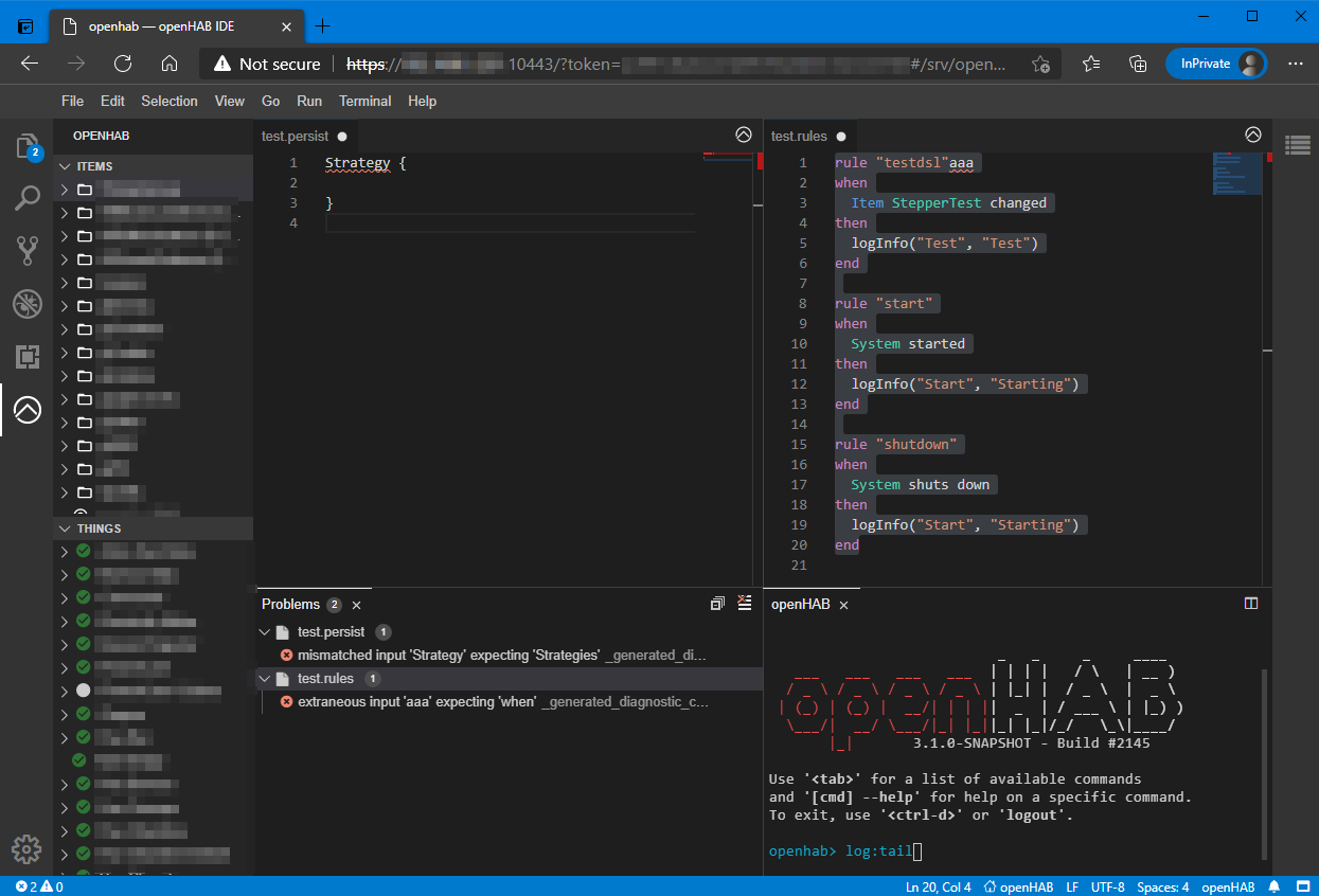

I have played a little bit with Eclipse Theia today and ended up having it working on my PINE A64 alongside my OH instance. Theia is very similar to VS Code and can run VS Code extensions (including the openHAB extension!). I see potential in this to provide a preconfigured, ready-to-go, predictable environment, and perhaps even advanced editing features like extensions to provide e.g. ways to edit JSON DB-based entities on the local instance. Because all settings and preferences and workspaces reside on your server, you can access the IDE from any device and resume editing.
Also, the “open console” command works out of the box - since the terminal runs on localhost no need to allow SSH access for other hosts.

Verify that your configuration appears in the file explorer on the left, and that the list of items from your local openHAB instance appear.

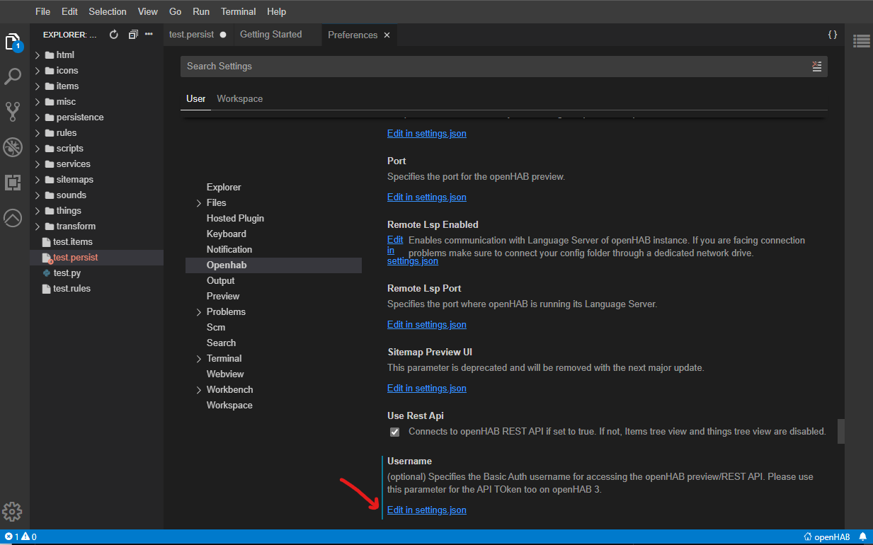

There will be an error for the list of things, however, because you have to configure the authorization to the API by setting an API token.
Follow openHAB API tokens | openHAB to generate one, then in the IDE, open the File > Settings > Open Preferences menu, and in the openHAB section, click Edit in settings.json below Username and specify the token there.
The settings should resemble the following:
    "openhab.host": "localhost",
    "openhab.username": "oh.ide.CFWsJZ799oi3GcLSLd1C..."
Save the settings.json file, and go to the openHAB panel and click the Refresh buttons in the Things pane header. The list of Things should now appear.

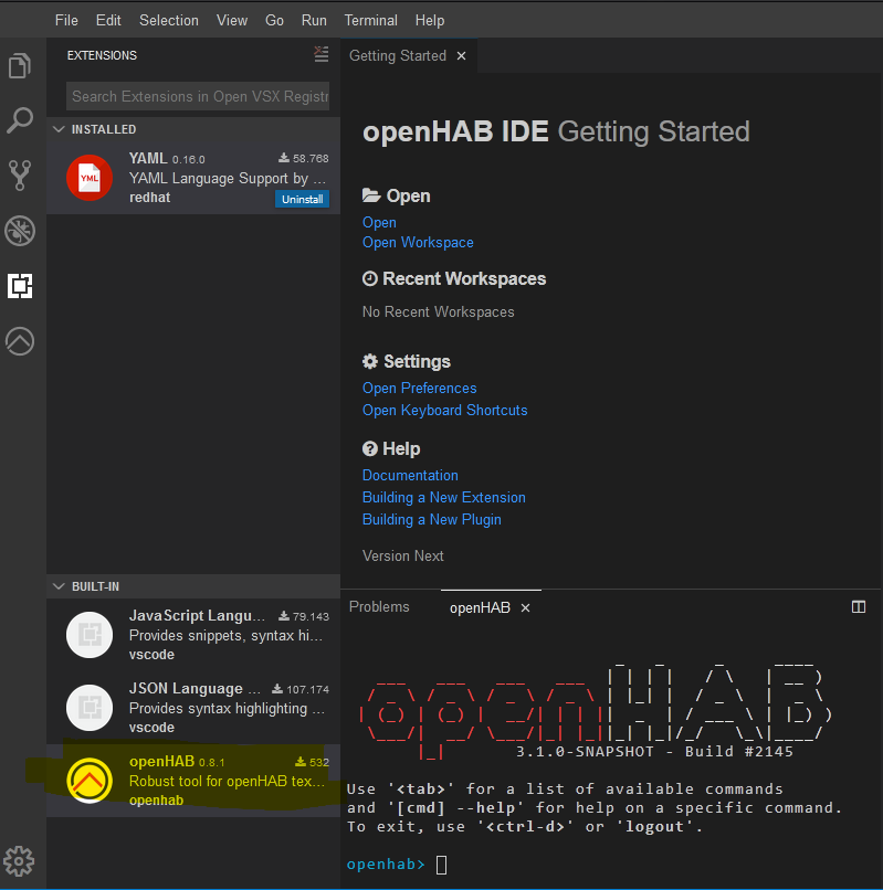

Now it does, but I liked the fact that you can simply brand it “openHAB IDE” and pre-install the openHAB extension to make it built-in:
So we can have a customized openHAB-branded IDE ready out-of-the-box, or the full VS Code with code-server, I don’t have a strong preference either but it’s nice to have both approches available.
