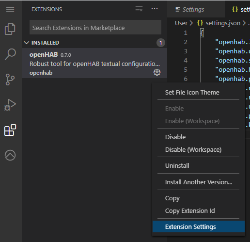

Then, install the openhab extension in the browser:
then, change the config to your openhab-server to your liking:
    "openhab.itemCasing": "snake",
    "openhab.useRestApi": true,
    "openhab.sitemapPreviewUI": "basicui",
    "openhab.host": "10.0.1.2",
    "openhab.port": 8080,
    "openhab.remoteLspEnabled": true,
    "openhab.remoteLspPort": 5007,
    "openhab.username": "openhab",
    "openhab.password": "habopen",
    "openhab.karafCommand": "ssh openhab@10.0.1.2 -p 8101 -t",

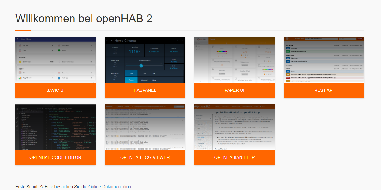

and then, I recommend to add it to your dashboard:
by adding this
codeserver.link-name=openHAB Code Editor
codeserver.link-url=http://10.0.1.9:8080
codeserver.link-imageurl=../static/codeserver.jpg
to your file here: services/dashboard.cfg
