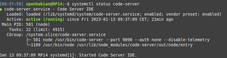

Check if that was successful with
systemctl status code-server
If the output reads at some point code=exited, status=203/EXEC please check the path of the execStart parameter. First post from @hmerk points to the executable in opt/coder/code-server which did not work for me.

Check port binding
netstat -lnp
it should read port 9090 somewhere.
