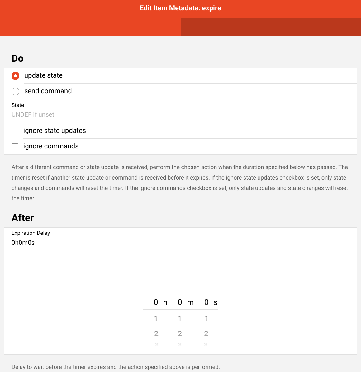

You can configure Expire to only reschedule itself on changes. If the weather station goes offline, presumably the Item’s states are just being updated, not changing.
Just check “ignore state updates” and it will timeout the Item even if it’s continuing to be updated to the same value.
You’ll have to be careful to set a long enough expire so the Item doesn’t reset just because the weather isn’t changing that much.

The easiest approach would be to just tell expire to ignore updates.

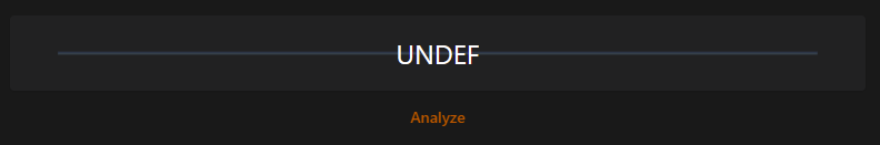

I have tried this approach, and indeed I’m getting the value unset, but it seems that this doesn’t work with persistence (rr4j):
The persistence history is still recording the previous valid value. Is there a solution or work around to this?

It’s never going to work with rrd4j in any approach. NULL and UNDEF never get saved to the database and the way rrd4j works something has to be saved every minute or else the entire database breaks. So rrd4j is going to keep saving the last value until the Item changes to a new value that can be saved. You are never going to get gaps in your charts with rrd4j to indicate no data. It just doesn’t work like that. If you need that you need to use some other database that doesn’t require a valid number to be saved every minute.
Alternatively you can have expire update the Item to some number to indicate no data, but what the number should be isn’t so easy for weather data. 0 is a perfectly valid temperature but -50 is going to throw the y scale on your charts way off.
