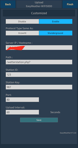

So - my PHP now looks like this (I know, it’s a bit dirty, but works):
$weatherprefix = "WeatherStation_"; // if you have a prefix in your OH2 items configuration
// resends all GET-Values directly to OH2 API
