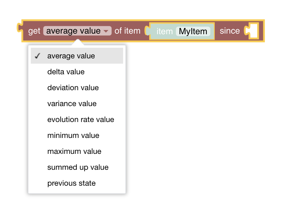

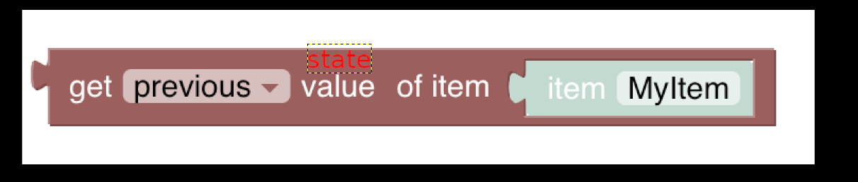

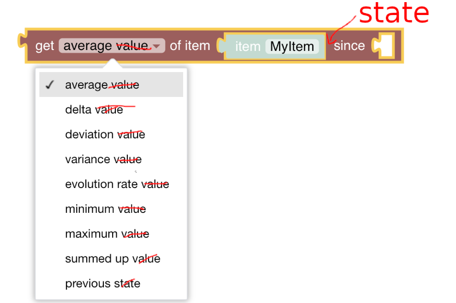

average state sounds a bit weird though, doesn’t it? After all, a ‘state’ is only valid at a certain point in time. If anything, IMHO it should be ‘average value of state’, ‘state deviation’, etc.
Or remove both ‘value’ and ‘state’? ‘Average’, ‘deviation’, ‘sum’ etc. look equally descriptive to my eye. Exception: ‘previous state’ needs to keep the ‘state’.
Where do you see “average state”? I only see values and the last one in the the drop-down has state.
Commenting based on the screenshots on the first post
Comments on

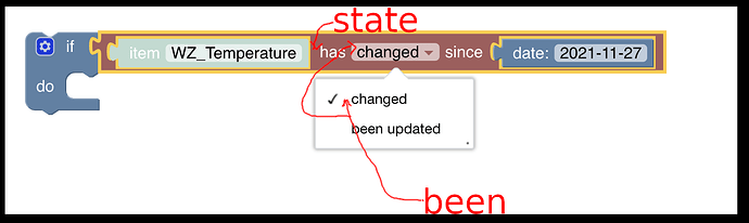

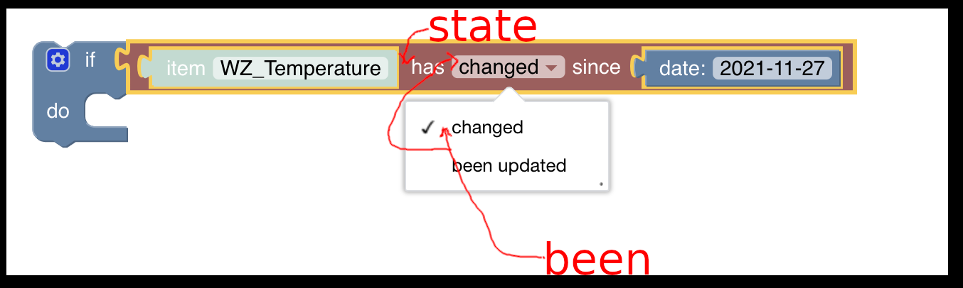

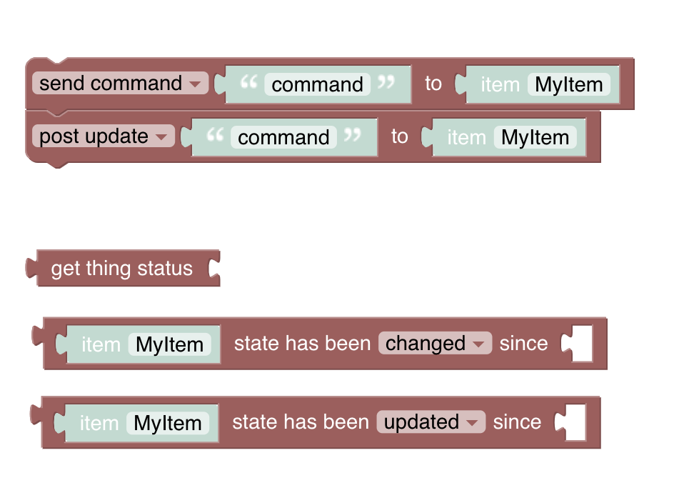

  • item XX has changed since: would XX state has changed|updated since YY be better? Also, have the same past tense for changed and updated. I think this would emphasise the difference that we are talking about the state. That’s even more important now with these changes, as blockly commands deal with both item objects and the state values.
Comments on Extending Blockly with new openHAB commands - #176 by stefan.hoehn

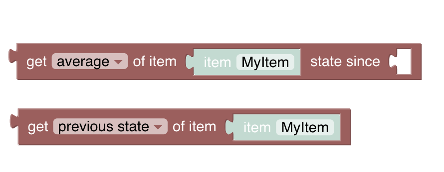

  • How about: get state of item XX
@maniac103 broughts good points about the exact spelling of the persistence functions. I will add one more proposal for your consideration
  • get <average/delta/deviation> of item XX state since YY

To make my life easier: Can you please edit your post above and add images of the blocks you want to have changed and even better scribble the changes what you want to have changed next to the block or on top of it. This avoids misunderstandings on my side.
Thank you
Stefan
PS:
“get <average/delta/deviation> of item XX state since YY” has already been amended by me, see above
Hi Stefan, no offence taken, I do appreciate that.
Let me have a look if I can make it easier to pick up the proposed changes – makes it easier for others to comment as well .

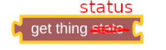

I have updated the above post with pictures.
These are suggestions naturally and my feedback, and mostly bikeshedding. I leave it up to you if the changes make sense considering the effort involved etc.
Great, that definitely makes it much clearer and honestly this is almost no effort at all. I will post an update soon.

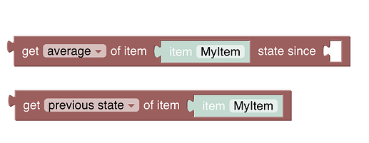

Here you go
and
Happy now? :wink:
Looks great! That was fast

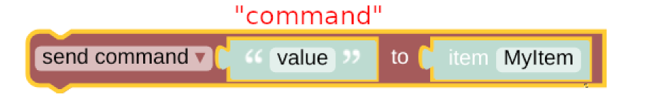

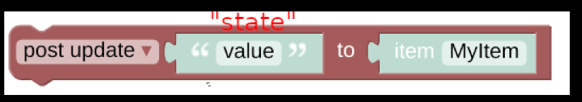

One comment on the second one, we post state updates, not commands. Are you able to have different placeholders depending on the action, meaning
<send command> "command" to item <item MyItem> <post update> "state" to item <item MyItem>
It was my understanding that you wanted to replace ‘value’ by ‘state’, in which case ‘average value’ would become ‘average state’.
Nevermind though, this has been cleared up by @ssalonen’s comments and your changes :slight_smile:
Probably would be non-trivial, that’s why the original block had “value” as the placeholder, which I thought was a suitable generic term for both what you send as a command or a state update.
i.e. update the state using this string value & send a command with this string value (commands and states are actually typed in OH core).
I agree Yannick, I just tried to find a way to check and change the shadow block dynamically but that turns out to be either not straight forward or not doable at all.

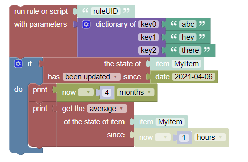

I made significant changes to Stefan’s PR and merged so we can test them in the upcoming milestones and release candidates.
I’m very pleased with Blockly’s new capabilities!
generates:
function addFrameworkService (serviceClass) {
  var bundleContext = Java.type('org.osgi.framework.FrameworkUtil').getBundle(scriptExtension.class).getBundleContext();
  var serviceReference = bundleContext.getServiceReference(serviceClass);
  return bundleContext.getService(serviceReference);
var ruleManager = addFrameworkService('org.openhab.core.automation.RuleManager');
function convertDictionaryToHashMap (dict) {
  if (!dict || dict.length === 0) return null;
  var map = new java.util.HashMap();
  Object.keys(dict).forEach(function (key) {
    map.put(key, dict[key]);
  return map;
var dtf = Java.type("java.time.format.DateTimeFormatter");
var zdt = Java.type("java.time.ZonedDateTime");
function getZonedDateTime (datetime) {
  return zdt.parse(datetime + ' 00:00:00 +00:00', dtf.ofPattern('yyyy-MM-dd HH:mm:ss z'))
var persistence = Java.type('org.openhab.core.persistence.extensions.PersistenceExtensions');
ruleManager.runNow('ruleUID', true, convertDictionaryToHashMap({'key0': 'abc', 'key1': 'hey', 'key2': 'there'}));
if (persistence.updatedSince(itemRegistry.getItem('MyItem'), getZonedDateTime('2021-04-06'))) {
  print(zdt.now().minusMonths(4));
  print((persistence.averageSince(itemRegistry.getItem('MyItem'), zdt.now().minusHours(1))));

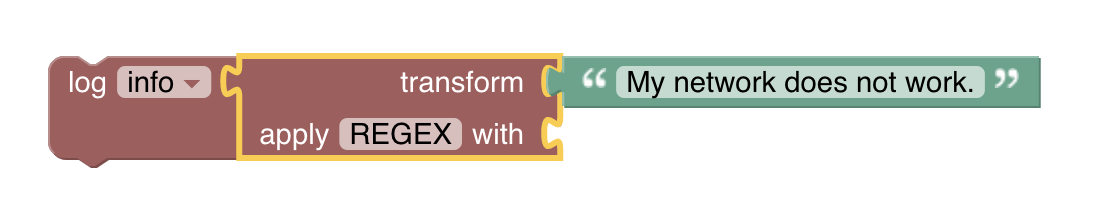

Transformation

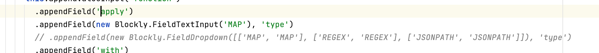

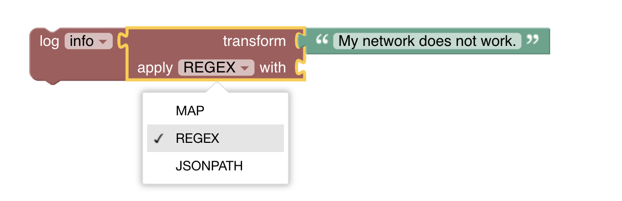

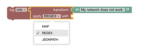

Why did you change the dropdown of the transformation to become a textfield? It is clear to me that a text field is more generic but I don’t like the idea here.
I think a dropdown is more safe to be used instead of a text field because people could do nonsense here
I see you have kept the dropdown in the code. I would prefer and like putting that back in instead of the text input:
like so
