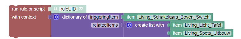

Is there a way in OH Blockly to pass (a list of) Items from a Rule to a Script ?
I tried following in a Rule :
but Blockly doesn’t let me loop through ‘get context attribute’
or doesn’t allow to ‘send command’ to an Item passed via the context dictionary.
This is exactly what I just provided yesterday for the next release - see a few posts above
" * Add a block that allows retrieving dictionary key / values"
see get-value-of-key-from-dictionary
It will be available for 3.3 M1

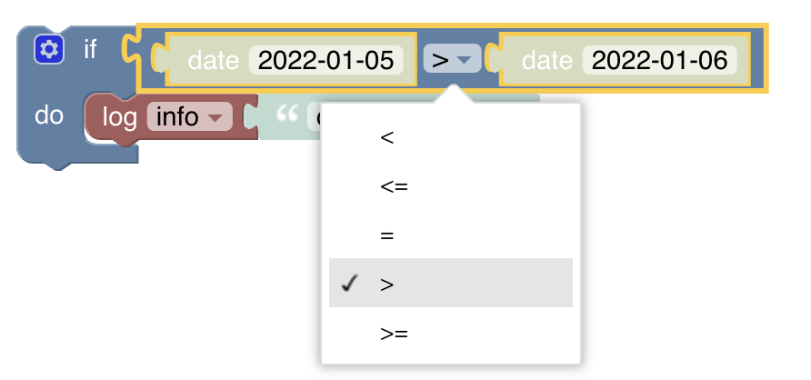

I have started zdt comparison and I think the best way is to provide a comparison block that can be added to an if-block like so
This already works. Some questions:
  • Do you prefer “<=” or “is before / equals” ?
  • I noticed there is no way currently to create a zdt with a text, the only one we have is the one below. Would it make sense to add a datetime-block?
  • I remember you (Rich) once mentioned that adding such a block would be a lot of work. Which other comparison operations or operations in general did you have in mind if you look at ZonedDateTime ?
  • In general, I noticed that we have date blocks in ephemeris and persistence with more coming. Additionally they are distributed over in ephemeris.js, persistence.js and dateoffset.js (I have added the code to the latter and the block to ephemeris…). Wouldn’t it make sense to have a seperate area and move all zdt blocks there?
isBefore is what will most closely match how it works in all the other rule languages. I find it to be more self documenting as well. But I don’t have a firm opinion on that. Either way should work.
Maybe. There are times where one has a DT string they need to parse. However, the number of ways a DT can be represented is huge and I would probably limit it to just supporting ISO8601 strings. If the users need more flexibility than that they will have to use raw code. Otherwise you need to get in the business of providing formatting strings and stuff like that, which would be awesome in the long run but I’m not yet sure worth the effort right now.
I don’t know that we need to support all of ZDT, but at a minimum we would need to support the add/minus methods. isBefore and isAfter we’ve already discussed and you basically have working. I’m of two minds as to whether we should expose epoch or not. I like to encourage people to use Duration instead but that’s a whole other set of blocks with a bunch of operations too.
But of course as soon as it’s there people will want to control how it’s displayed or logged so we might need to support formatting too.
I think so since it’s a cross cutting feature and requirement. They are needed for all those Actions as well as to be used in their own right.
Thanks for the input.
The only thing I don’t like when I prototyped this when I try to translate “<=” as it would become “is before or equal” which doesn’t sound so nice.
One other thing I just noticed:
How could me make the block more clear that is a date comparison block - I used the blueish logic block color - I could instead use the zdt color. Adding the label “date” wouldn’t look nice, I think.
The effort is minimal. If it makes sense I would add that and I would just support one format. I think it is good enough for most of the cases.
Ok, that resonates with me. Though I would love to here @ysc opinion on that as well. It won’t break anything but it will appear differently (I also need to find a way how to document that in the blockly reference then)
I’ll have a look into that after having finished the check.
“Is before or the same as” would work, I think? “Equals” is a bit mathsy, which may be confusing when it comes to dates!
