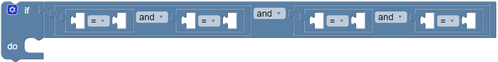

Thank you guys for the fantastic work done on Blockly: I’ve migrated so far 90% of my rules and I really enjoy this addition!
I was just wondering if there is already in place a better way to have more than 2 “and/or” conditions than this:
no big deal, but it’s not pretty :slight_smile:

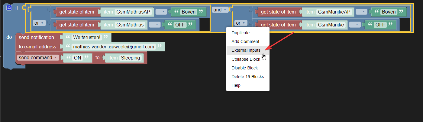

You could put the inputs of one or more blocks on new lines instead of inline. Like so:
Or you could use variables to hold some of the partial results
Sometimes I use that option to make the script more “readable”, but I was referring more to the possibility of adding an option in the block itself to select the number of “and” needed in that block.
Something like we have in the “list” block, where you can select the number of items/lines needed
