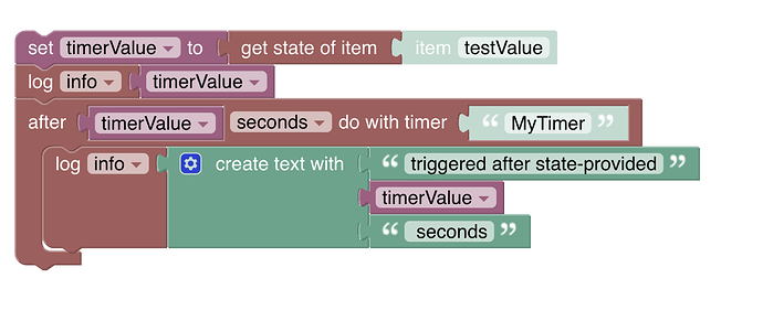

Yes, Christian, you can do it as follows - I just did the following and it works fine for me:
The reason is that the timer requires a number-block. The only way to trick it is to provide the value through a value which is “neutral” and is allowed to plug in as a replacement for the number type.

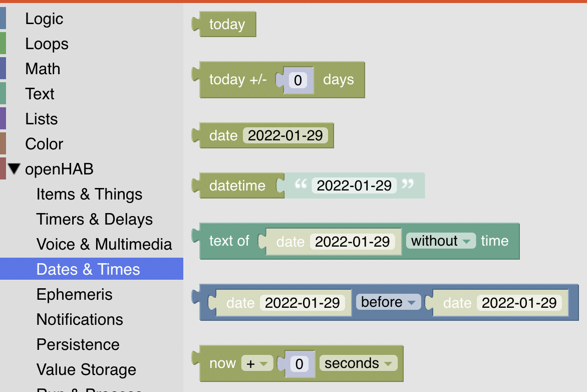

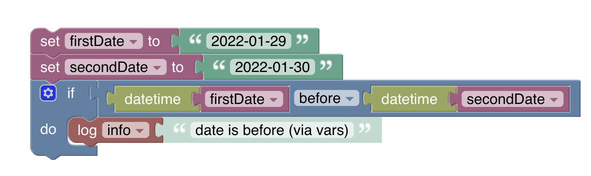

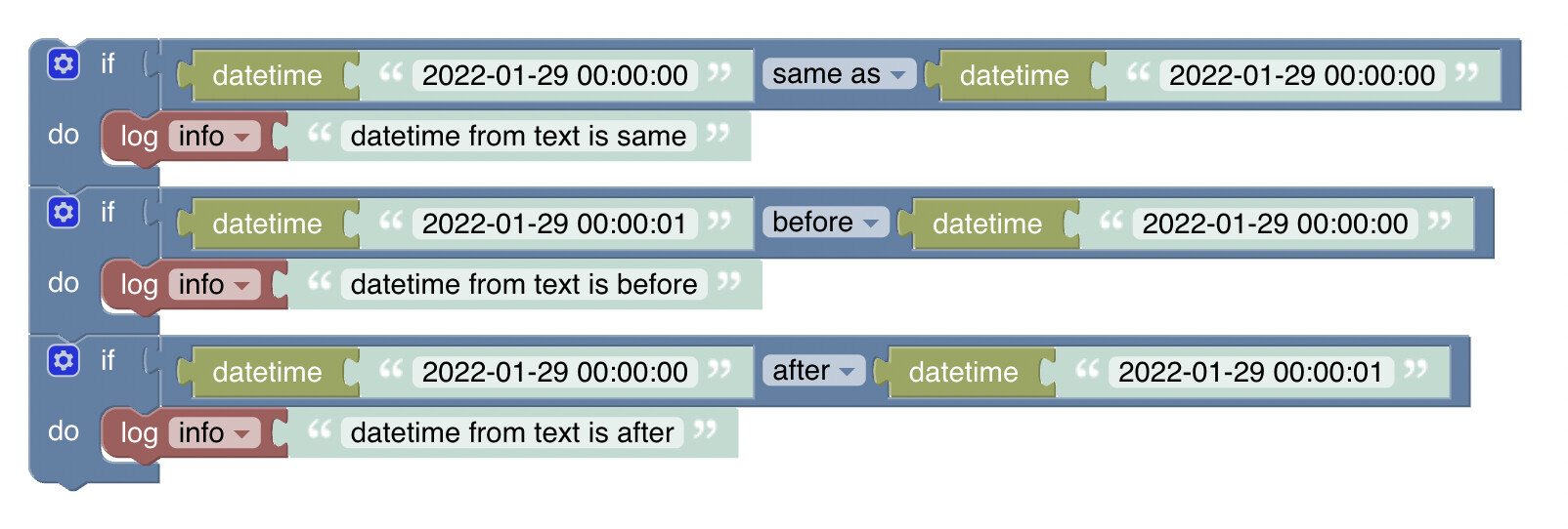

I have worked on the date comparisons which seem to be work pretty well now. By design it didn’t want to go for complex blocks that allow individual input for all datetime fields like day, month, year, hour, minute, second … but generating them from a String is much more convenient.
So from now on you can create a date-block from three different formats
  • yyyy-MM-dd (only format that was allowed to be provided)
  • yyyy-MM-dd HH:mm:ss (new)
  • yyyy-MM-dd HH:mm:ss +HH:mm (new)
Therefore I have renamed the label of the block from “date” to “datetime” which is still compatible with blocks that have already been used (-> backward-compatible).
I have also added the comparison block and with the help of the above we can do a lot of things which I all tried out
btw, I have also moved all date functions out of ephemeris and persistence into its own block:
This should conclude the comparison part.
Datetime offsets
Again I pursued a more textual approach for adding and subtracting dates and times to keep the handling of the blocks concise and dense. This allows adding and substracting years, months, days, hours, minutes and seconds from a given date
Of course this also works with a different way of providing the date:
I am actually thinking about providing a now-block with any offset …
And it is a bit unfortunate that the today-block has been introduced for ephemeris which actually is not a zonedDateTime but just an offset of 0. I would rather rename that label to something else and also add a real today block being a zonedDateTime. Any opinions on that?
