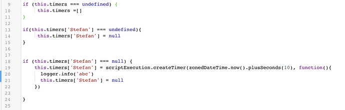

HI Rich,

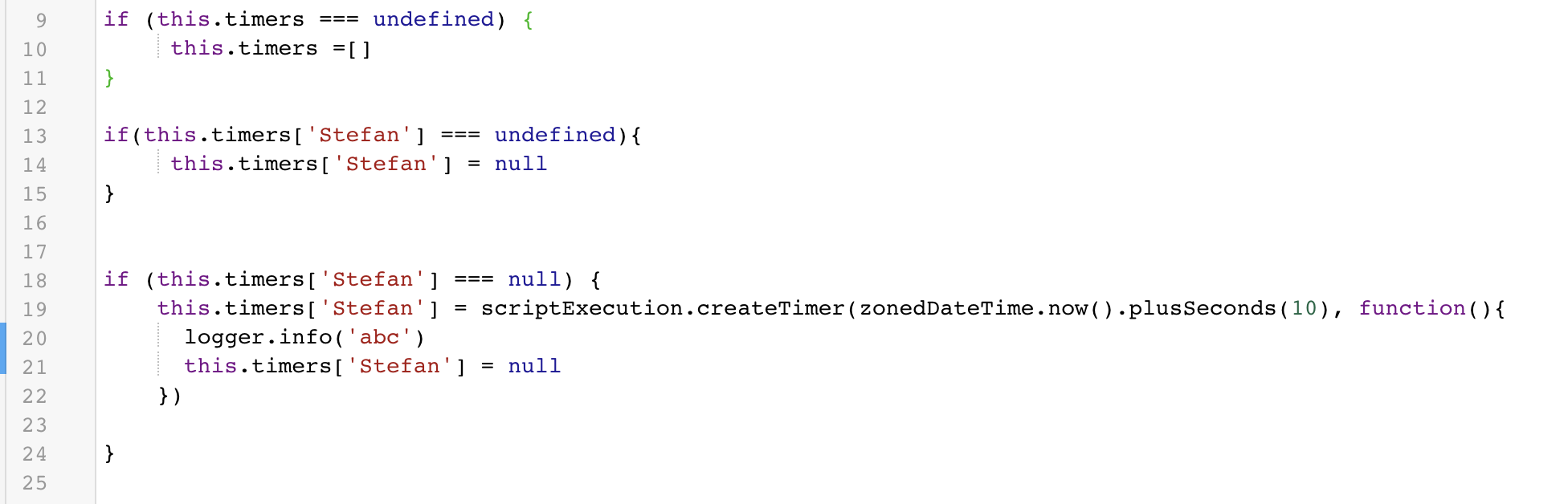

I finally found out why I didn’t use the variable’s content to produce the right code, so now I can do but unfortunately this introduces a new problem in code generation.

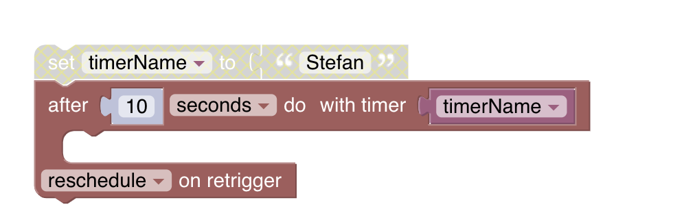

Let’s take example 1 where just use a String like before:
and it correctly produces what we expect - please take a particular note on the initialization part line13 to 15 in the beginning of the code as we will compare that in a moment.
well done … now let’s do the variable version:
which generates fine code - see lines 18 onwards: it assigns the string to the variable and then uses the variable as an indirection for accessing the timers. Very well …

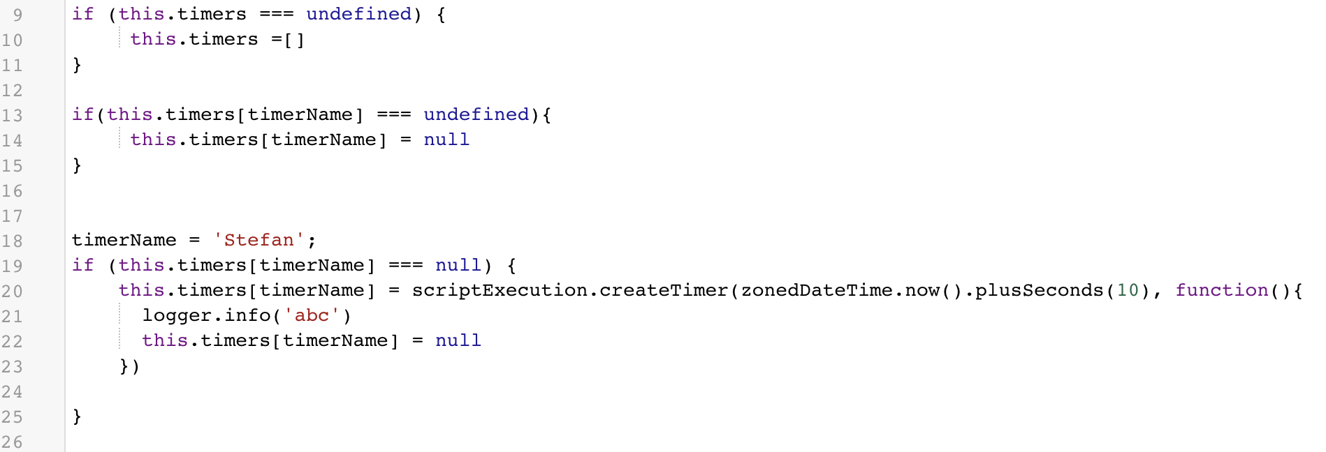

but wait! Have a lock on the initialization part line13 to 15
It also uses the variable indirection for rightfully initializing the timer to null if undefined but this is always done in the beginning of the source by a blockly technique that makes sure that the same code that is required by many blocks is produced only once and then put to the beginning.
Of course, this must fail, because the variable neither exists at that point nor is it set correctly.
So why do we need this code in the beginning? It makes the whole code later on much easier. Instead we could put all the check into the code everywhere we we access the timer-variable.
So the only way I could think of is that we remove this part but then we have to make sure that everywhere where we use the timer[…]-field we first have to check if is not only not undefined or nor null.

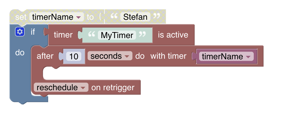

So for the following that could fail if timerName wasn’t existing
// timerName = 'Stefan';
if (this.timers[timerName] && this.timers['timerName].isActive()) {
we had to generate this boilerplate code even for the simplest part of the code
if (timerName!== undefined && !timerName && this.timers[timerName] && this.timers[timerName].isActive()) {

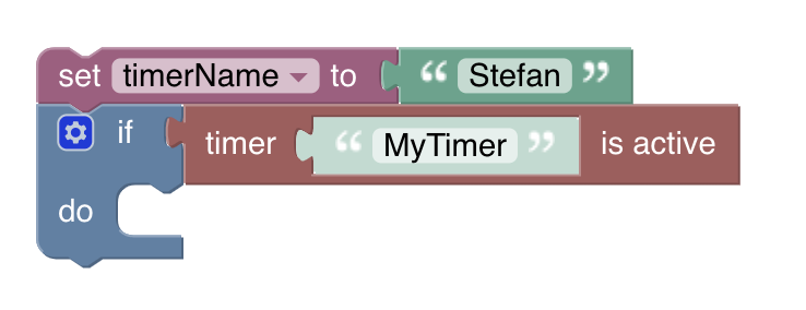

Now imagine you had this code
if (this.timers[timerName] === null) {
	this.timers[timerName] = scriptExecution.createTimer(zonedDateTime.now().plusSeconds(10), function(){
		  this.timers[timerName] = null
}else {
	this.timers[timerName].reschedule(zonedDateTime.now().plusSeconds(10))
which would result into
if (timerName!==undefined && !timerName && this.timers[timerName] === null) {
}else if (timerName!== undefined && !timerName)  {
… and even after thinking quite some time I am not sure if this is completely correct … and now if we had this?

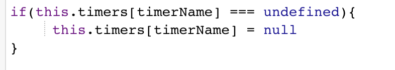

Is there no way to make the definition of the variable always occur above the if that checks to see if the timer exists?
Maybe we can/should step back and use undefined instead of null. In that case we would elimnate the initialization to null at the top entirely.
Instead of
if(this.timers[timerName] === null)
we would have
if(this.timers[timerName] === undefined)
Instead of
we would have
this.timers[timerName] = undefined
Looking at this code I think that just might work. We’ve replaced the use of null to determine whether the timer exists or not with undefined which is actually perfectly reasonable. However, I’m not 100% positive that we can set a variable to undefined like that or not.
It’s worth a try. This could not only address this problem but make the code over all simpler.
We still absolutely need the initialization of timers[] though. But I’m thinking we don’t for the individual timers themselves. We won’t get undefined errors like we would if the timers were just variables instead of being managed in a dict.

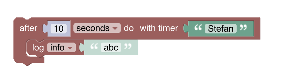

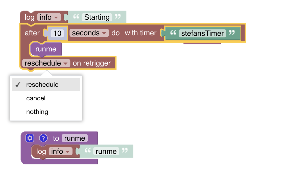

“Simple Timer”
new:
  • Simple timers provide reschedule, cancel and none-functionality on rule retriggering
  • As requested by Yannick even simple timers are named timers
  • Timer name can be provided via blockly variable
var logger = Java.type('org.slf4j.LoggerFactory').getLogger('org.openhab.rule.' + ctx.ruleUID)
var scriptExecution = Java.type("org.openhab.core.model.script.actions.ScriptExecution")
var zonedDateTime = Java.type("java.time.ZonedDateTime")
if (typeof this.timers === 'undefined') {
	 this.timers =[]
function runme() {
  logger.info('runme')
logger.info('Starting')
if (typeof this.timers['stefansTimer'] === 'undefined') {
	this.timers['stefansTimer'] = scriptExecution.createTimer(zonedDateTime.now().plusSeconds(10), function(){
	  runme();
	  this.timers['stefansTimer'] = undefined
}else {
	this.timers['stefansTimer'].reschedule(zonedDateTime.now().plusSeconds(10))

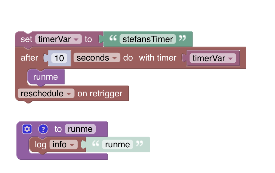

Simple timer with variable
var timerVar;
	 this.timers =[]
function runme() {
timerVar = 'stefansTimer';
if (typeof this.timers[timerVar] === 'undefined') {
	this.timers[timerVar] = scriptExecution.createTimer(zonedDateTime.now().plusSeconds(10), function(){
	  runme();
	  this.timers[timerVar] = undefined
}else {
	this.timers[timerVar].reschedule(zonedDateTime.now().plusSeconds(10))

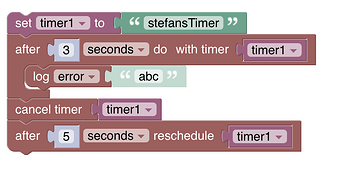

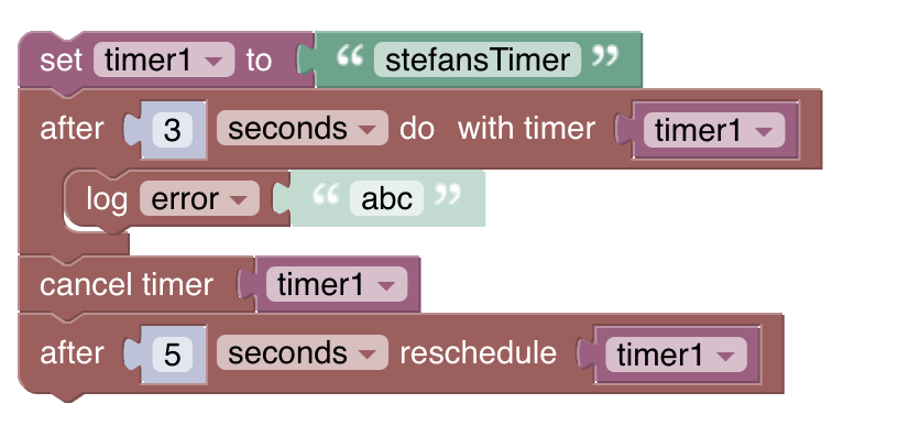

(note that the following example doesn’t really make sense as the cancel timer prevents the code from doing anything which is intended as I wanted to use as many blocks as possible in one go)
var timer1;
	 this.timers =[]
timer1 = 'stefansTimer';
if (typeof this.timers[timer1] === 'undefined') {
	this.timers[timer1] = scriptExecution.createTimer(zonedDateTime.now().plusSeconds(3), function() {
	  logger.error('abc')
	  this.timers[timer1] = undefined
if (typeof this.timers[timer1] !== 'undefined') {
	this.timers[timer1].cancel()
if (typeof this.timers[timer1] !== 'undefined') { this.timers[timer1].reschedule(zonedDateTime.now().plusSeconds(5)) }
of course of checks work as well and produce the following code (which again makes no sense in the way it is used here - it is only here to show the produced code)
var timer1;
	 this.timers =[]
if ((typeof this.timers[timer1] !== 'undefined' && this.timers[timer1].isActive())
&& (typeof this.timers[timer1] !== 'undefined' && this.timers[timer1].isRunning())
&& (typeof this.timers[timer1] !== 'undefined' && this.timers[timer1].hasTerminated())) {
  logger.error('abc')

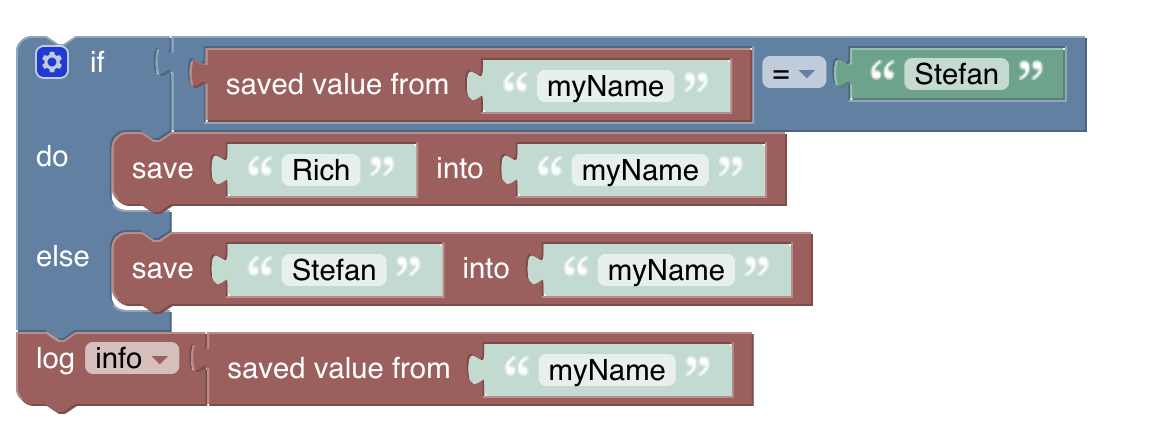

@ysc As I know you like looking at how the blocks present themselves and what the naming is like -please respond if you like it to be changed (e.g. we could use store instead of save). These are the last things I will do before I do the finally push to the git repo for your final review.
Here is the blockly representation
and this is the code that is generated (it uses its own Set named globalvars to keep track of the variables)
The first time the rule is triggered it says “Stefan”, the next time it says “Rich” which proves the rule remembers the content of that variable
if (typeof this.globalvars === 'undefined') {
	 this.globalvars =[]
if ((this.globalvars['myName']) == 'Stefan') {
  this.globalvars['myName'] = 'Rich'
} else {
  this.globalvars['myName'] = 'Stefan'
logger.info((this.globalvars['myName']))

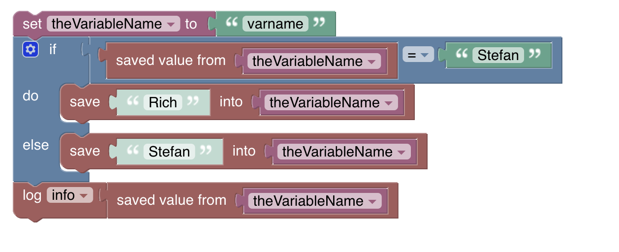

This following one is a pretty confusing one: It actually uses a Blockly Variable as an indirection that contains the variable name (hence the named slot) into which the value should be stored. I would rather say that this a seldom situation where you would use something like that and usually I wouldn’t recommend doing that but it shows that even this is working and I am sure it will trigger your creativity to do something weird with it :wink:
var theVariableName;
	 this.globalvars =[]
theVariableName = 'varname';
if ((this.globalvars[theVariableName]) == 'Stefan') {
  this.globalvars[theVariableName] = 'Rich'
} else {
  this.globalvars[theVariableName] = 'Stefan'
logger.info((this.globalvars[theVariableName]))

The blocks and the code look good to me. I’m glad we can get fully functional timer support in Blockly. It will be really important to making Blockly viable for more users.
I mostly use this for Timers but I think it too is important for other variable types so I’m glad you implemented it too.
That might be a bit of a pain though because You’ll have to create an Item(s) to store the values. I think this is sufficient for most use cases. And for the more advanced use cases where the data needs to survive a restart, the users should have access to Persistence to do the saving themselves, or Item metadata might be a viable alternative approach.
Calling this globalvars is probably a misnomer. These are not global in any way, really. Maybe “savedvars” would be better. It more accurately depicts what is really happening and it isn’t confused with Persistence in any way.
In Rules DSL we called them global because the only way to save a variable from one run to the next in a rule was to put the variable outside of the rule. That’s not an option here. There is no outside the rule.
Nope. There is an issue opened to address how that might work and there was even a poll and an approach decided upon. But since then there has been no activity. The approach is to use the ScripExtensions as a central repository for shared variables. But there really isn’t a good way to achieve that from rules. There is one example of doing it in GraalVM in @jpg0’s helper library but I’ve not been able to figure out how to use it in practice.
Glad that it works out for you so far.
I renamed the variable to “storedvars” as I also changed the block into “store … into” as proposed by Yannick.
I also added the semicolons.
@ysc I am going to push this soon. (Please do me a favour and squash the commits as I wasn’t able to do it myself … it says “multiple parents…” and take care of the missing sign-off, thanks)
Sending the notification was finally very easy. I only had to load the right java class which works perfectly well (provided of course that the OH cloud has been configured). So the code is then
var NotificationAction = Java.type("org.openhab.io.openhabcloud.NotificationAction");
NotificationAction.sendNotification('me@you.de','Hello');
NotificationAction.sendBroadcastNotification('Hi all','battery','high');
NotificationAction.sendLogNotification('Hi Log','attic','warn');
