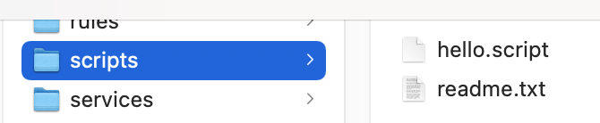

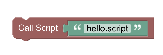

Next feature is working :smiley: as defined in Actions Subsystem
with the script in the script folder
being
logInfo(“helloScript”,“hello script”)
resulting into
2021-11-16 22:55:09.976 [INFO ] [penhab.core.model.script.helloScript] - hello script
Question: would there be any way to call a script as defined in the UI? Probably not
Calling “helloWorld” doesn’t find it as it really seems to look for a file.

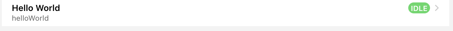

Yes but it’s just a regular rule so it would be like I posted up in post 103.
A “Script” in the UI is just a rule with a single script action tagged with “Script”. It’s actually a little confusing in that regard which, now that you’ve implemented it I wonder if this is going to cause some confusion.
Honestly the overloaded “Script” term is already causing confusion among users. Maybe if we change this action to “call script file” that might help. It makes it a bit more clear that we are calling a .script file, not a rule under the Script category in the UI.
As you found in your experiments, they are really two very different things.

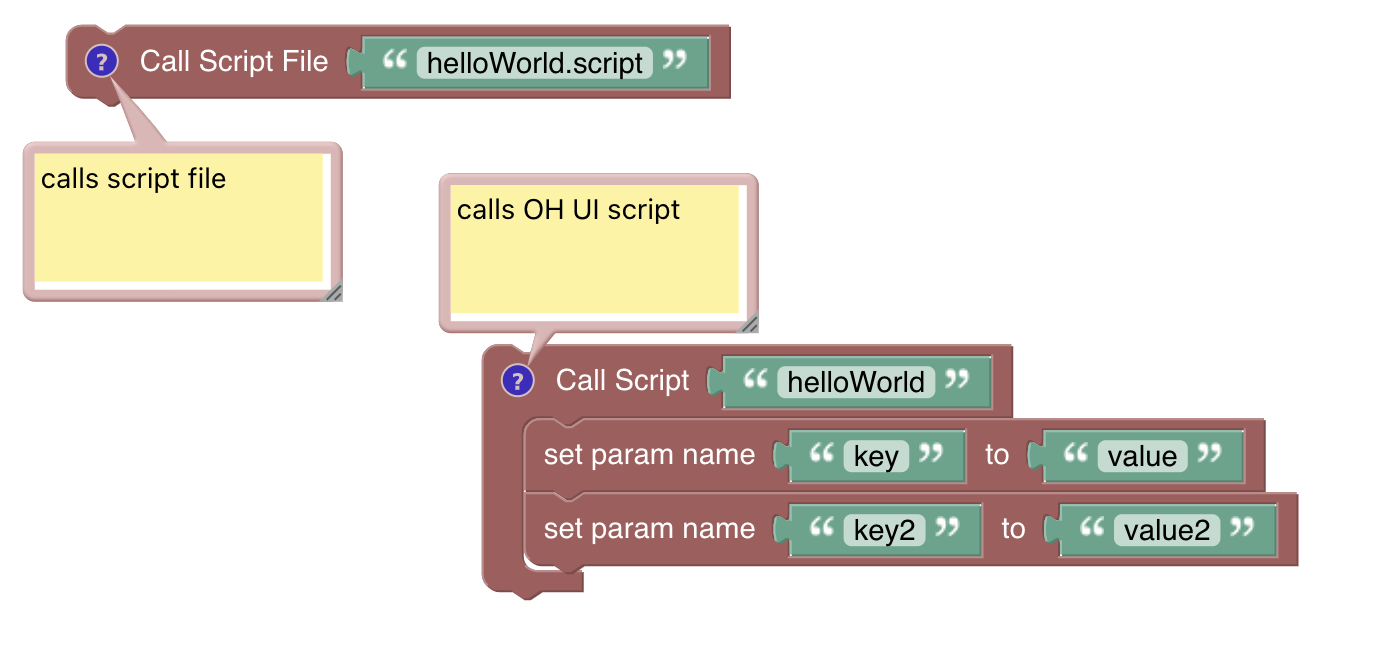

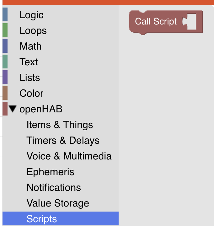

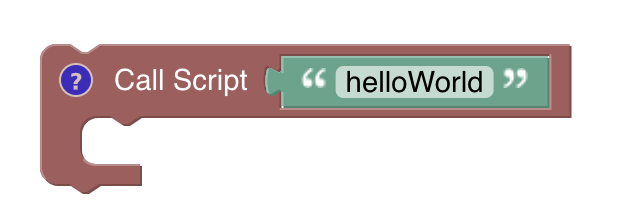

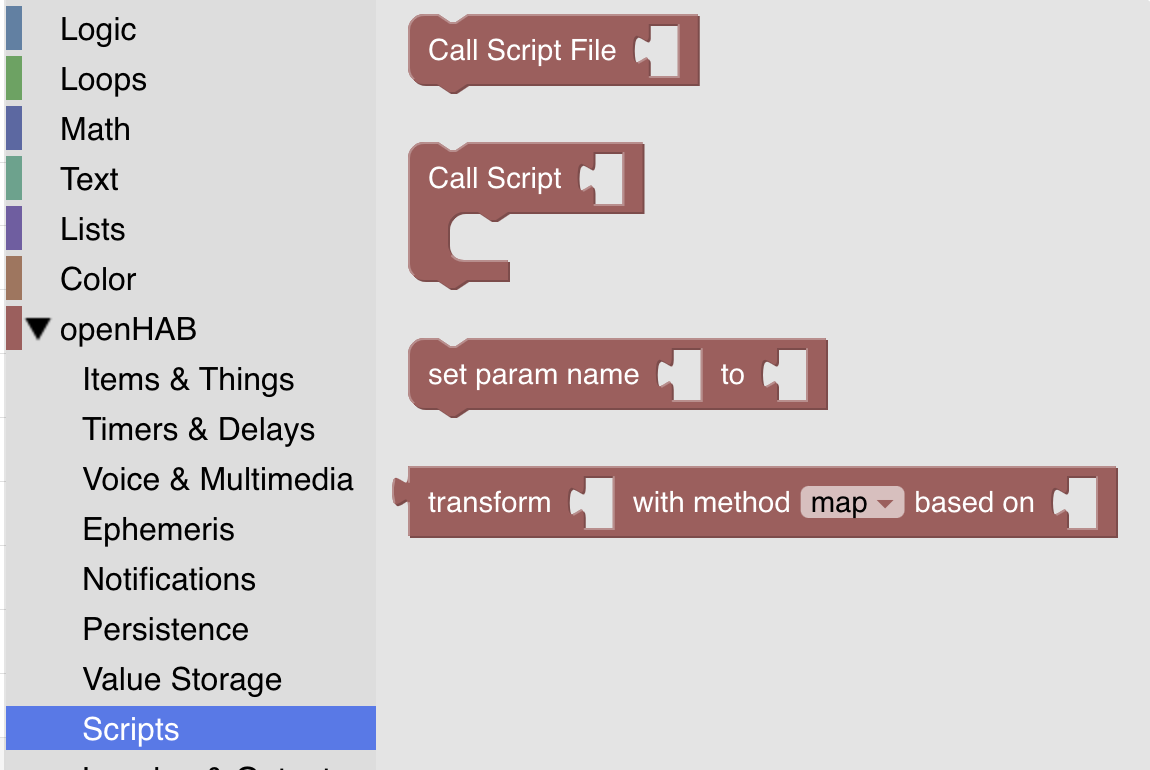

I renamed the original block to “Call Script File”
Another good news. Even though I was worried about the complex code I got it working pretty fast (thanks to your perfect example) and I also support variables already.
This is how the blocks look like:
This is the code I create for Call-Script Block
var FrameworkUtil = Java.type('org.osgi.framework.FrameworkUtil');
var _bundle = FrameworkUtil.getBundle(scriptExtension.class);
var bundle_context = _bundle.getBundleContext()
var ruleManager_Ref = bundle_context.getServiceReference('org.openhab.core.automation.RuleManager');
var ruleManager = bundle_context.getService(ruleManager_Ref);
var map = new java.util.HashMap();
  map.clear();
  map.put('key','value');
  map.put('key2','value2');
ruleManager.runNow('helloWorld', true, map);
and the script name “helloWorld” is actually called. The code of the script looks like
logger.info('helloWorld was called')
logger.info('Param='+context.getAttribute('key'))
logger.info('Param='+context.getAttribute('key2'))
And it logs out
[INFO ] [org.openhab.rule.helloWorld         ] - helloWorld was called
[INFO ] [org.openhab.rule.helloWorld         ] - Param=value
[INFO ] [org.openhab.rule.helloWorld         ] - Param=value2
So this is a really cool block now.

@ysc
Do you have an preference on the “empty” statement block? I would actually just provide one with and one without params or do you know an easy way? The only way I could think of would be a mutator but then we would have to provide a drop down that would select type like “with params / without params” which also isn’t so nice.
Type Checking on the inner block
I wanted to make sure that only my paramBlocks can be put into the “statementSection” (though this can be questioned actually - see below).
So I did
  Blockly.Blocks['oh_callscript'] = {
    init: function () {
      this.appendValueInput('scriptname')
        .setCheck('String')
        .appendField('Call Script')
      this.appendStatementInput("parameters")
        .setCheck('ScriptParam');
      this.setInputsInline(true)
and in the param-block I did
  Blockly.Blocks['oh_scriptparam'] = {
    init: function () {
      this.appendValueInput('paramName')
      .appendField('set param name')
      this.appendValueInput('value')
        .appendField('to')
        .setAlign(Blockly.ALIGN_RIGHT)
        .setCheck('String')
      this.setOutput(true, 'ScriptParam')
However, it seems the
this.setOutput(true, ‘ScriptParam’)
isn’t allowed here because blockly throws an error say
Remove output connection prior to adding previous connection.:undefined
Here is blocklies code
Blockly.Block.prototype.setOutput = function(newBoolean, opt_check) {
  if (newBoolean) {
    if (opt_check === undefined) {
      opt_check = null;
    if (!this.outputConnection) {
      if (this.previousConnection) {
        throw Error('Remove previous connection prior to adding output ' +
            'connection.');
      this.outputConnection = this.makeConnection_(Blockly.OUTPUT_VALUE);
    this.outputConnection.setCheck(opt_check);
  } else {
    if (this.outputConnection) {
      if (this.outputConnection.isConnected()) {
        throw Error('Must disconnect output value before removing connection.');
      this.outputConnection.dispose();
      this.outputConnection = null;
Does that tell you anything? I didn’t find anything nor does I understand the blockly code here.

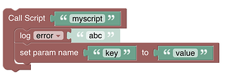

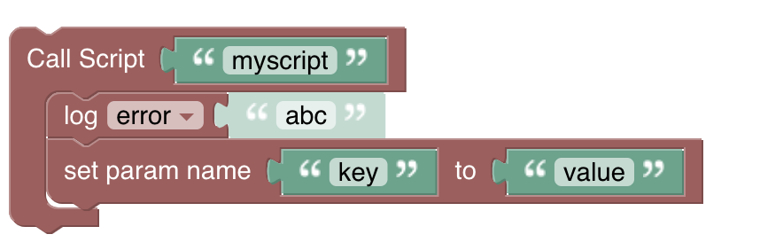

btw, the
this.appendStatementInput(“parameters”)
.setCheck(‘ScriptParam’);
doesn’t prevent any other statement to be added which is weird.
However, I don’t think it is too bad. It would “even” allow to put any statement into the script call block before actually calling the block. It doesn’t therefore really hurt, I think:
results into
map.clear();
logger.error('abc');
ruleManager.runNow('myscript', true, map);
So, probably we shouldn’t worry to much about restricting it to only the param block, should we?

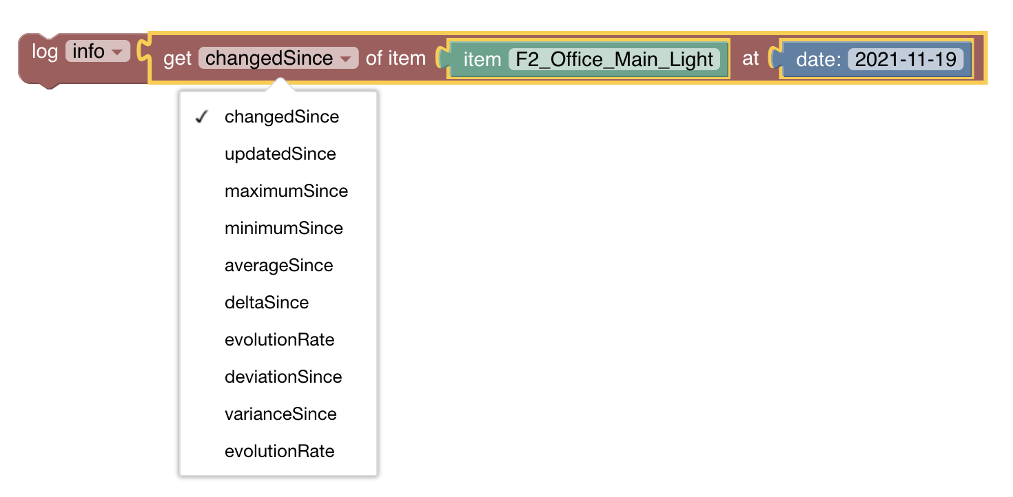

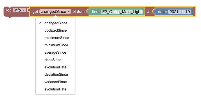

Persistence
I will work on the persistence blocks after the transform. Should we use a dropdown for the different methods using ZonedTimeDate?
like so?
Note that the first two would result into a different return type (Boolean?) like the others (Value), so it might make sense to split these?
It actually becomes pretty interesting
| Attribute     | Value
| changedSince  | true/false
| updatedSince  | true/false
| maximumSince  | org.openhab.core.persistence.extensions.PersistenceExtensions$1@accc66
| minimumSince  | 19/11/2021, 01:00: F2_Office_Main_Light -> OFF
| averageSince  | 0.5107299806325430
| deltaSince    | 1
| evolutionRate | null
| deviationSince| 0.4998657671823248
| varianceSince | 0.2498561628629385

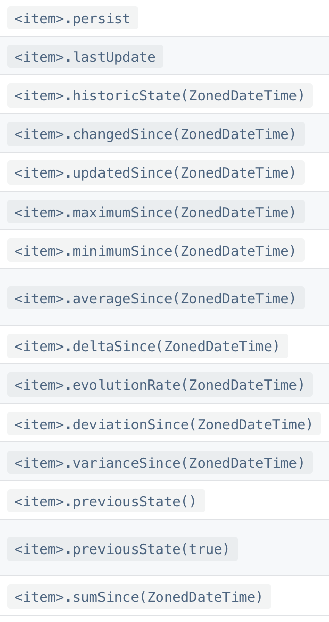

Looking at the code it reveals the minimumSince and maximumSince actually should a HistoricItem which itself has a timestamp, the currentState and the item’s name. It is strange that the maximum returns a reference and the minimum a string representation even though it is of the same type.
Checking the class-name MinimumSince return an RRD4jItem and MaximumSince returns the inner class PersistenceExtensions$1. So it seems these two are not really useful. I wonder how you use them in the UI? What would we use these two for anyway? Can we leave them out or do you have an idea?

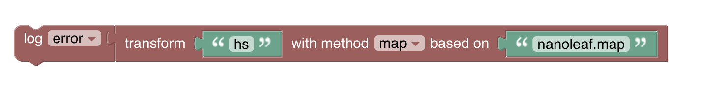

This works nicely already
generating

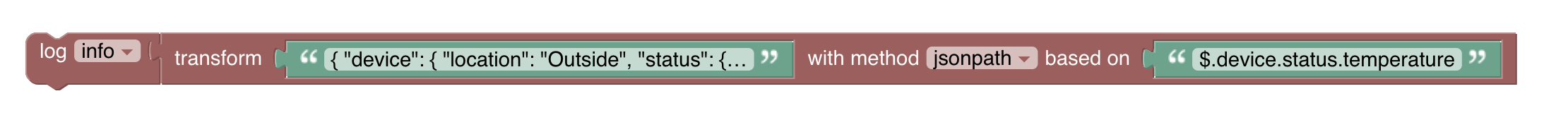

var Transformation = Java.type("org.openhab.core.transform.actions.Transformation");
var map = Transformation.transform("MAP", "nanoleaf.map", "hs");
and this
generating
var jsonpath2= Transformation.transform("JSONPATH", "$.device.status.temperature", '{ "device": { "location": "Outside", "status": { "temperature": 23.2 }}}');

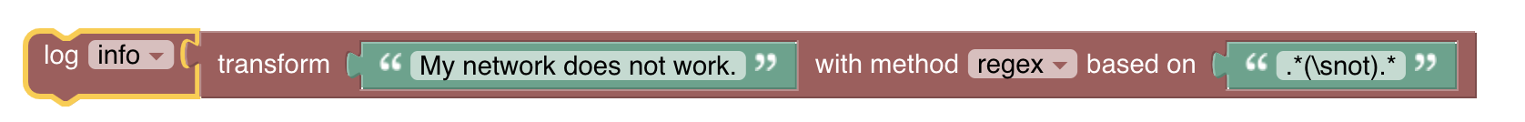

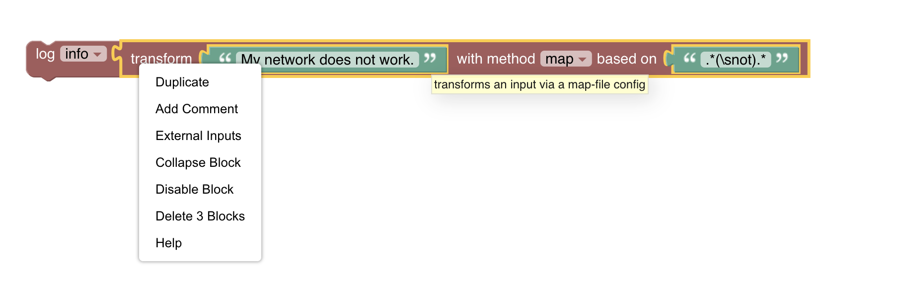

and this
resulting into
logger.info(transformation.transform('REGEX', '.*(\\snot).*', 'My network does not work.'));
note that the \ are doubled to make sure the are escaped.
Are you fine with that block idea?
This concludes the script section:
I can’t think of any better way to do it. It looks really good. I’m looking forward to this more complete Blockly implementation to go live. I think a lot of users will be very happy.

I was able to make the help url and the tooltip context sensitive to the choice of the dropdown:
so the tooltip tells you what to provide and context menu link jumps to the right help page of openHAB.

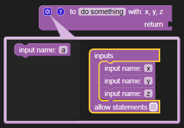

Maybe there is something to be done still, similar to functions, where you have the mutator to define what the parameters are:
and then you can call the block and the parameters you defined can be assigned values:
In the Functions’ case, these are two separate blocks but in the “call script” all would be handled within the same block.
The implementation is here: https://github.com/google/blockly/blob/master/blocks/procedures.js and it sure looks pretty complex… maybe start with one without parameters and see how to evolve it later?
To be honest I’m not too sure about the statements inside the call script blocks to set the parameters, because 1) you can add arbitrary statements inside this surrounding structure which makes little sense (as you mentioned) and 2) you can use the “set param name” blocks outside the call script blocks which makes little sense as well.

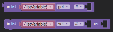

Actually, a cleaner and probably easier solution would be to offer blocks to manipulate generic key/value maps - similar to those for lists:
(just imagine “create empty key/value map”, “create map with…”, “in map {mapVariable} get key k”, “in map {mapVariable} set key k as v”, “in map {mapVariable} remove key k” instead of those above).
The implementations for the lists are in:
Then the user can build the map above the “call script” block and pass it as an (optional) argument. You could even initialize it on the fly: “[call script helloWorld with parameters [create map with x=1, y=2, …]]”. Of course you would have a check that the passed parameters is indeed a map.
IMHO it reflects better the flow of the actual generated code. Note that the Blockly maps could be simple JS objects and the call script block would be in charge of transforming it into a java.util.Hashmap on the fly (with for...in or Object.keys().forEach() or similar).
And it could make sense to manipulate key/value maps outside the call script scenario as well.
I know I’m asking a lot so that’s why I suggested to first have the call script block without params first (I didn’t even know you could pass params, which is admittedly a very cool and powerful feature with a lot of potential) then figure out a solution that works best for the params; it would be an addition so likely backward compatible.

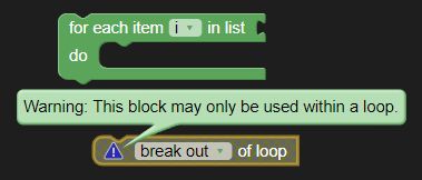

Side note - it is also possible apparently to disallow blocks outside a certain context, see:

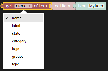

Yes that’s something that I also noticed with the “get {name/label/tags/groups} of item…” block. Depending on the choice made in the dropdown the output type is different! (array of strings in tags/groups cases, string otherwise).
The “easy” choice is to not define an output type at all, but it’s not ideal because then you expect the user to figure it out - which is unfortunate if we consider Blockly’s target audience to be novices or those less proficient in programming.
I wouldn’t mind having multiple similar blocks based on the output type: boolean, historical value, decimal number, date (of last update)… but it’s not ideal either as it wasn’t done in the Items case.
The ideal solution IMO would be to update the output type of the block based on the choice in the dropdown. I’m sure there are examples of blocks in the standard Blockly code that does that, though I can’t find any right now. If you can update tooltips, you can almost certainly update output types as well.
I think the transformation part looks good at first sight - I’d still make the block “vertical” by default like those in the Voice & Multimedia category because I suspect the horizontal version would quickly become quite long. Remember the user can switch between the two with the context menu (“External Inputs”), I’m just talking about the default.

Could I ask you however to submit PRs to GitHub as soon as possible, even with non-working code, and ideally not submit a monster PR with several features - the larger the PRs, the longer it’ll take to review them.
Based on your “executeCommandLine” discussion with Rich I would refrain from providing it as a block because I feel it would be to easy to cause bad things with easy to use blocks.
Thanks, yes, that was actually one of the question I wanted to ask how we should proceed because I noticed that the comments in github became pretty comprehensive. So if I understand you right I would probably do one PR for each category? Though I would want to discuss these first here and then do the PR for that one category.
Thanks for all the input. I am kind of thinking about what is more important: Getting things done or dive even deeper into the complexity of blocks. Mutators are actually pretty complex to be implemented (at least yet I haven’t understood them) so I am not sure I wanted to head there. Changing the URL and Tooltips was “rather” easy because I was lucky to find out the setTooltip() actually takes a function that can dynamically return something (similar URL).
Great that you pointed out that functions can take parameters. I DID NOT know this :upside_down_face:
@rlkoshak I was obviously wrong about that in my statement somewhere above.
Maybe I’ll check the function implementation (even though I am sure it uses mutators). It definitely looks like a nice solution.
And yes, I’ll have a look at the list idea as well.
All in all good ideas, let me see how much time I find because I like to have ephemeris, scripts and persistence done by end of this year :christmas_tree:
It never hurts to see even WIP code as we discuss the feature. And yes I believe making PRs as small & focused as possible helps (when there are no dependencies between them), if you wait for feature A, B & C to be ready before submitting the PR, and features A & C are okay to merge but there are still concerns with B, then you hold off A & C from becoming available sooner.
The main issue I saw in the the were the many commits I wasn’t able to merge and rebase (did I already mention I hate git :rofl: ) and the many comments there and yes, therefore I tried to keep them smaller.
As I suspected there are already discussions and partial implementations of dictionaries (key/value maps) in Blockly that we could maybe reuse or take inspiration from:
dict_get and dict_create_with blocks for blockpy · GitHub (Python only implementation + needs a good cleanup + no license).
this defines a block to define a dictionary with an arbitrary number of keys.

With this all you need is an input with a check set to “Dictionary” and add the code to populate the Java HashMap from the dictionary (if it’s not null or empty, otherwise you could even omit it), something like the following:
var scriptParameters = <dictionary>;
Object.keys(scriptParameters).forEach(function (key) {
  map.put(key, scriptParameters[key]);
You could even pre-populate an empty dictionary as a shadow block.
Then you don’t need neither the statements input in the call script block, nor the “set param name” block.
Works nicely. almost done (didn’t have much time today). However, you need to concert scriptParameters which is a String into a Json-Object first.
One another topic: I just noticed a bug in the audio block which can be fixed by changing one line. Should I do a PR with that single line fix so it will go out quickly for those who use that block?
You have to replace <dictionary> above with something like Blockly.JavaScript.valueToCode("the name of your input") - it will be something like { 'key1': 0, 'key2': 'test', ...} which is already an object.
Also be aware when you generate code with common variable names, like var map = ... it could collide with user-defined variables easily.
Sure.
this is actually nicely explained in the Blockly docs:
  • use Blockly.JavaScript.variableDB_.getDistinctName to generate a variable name that will not collide
  • when providing utility functions you should use Blockly.JavaScript.FUNCTION_NAME_PLACEHOLDER and use the return value to get the actual function name to call the function. It could be different if Blockly detected a name collision.
