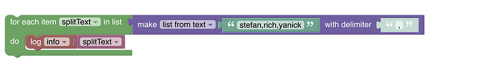

  1. String.splt doesn’t seem to be implemented as a block under Text. That would return a value that could be saved to a variable that could be processed by all the List operators. That’s a pretty useful way to write more generic rules and doing some very simple text parsing and processing.

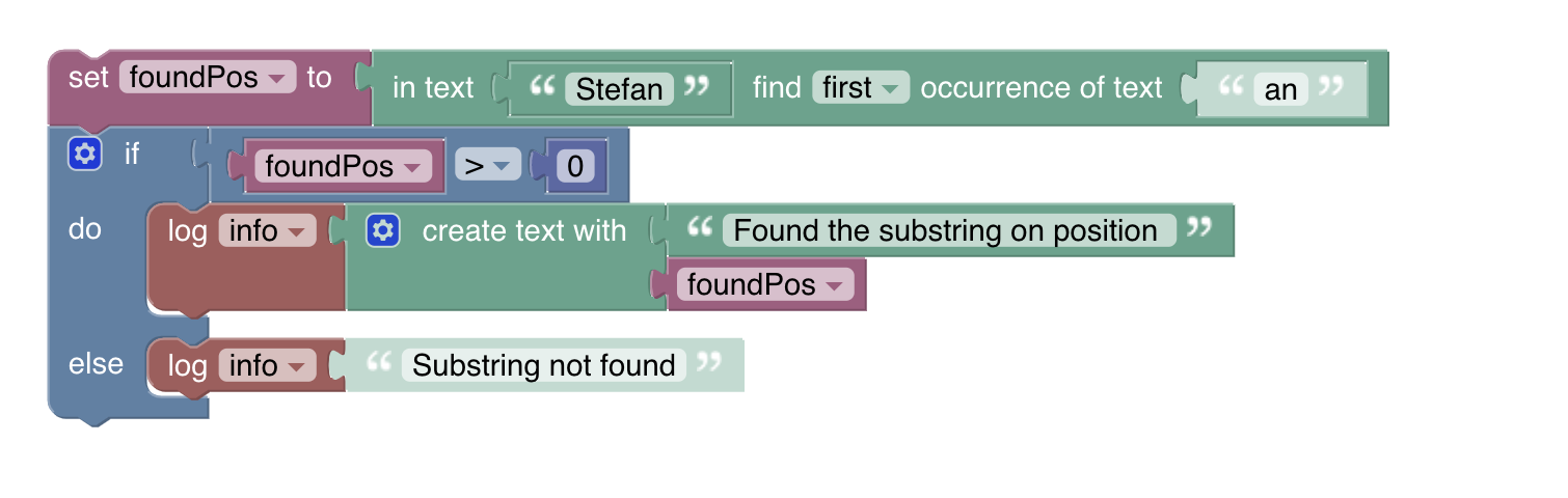

  2. String.contains is another very useful test to perform on a String. For example: if(mySring.contains("Foo")){. So the myString.contains would be a block that returns a boolean which can be plugged into a condition under Logic.

regarding those requiremnts I would have been surprised if it hadn’t been implemented. It is kind of not too obvious though

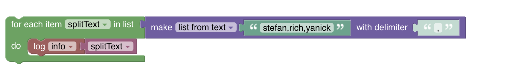

What about this here?
and this?
Does that suffice?
Doh! That’s the one. That definitely implements split. I just didn’t recognize it when I looked through all the blocks.
Again, I completely missed that what that block did.
It looks like both String operations are indeed already implemented. That’s good news! I just need to learn how to read the blocks more carefully I suppose. And to think about where the right place to look is.

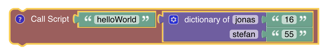

Finally something >I< can show you :fist_right: :fist_left: :upside_down_face:
This is the block I am creating
This is how I do it and it returns a string
let scriptParameters = Blockly.JavaScript.valueToCode(block, 'parameters', Blockly.JavaScript.ORDER_ATOMIC)
console.log(typeof(scriptParameters))
it reveals “string”
And therefore it out each character into the map, which is not what we want.
    const myMap = scriptParameters
    Object.keys(myMap).forEach(function (key) {
      code += `  callscript_map.put('${key}', ${myMap[key]})\n`
If we look into the string it turns out to be
{‘jonas’: ‘16’, ‘stefan’: ‘55’}
If I try to convert that string into a JSON Object with
const myMap = JSON.parse(scriptParameters)
or
const myMap = JSON.parse("{\'jonas\': \'16\', \'stefan\': \'55\'}")
I get
SyntaxError: Unexpected token ’ in JSON at position 1
However, if I converted the string by replacing the ’ with double quotes " like so
const workingMap = JSON.parse(‘{“jonas”: “16”, “stefan”: “55”}’)
then it works and I do not get this error. Like so
    const stringParametersMap = JSON.parse(scriptParameters.replace(/\'/g, '"'))
    Object.keys(stringParametersMap).forEach(function (key) {
      code += `  callscript_map.put('${key}', ${stringParametersMap[key]})\n`
Do you have an idea why I get a string back and not an object as you had expected and secondly why I have to replace the single quotes by double quotes to make the JSON.parse work?

I tried using the caching like you see in the “var paramMapName = …”
let scriptname = Blockly.JavaScript.valueToCode(block, 'scriptname', Blockly.JavaScript.ORDER_ATOMIC)
    var paramMapName = Blockly.JavaScript.provideFunction_(
      'scriptParamsMap',
      ['var ' + Blockly.JavaScript.FUNCTION_NAME_PLACEHOLDER_ + ' = new java.util.HashMap();'])
    let code = `  ${paramMapName}.clear();\n`
      code += `  ${paramMapName}.put('${key}', ${stringParametersMap[key]})\n`
    code += `ruleManager.runNow(${scriptname}, true, ${paramMapName});\n`
I would have hoped that in case I use the block twice that the return value from the second block code generation would return a new string but it is always the same and of course it makes sense because in other areas I exactly use it for the purpose it only insert that code ONCE intentionally. I read the linked several times but I just don’t understand how I can derive different variable names in case whenever I use a new block.

Here’s a correct (I hope, not tested at all) implementation of the oh_callscript block, hope it answers your questions:
  Blockly.JavaScript['oh_callscript'] = function (block) {
    const ruleManager = addOSGiService('ruleManager', 'org.openhab.core.automation.RuleManager')
    const parameterDict = Blockly.JavaScript.valueToCode(block, 'parameters', Blockly.JavaScript.ORDER_ATOMIC)
    const scriptName = Blockly.JavaScript.valueToCode(block, 'scriptname', Blockly.JavaScript.ORDER_ATOMIC)
    const convertDictionaryToHashMap = Blockly.JavaScript.provideFunction_(
      'convertDictionaryToHashMap',
        'function ' + Blockly.JavaScript.FUNCTION_NAME_PLACEHOLDER_ + ' (dict) {',
        '  if (!dict || dict.length === 0) return null;',
        '  var map = new java.util.HashMap();',
        '  Object.keys(dict).forEach(function (key) {',
        '    map.put(key, dict[key]);',
        '  return map;',
    return `${ruleManager}.runNow(${scriptName}, true, ${convertDictionaryToHashMap}(${parameterDict}));\n`
  function addOSGiService (serviceName, serviceClass) {
    const addServiceName = Blockly.JavaScript.provideFunction_(
      'addFrameworkService', [
        'function ' + Blockly.JavaScript.FUNCTION_NAME_PLACEHOLDER_ + ' (serviceClass) {',
        '  var bundleContext = Java.type(\'org.osgi.framework.FrameworkUtil\').getBundle(scriptExtension.class).getBundleContext();',
        '  var serviceReference = bundleContext.getServiceReference(serviceClass);',
        '  return bundleContext.getService(serviceReference);',
    return Blockly.JavaScript.provideFunction_(
      serviceName,
      [`var ${Blockly.JavaScript.FUNCTION_NAME_PLACEHOLDER_} = ${addServiceName}('${serviceClass}');`])
in particular:
  • if you ever have to define a temporary global variable for the block (not to be reused), then you must get an unique name with Blockly.JavaScript.variableDB_.getDistinctName:
const listVar = Blockly.JavaScript.variableDB_.getDistinctName(
    'temp_list', Blockly.Variables.NAME_TYPE);
let code = 'var ' + listVar + ' = ' + arg0 + ';\n';
  • if you use Blockly.JavaScript.provideFunction_ to provide a reusable function (or global variable) then you must use the return value to get the actual name, which may change if the user has defined a variable with the same name (note that it’s not done at all in the current code and that would have to be fixed):
const functionName = Blockly.JavaScript.provideFunction_(
    'list_lastElement',
    [ 'function ' + Blockly.JavaScript.FUNCTION_NAME_PLACEHOLDER_ + '(aList) {',
      '  // Return the last element of a list.',
      '  return aList[aList.length - 1];',
// Generate the function call for this block.
var code = functionName + '(' + arg0 + ')';
  • you misunderstood the example I gave you to convert to dictionary to a HashMap, it was not meant to put in the code generation routine, but part of the actual code to be generated. You rarely have to analyze the inputs themselves, valueToCode returns a string because that’s code that you have to insert in the final code somewhere.
NB, that addOSGiService function above could be exported from another file and imported because it’s likely that it will be used in other blocks.
