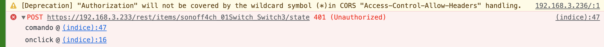

Just tried to switch from Safari to Chrome, I got a quite similar error message..
[Deprecation] "Authorization" will not be covered by the wildcard symbol (*)in CORS "Access-Control-Allow-Headers" handling.
POST https://OH3serverIP/rest/items/ItemsoControl/state 401 (Unauthorized)

Thank you JanK for suggesting this mod,
adding the path /rest into my Proxy conf file makes the CORS warning disappear.
However, I’m still getting the 401 Error - Unauthorized whet attempting to send commands (ON or OFF) to OH3 via Javascript

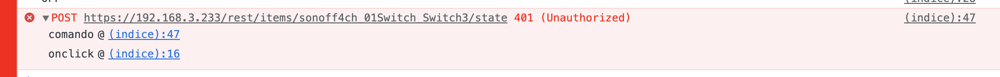

I’ve already tried to generate such API tokens and send them via the JS script: the error still remains:
Both of them generate the error here below:
Schermata 2022-01-07 alle 09.51.02
Maybe I don’t implement the xhr.setRequestHeader correctly?
