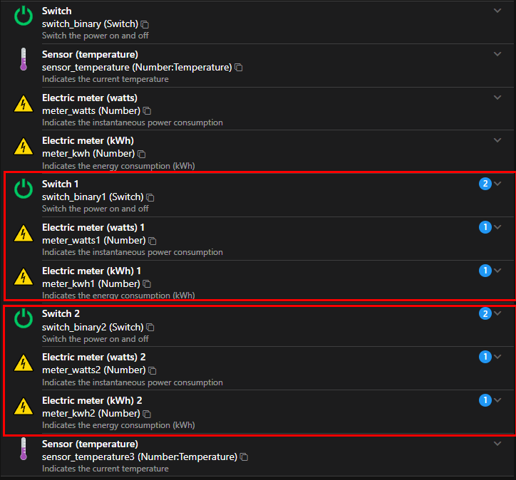

There’s a similar from Qubino (Flush 2D or something like this) which can also drive two circuits. The channels look like the following for each circuit:
OK that looks interesting. I have also so far failed in my attempts to connect physical switches to the Fibaros so that I can manually control them, which really is a basic requirement for situations like these. I might have another stab at that and see if the reset procedure involving the S1/S2 switches works. If not, I’ll look at the Qubino.
Alas, it seems the Qubino relays can only handle 4A each, not enough for a heat pump.
