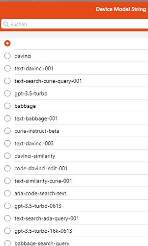

The binding has the option to use either cloud or local detection. Using cloud detection returns a weird set of allowed model strings…
Using “direct” sets the things’ status from NOT_READY_YET to HANDLER_MISSING_ERROR and then finally HANDLER_CONFIGURATION_PENDING.
This also happens to the thing I created via text file - it has the correct model string included, but the binding is expecting one of the nonsense-names from the screenshot.

The strange thing here is that the options in the screenshot are totally unrelated to the binding.
In fact the error it show (HANDLER_CONFIGURATION_PENDING): {model=Der Wert ijai.vacuum.v19 ist nicht in den erlaubten Optionen enthalten. Erlaubte Optionen sind: [ParameterOption [value="text-davinci-001", label="text-davinci-001"], ParameterOption [value="text-search-curie-query-001", label="text-search-curie-query-001"],t

I think there is a conflict between the chatGPT binding and the miio binding for the model config option.
It’s me who created the issue on github and posted in the ChatGPT thread. I can confirm the symptoms were the same for me as in this thread.
Something is in conflict with the ChatGPT binding. Don’t know if the problem is the GPT binding or the MIIO. But there’s issues between them, uninstalling ChatGPT and then going into every MIIO thing and saving the “Device Model” solves the issue.
There also seems to be a pending pull request for a fix to the ChatGPT binding.
The ChatGPT binding changed the allowed values for all configuration options called model indifferent of which binding it belonged to. Kai made a PR for the fix.
