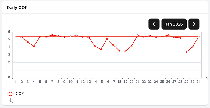

Since 1 March, I’ve noticed that none of my chart widgets of chartType: month and oh-aggregate-series will display the month of February. Clicking the left arrow in the date navigator jumps straight from March 2026 to January 2026. The line chart in all previous months displays incorrectly.
Going back to March 2025, clicking the left arrow in the date navigator shows March 2025 again, but with different data. Clicking the left arrow again in this duplicate March 2025 gives January 2025.
OpenHAB version is 5.1.3, with the persistence service set to InfluxDB.
Chart for January 2026:
Code for the chart:

Can anyone see what I am doing wrong here please? I haven’t changed anything in my charts and I didn’t notice this happening last year.

I wonder if it’s related to this issue: [MainUI] Charts data misalignment on oh-category-axis when using series offset #3866
While waiting for a fix to be available, you can select February by clicking on the month and using the calendar to pick a date in February.
I’ve created a PR to fix that: Charts: Fix add/subtract period doesn't account for different month lenghts by florian-h05 · Pull Request #3958 · openhab/openhab-webui · GitHub
