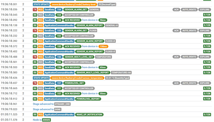

Node 2 is awake and the channels are updated:

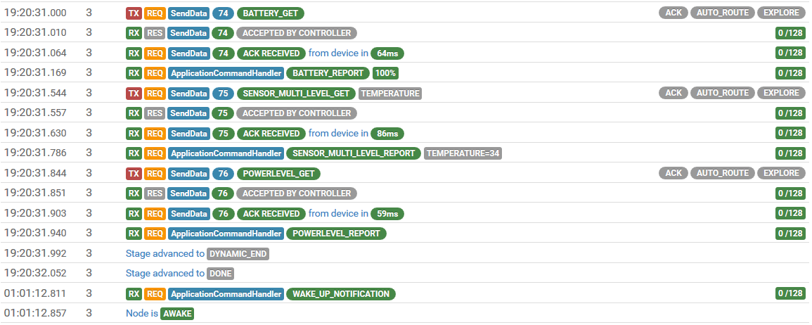

Same for node 3:

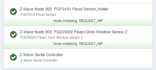

Request nif means initialization has not completed yet, you need to manually wake up your devices.

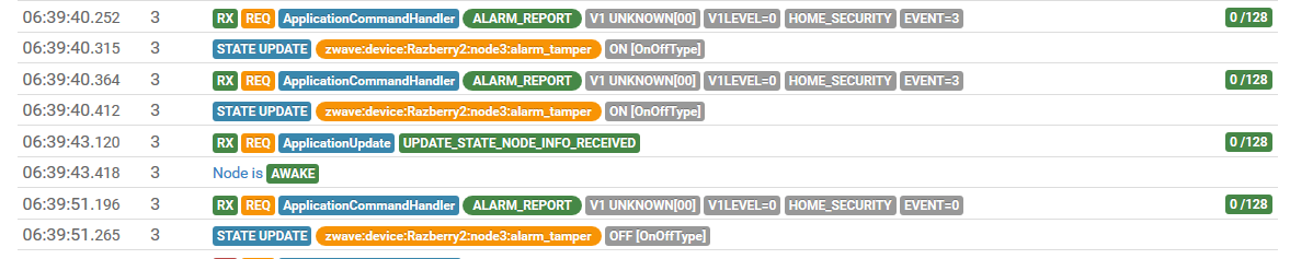

so Fibaro Flood Sensor ist working. Fibaro Door/Window Sensor 2 here i see the battery status and temperature. Temperature never change…strange, could not be.
Door open/close is not working. Nothing happen.
