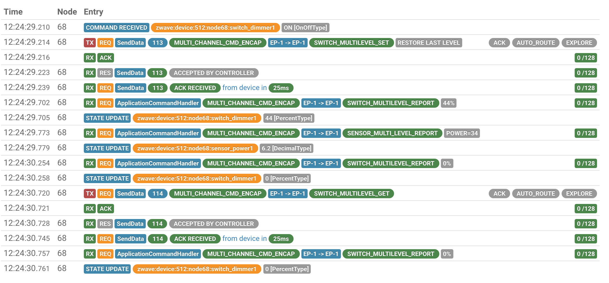

I have a Fibaro Dimmer FGD-212 configured as node 68 in my zWave network. When I turn it on via OH2 (site-map, HABmin or Paper UI) the light briefly turns on but then turns off again automatically. If I turn it on via the connected momentary-switch, it stays on and is reflected correctly in OH2. I have 30+ of these dimmers and this is the only one behaving in this way.

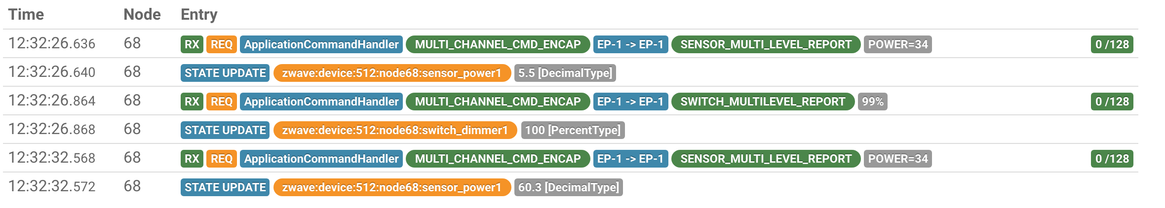

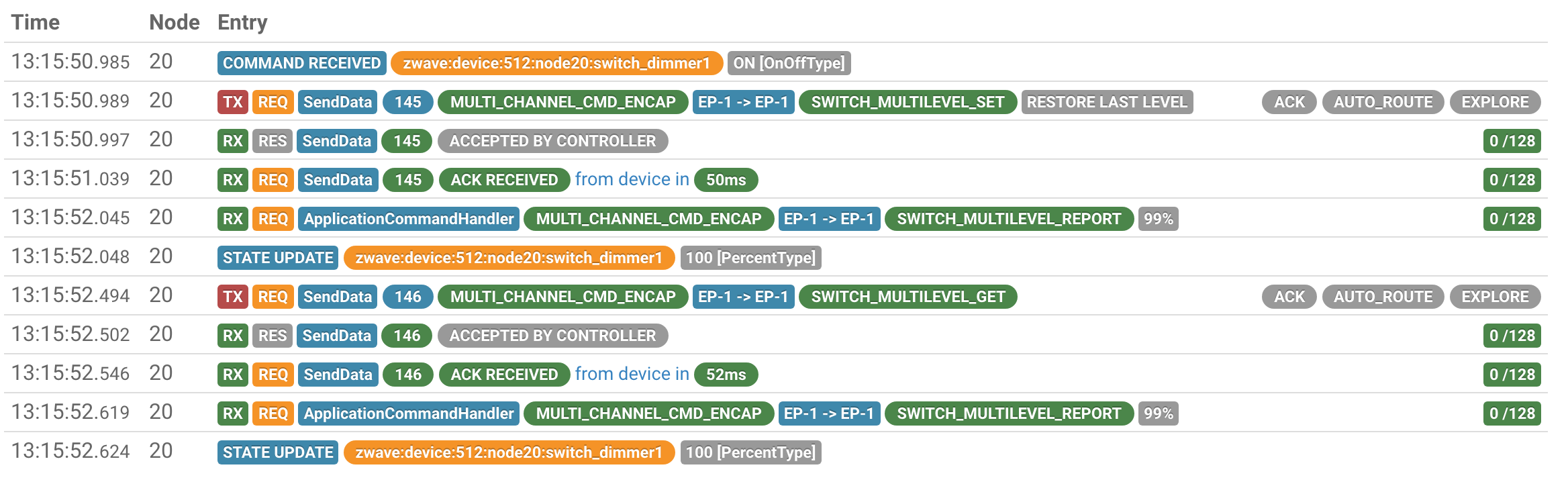

Working example from another Dimmer node
This log extract shows the behaviour of another working node in the network - and demonstrates expected output.
I’ve found Fibaro FGD-212 firmware v3.2 has a chronic random bug:
Send a Z-Wave command to turn a device ON
The device dimms up for turns on for 0.25 S, then dimms down to OFF itself.
No current overload events logged, no error events logged, the light just turns off.
