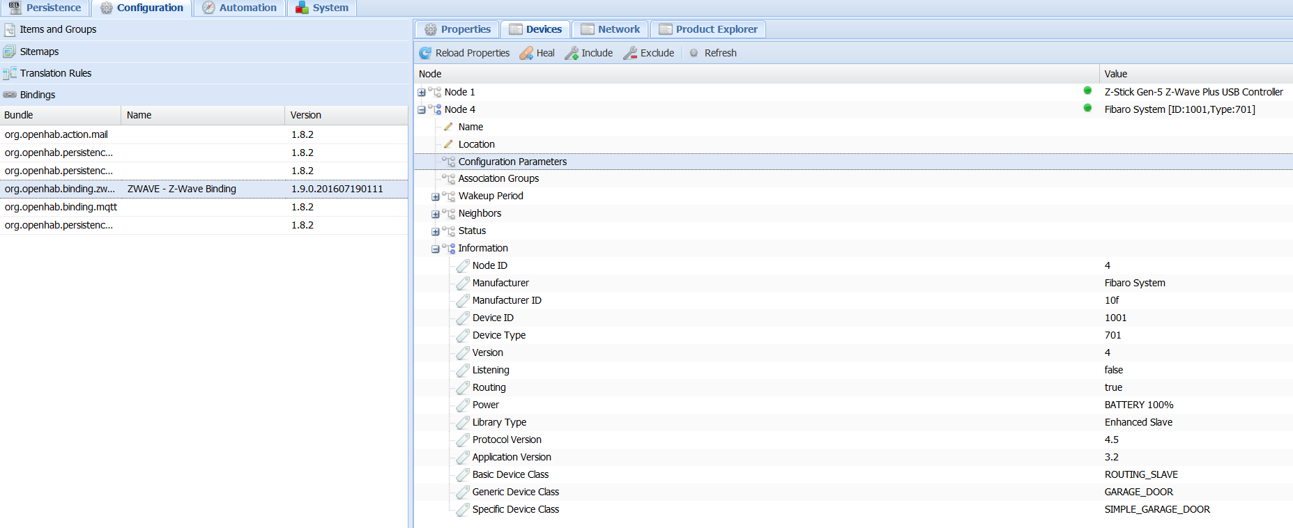

Thanks, I installed version 1.9.0 to my OH1 installation and now I can see the config params and association groups titles, but no information under them. Clicking refresh won’t help. When clicking ā€œrefreshā€ for association groups, I get this in the log:
[ERROR] [.z.i.config.ZWaveConfiguration] - NODE 4: Error in doAction - no database found
No other messages related to this.
Ok - maybe you have a different device. Please can you provide the device information from HABmin - ie what does HABmin show?
Heres a screenshot of the interface:
