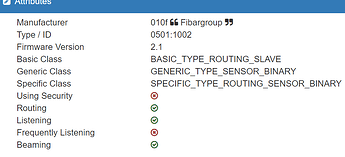

First time I’m working with the FGBS001 and probably doing something wrong - looking for a help.
I have FGBS001 IN1 hooked up to a PIR motion ssesnor. Can check that OUT1 reacts/changes according to input.
Have ZWave dev version from 20171024 as provided by Chris.
Added FGBS001 to Controller as Node21 through the HABmin, can see it correctly recognized. Created&linked items to the Binary1 and Alarm1.
Included both items in the HABPanel, but can not see any changes when activating the sensor.
Also nothing comes through the log - my expectation would be to see some message when sensor triggers.
Am I missing something in the config or my expectations about sensors behavior are wrong?
Linking full log w zwave DEBUG from moment of thing discovery zwave-node21.7z.
