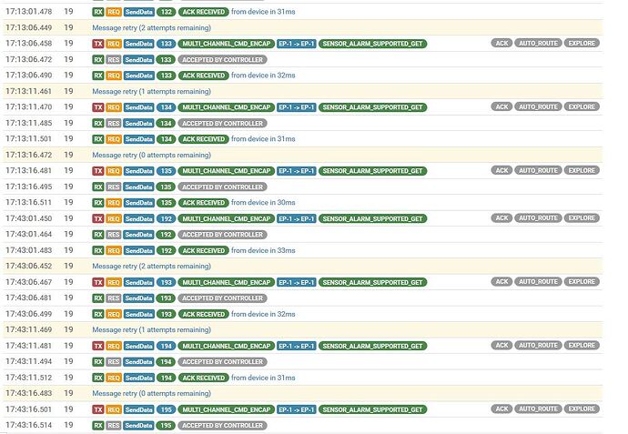

Please provide an unfiltered log. If you filter it to just this node, then we loose all the receive data messages which don’t have the node number listed as we don’t know this until much later…
From what I see though, the device probably doesn’t support the ALARM_SUPPORTED_GET message, so we can easily update the database to solve this if it’s the case.

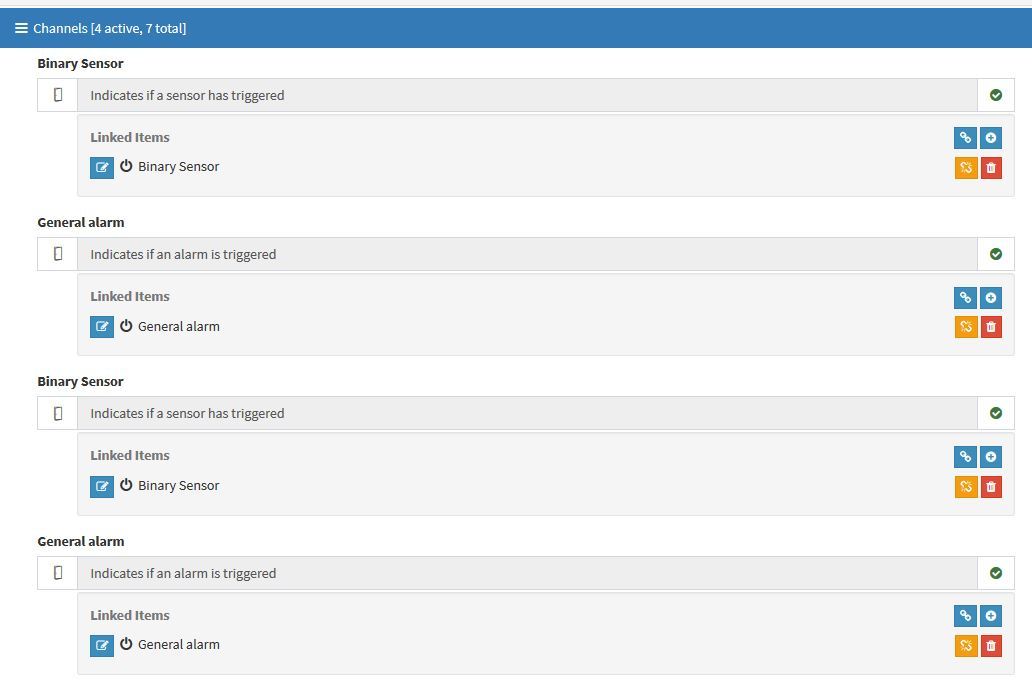

I linked items to all four channels (sensor_binary and sensor_alarm) and I can see they get added in the events.log, but if I physically trigger the input there is no command change.

added links to all four channels (sensor_binary, alarm_general)
→ did not work

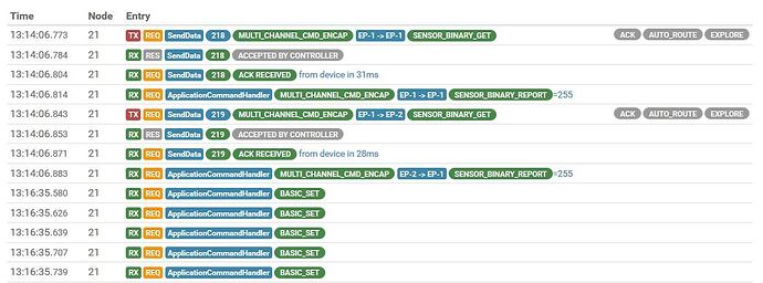

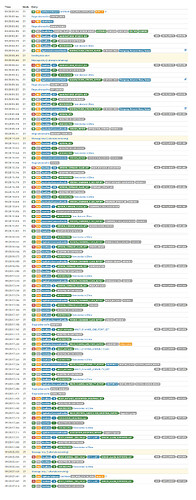

All was done with debug enabled, log can be found here (node21):
The alarms don’t seem to be encapsulated in multi-channel, and as there’s no channels in the root, they won’t do anything -:
I don’t know if this should be sending these alarms in multi-channel encap?
What do you think it’s meant to send? eg if you press a button (or whatever is linked to the input) what do you think should happen? Should alarms be sent to the endpoint, or the root device. I’m not sure if you’ve looked at the log yourself in the viewer, but a lot of stuff is sent to the root…

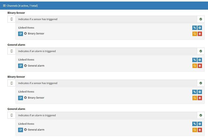

But in the event.log nothing shows up and on the sitemap the two switches (actually four) are always off.
The general alarm was only meant as a test if something is coming in on this channel.
Ok - so these two channels still look like they are being sent. sensor_binary channel is however defined as a switch (as you correctly assumed ).
Strange - the binding says it is sending the state to ON / OFF for these channels . HABmin seems to think the channels are linked to items - are you sure the items are switches (sorry - I’m sure you are, but just double checking as everything seems to be working with these channels - except for the ‘small’ point that they don’t seem to actually work!)
