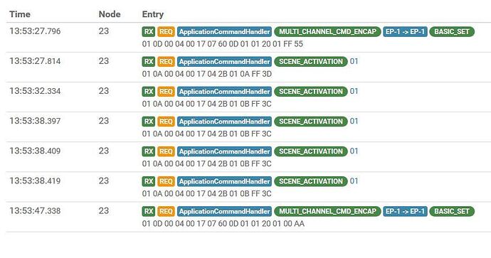

Strange - this is not using multi-channel encapsulation -:
There is no channel associated with the root endpoint…
That was part of the initialisation. During init the binding did request the two endpoints -:
During this initialisation it should have updated the channel - eg -:
2016-11-27 21:52:37.730 [DEBUG] [ding.zwave.handler.ZWaveThingHandler] - NODE 21: Updating channel state zwave:device:1587db82cfc:node21:sensor_binary2 to ON [OnOffType]
So, I don’t know how to solve this. If the device doesn’t send the two different inputs with some way to tell them apart (ie using multi-channel) then I don’t know how we can process it. Maybe there’s a setting, or maybe it requires the multi-channel-association to trigger multi-channel messages (some new devices do this, but I’ve not seen it in any Fibaro devices yet).

Btw, meanwhile I can see (in openHAB2) the switches on the sitemap changing their state according to the input, but still nothing in the event.log.
This simply means that none of the groups have the ‘controller’ box ticked. This means that the binding won’t automatically configure the device to send messages to the controller…
It looks like the missing link might be group 3… Do you want to add it?
Well, that’s strange. I very rarely look at the event log, but if the items are changing state (as seen in the sitemap) then I’ve no idea why the event log wouldn’t log the change. It’s outside of the binding though - the binding just sends channel updates - the framework updates the items…
I’ve just done that manually. Or is it better to upload a “fresh” xml file? Before we started changing the entries for this device it had not been touched for about six month.
Also the device is able to send scene numbers for the scene activation command class which isn’t reflected in the database yet.

Manual is fine - uploading a new XML won’t work - the database ignores XMLs once there’s a certain amount of configuration done to avoid someone loading the wrong file and making a mess ;).
Feel free to add the scene class(es) if you want?
Done.
Hopefully that’s not what I’m doing now with the manual changes :sunglasses:
Thanks - looks ok I think (from the quick look I had of the changes email). I’ll update the binding this evening.
Short story:
The device is working, thanks a lot for your support!!!
I have a warning in the logs
2016-12-10 08:04:08.920 [WARN ] [class.ZWaveMultiInstanceCommandClass] - NODE 23: CommandClass BASIC (0x20) not implemented by endpoint 1, fallback to main node.
2016-12-10 08:04:14.122 [WARN ] [class.ZWaveMultiInstanceCommandClass] - NODE 23: CommandClass BASIC (0x20) not implemented by endpoint 2, fallback to main node.
but actually I don’t care because it’s working without any problems :heart_eyes:

Glad it’s working…
Just to be clear, you’re running a recent version and have deleted and re-added the thing since we made the changes to the DB? This was one of the changes I made to the database so I wouldn’t have expected these errors…
If you can provide the debug log showing the frame received it might be useful as I don’t think this warning should be occurring.
openHAB2 version # 631, zwave binding 2.0.0.201612051634 and yes, deleted thing and re-added.
for EP1:
https://gist.github.com/sihui62/0ba04ac24348ba69707642915916a7db
Can you also post the XML. I’m guessing it’s probably the same as the previous ones, but since you said you changed to an older version I just want to check. The XMLs above show that the binding has the BASIC class in these endpoints, so I’d expect this to work :confused:
https://gist.github.com/sihui62/aaadb6ed517240066aaf2cba7480338a
Hmmm - thanks. For some reason then, this version of the XML doesn’t show the BASIC class in the endpoints. This explains why there’s an error, but why is it different to the previous versions of the XMLs you posted here ?!?!?
If you don’t mind, can you delete the XML and get a log of this device during startup (ie a complete log of the initialisation).
I’m handling this a bit different in the new version, so this won’t be a problem, but just interested to see what’s happening if you don’t mind. If you’re happy to leave this, then it should go away in future anyway…
Sure, no problem at all.
https://gist.github.com/sihui62/9c4f5b25211c3d867b5ba28608356fa8
