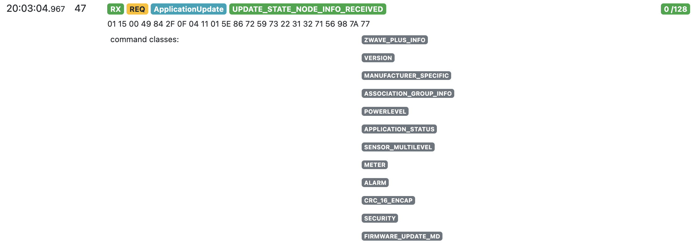

9
Sorry - I was away on holiday for a couple of weeks when you sent this and had no internet, and I missed this when I returned.
The issue is that the device reports that it doesn’t support multiple endpoints (or more accurately it doesn’t report the appropriate command classes in the NIF). Then when it comes to remove some classes that have been problematic in the past, this fails as endpoint 2 doesn’t exist.
I’m not sure why this would have changed - the device database hasn’t changed for 2 years! I can add a fix around this issue to prevent the exception, but probably there is another problem as this device should have 2 endpoints.
