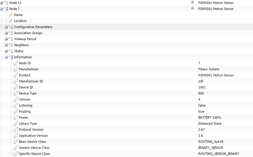

I have the same issue with the new versions of the FGMS001. I have two older ones that work perfectly but the new one I just cannot get feedback from binary sensor (PIR). The LUX, TEMP and BATERY info works fine only the PIR is not seems to be working. I only got the LUX, TEMP and Batery to work when I added NODE1 to the Device Status group. I did not have to do that with the older models.
Below Info of the New Sensor:
Below of the OLD Sensors:
I have tried the “hacked” zwave binding but did not seems to solve the issue. Let me know if I can help in providing logfiles and compare the two devices.

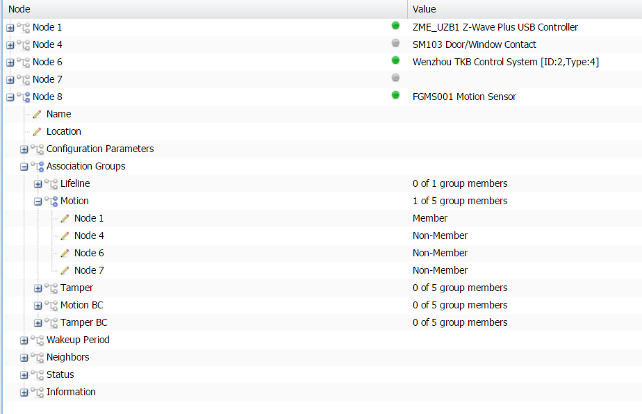

  1. BASIC command class configuration
    This parameter determines the command frames sent to 2nd association group (assigned to PIR sensor).
I don’t know whether I rushed it before or just wasn’t concentrating or whether the config was just not read correctly but I’d never spotted the multiple association groups before. I had linked association group 1 with node 1 and this meant that some info (but not all info) was passed to the controller.
Once I put node 1 into the Motion (DUR) association group, BASIC command class messages started to come through and they did have both ON and OFF. I am still seeing two ONs and two OFFs so will continue to investigate.
Hope I haven’t buggered up temperature now
Sorry to have wasted everyone’s time and hope this update helps someone following.
Yepp, it does. The older FGMS001 (mine is firmware version 2.6) have only three association groups …
