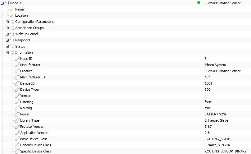

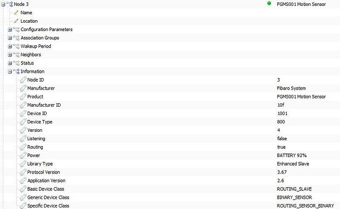

My FGMS001 is only associated to the controller in “Association Groups”>“Device Status” and “Controller updates”
Might help you.

Thanks - that is nearly the same setup as I am using. But I don’t know the relevance of “application version, protocol version”. And mine has the class “GARAGE_DOOR” or something like that, I do not remember right now. I guess I will try out re-adding in the association group 1 later on today, and see what happens. Thanks.
Are you using the same setup and version as @federic ?
Yes, except the application version (whatever that is …):
